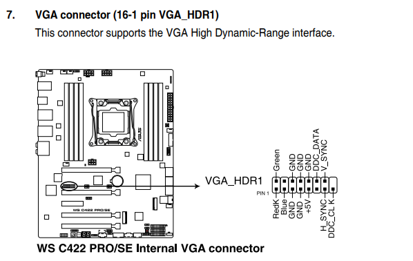

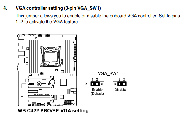

I did just notice as unraid was booting, right before it got to the final gui page...   it popped up  something related to --- unable to load nvidia --- something -- it happened very quickly so will have to restart computer to see what it was maybe get a photo capture of it.... (i had changed over to the stock unraid through the nvidia plugin --- so not sure what that was... )
Ya,  It is a bit hidden, but it has on-onboard VGA--  Not anything fancy mind you.... lol
image.png.fb53171755d67322ff0536ad3391d403.pngimage.png.c3323ff4ede1f2fb8e94f774bd79db49.png
