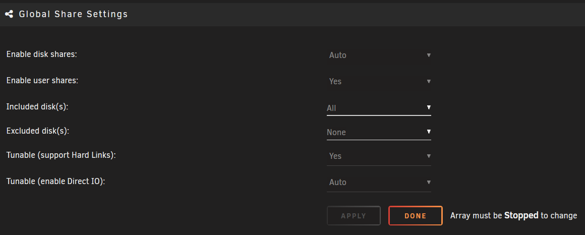

Do you have shares enabled?
See Settings -> Global Share Settings -> Enable User Shares
It is set to yes.
