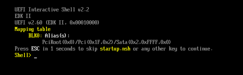

I tied in this way but the vm doesn't start
below the print screen:
Update the xml with the new location of the vdisk that you moved
I did it but nothing I still have the problem
