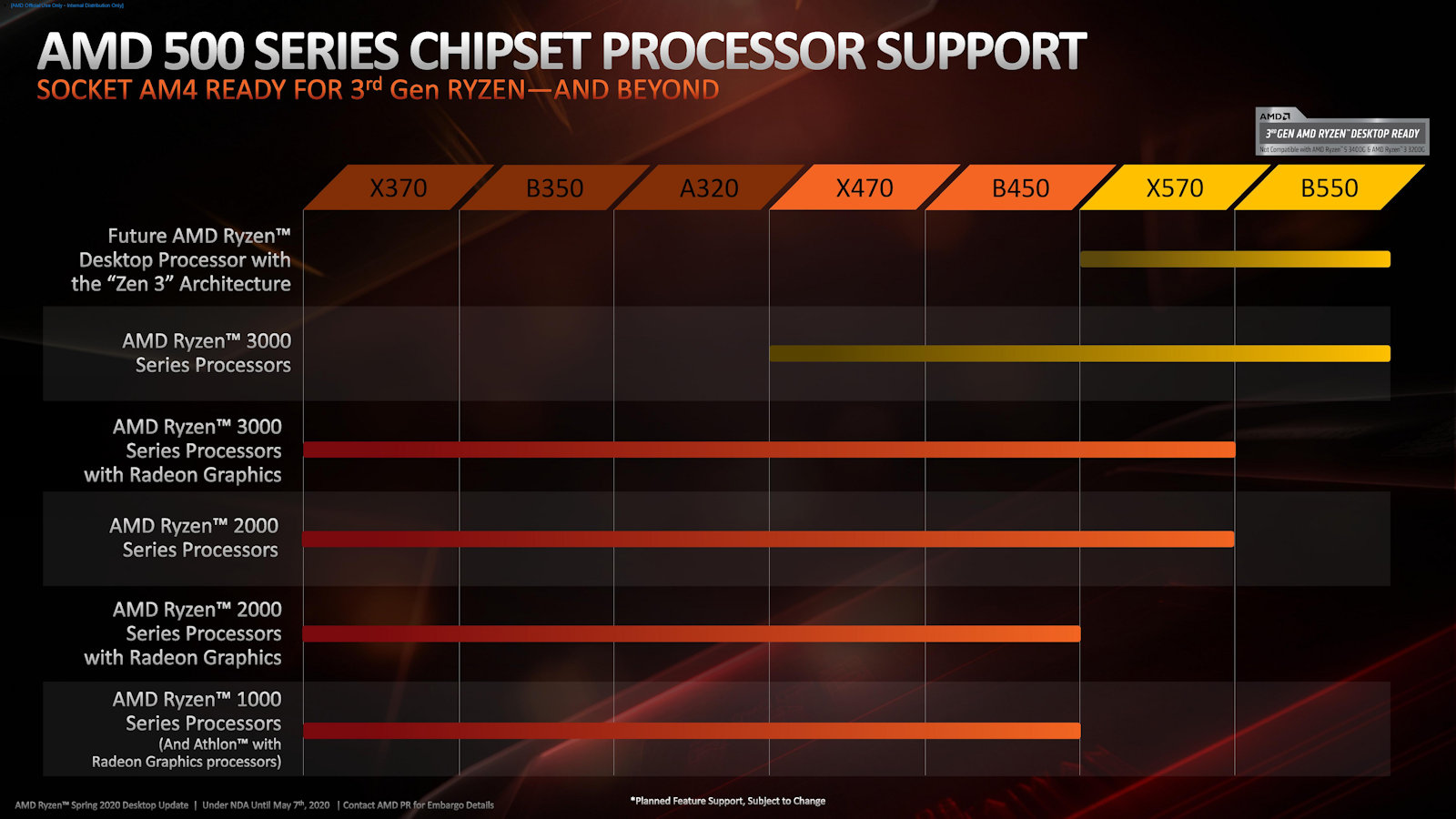

July 3, 20206 yr You would need a GPU to boot with this motherboard (it might be able to do headless, but you would need one if you want to at least configure the BIOS and all.) AMD doesn't integrate graphic in their CPU, unlike intel, unless they explicitly state it in their CPU number, by a G. Like the Ryzen 5 3400G. You will indeed need a GPU, but don't take it as an issue in itself, as I heard you transcode video? With Unraid Nvidia and a green team GPU, you could get some real use out of the caveat of needing a GPU sloted in for the board to post, grabbing the GPU away from the console displaying task and put it to work to transcode. Also, X570 chipset natively supports 3xxx ryzen. B450 is the one needing a BIOS update. Here's the cheat-sheet for you A was the now deprecated "cheapogarbagio"/basic board chipset line, B is the correct-to-nice consumer/gaming oriented one, X is the highend/overclocker/RGBpuke/featurerich line. 3xx boards are 'native' to 1000 series ryzen, 4xx boards are 'native' to 2000 series, 5xx boards to 3000 series, and won't need a BIOS update/swap to support their 'native' generation. Edited July 3, 20206 yr by Keexrean
