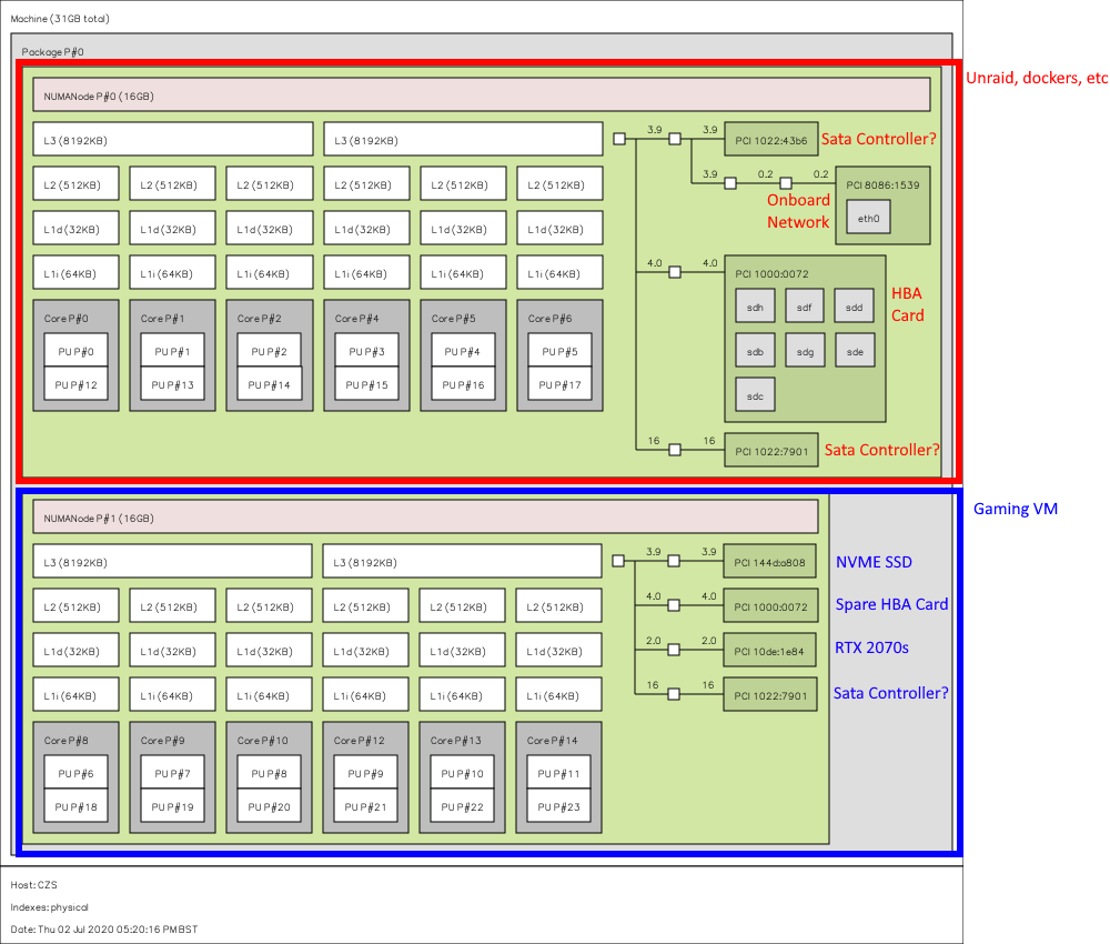

So i am in the process of setting up a gaming VM. But i have an issue that i cant seem to fix.
With machine type set to Q35 my vm crashes during benchmarking at random points but is never able to complete the benchmark. However if i use i440fx machine type the benchmark runs fine and doesn't crash. Although nvidia control panel reports the bus speed as just PCIE express.
On the Q35 machine type i put in the patch so that the bus speed is reported correctly as PCIe Gen 3 x16.
My setup is as follows:
Unraid 6.9.0-beta22
CPU: Threadripper 1920x
GPU: Gigabyte RTX 2070 super
MOBO: Asus Prime X399-a
RAM: 4x8GB 32GB Corsair Vengeance LPX 3000mhz
NVME boot drive
Here is my Q35 template using 4.1. The latest version 5.0 doesn't seem to make a difference so i tried downgrading to 4.2 and also tried 4.1.

Included my topology, have everything to do with the VM isolated on its own numa node. Memory Interleaving is set to channel as well on motherboard so should be only using memory on that node as well
