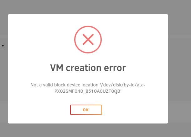

hey guys
I am try to passthrough a 400g sas ssd to a vm to install windows server 2016 on it but everytime i try i get an error about the block device not being there i have tried the unassigned plugin to give it passthrough status but its still not working am i missing something i am on 6.8.3 build
Regards
Andrew

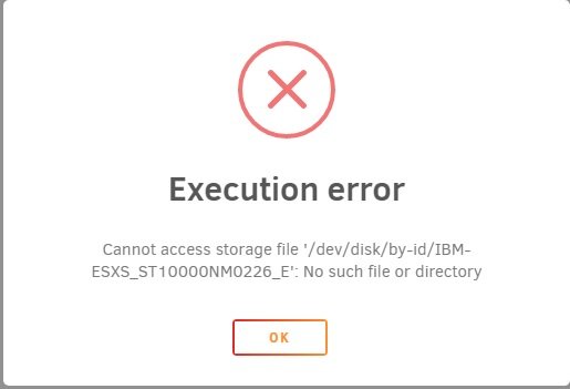

I was playing around with this, I have some need similar to yours, In the VM i have this sentences:
<disk type='block' device='disk'>
      <source dev='/dev/disk/by-id/IBM-ESXS_ST10000NM0226_E'/>
      <target dev='hdd' bus='sata'/>
      <address type='drive' controller='0' bus='0' target='0' unit='3'/>
    </disk>
And I get this error:
Did you manage to solve it?
Cheers
Are you sure the identification id (IBM-ESXS_ST10000NM0226_E) is correct?Maybe are you missing "ata-" in front of your id?

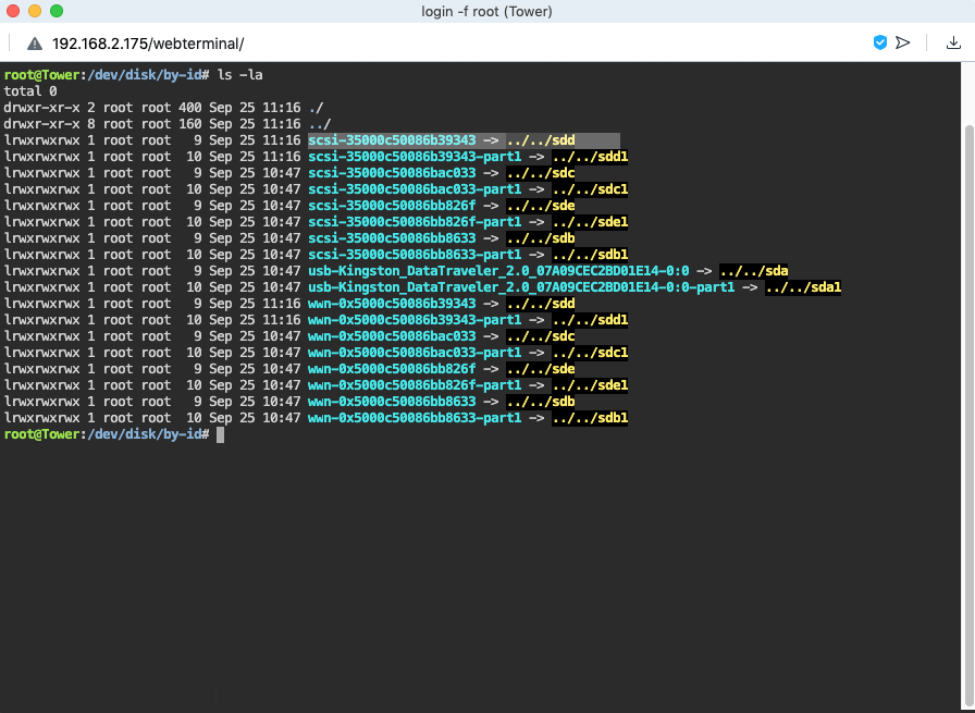

Well, thanks! That's something new to me! And the results I got have nothing to do with what I've written in the XML. It sounds very interesting and logical.
Here is what I've got from the devices, I've highlited /sdd the drive I want to pass through, however, it never got to windows's VM:

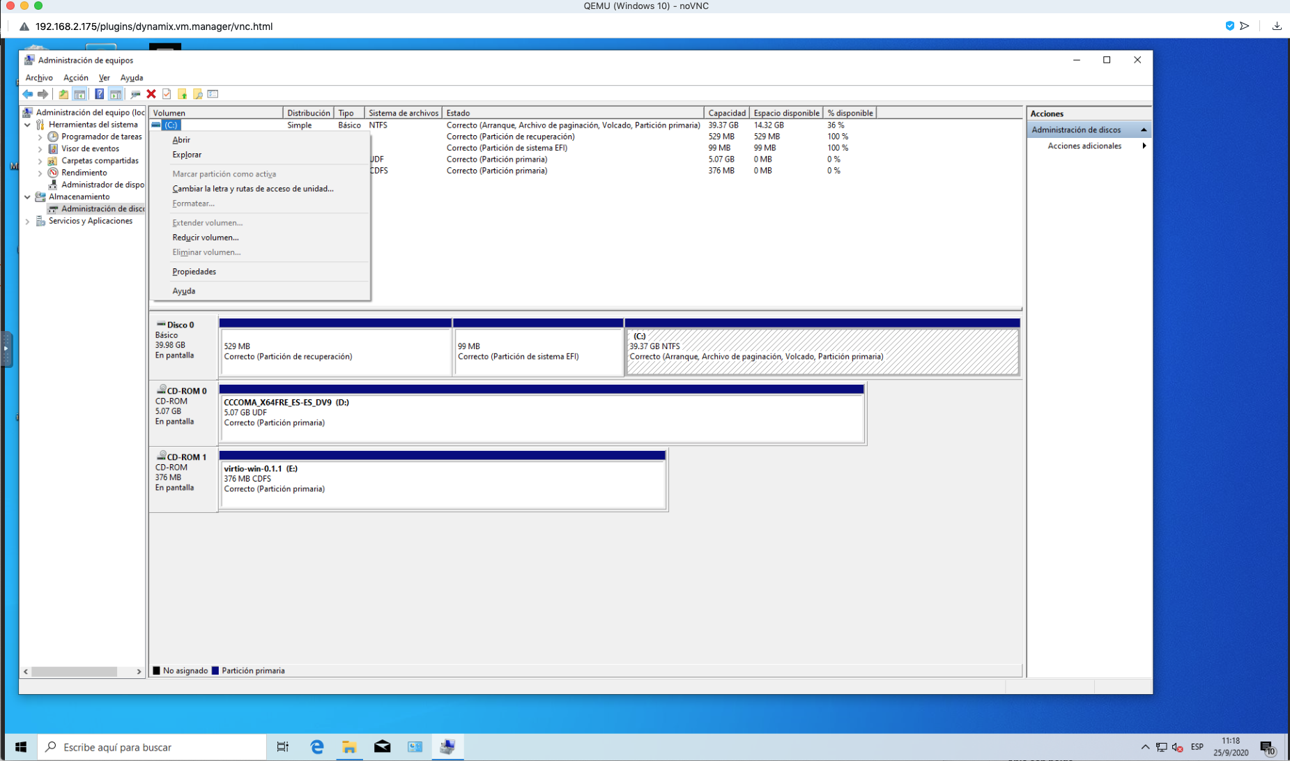

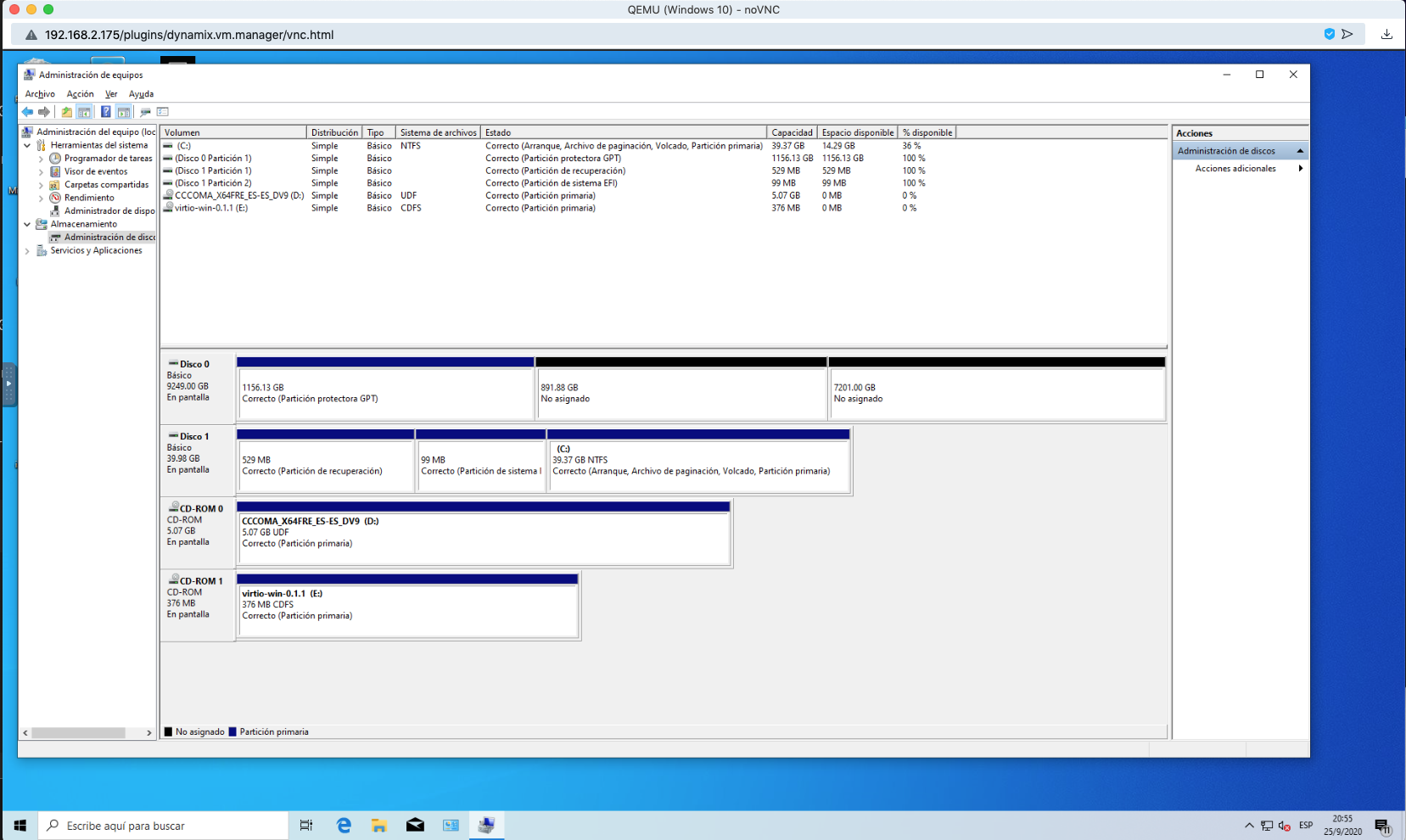

And now I see another disk, however I can not format, or erase it or create/ delete partitions:
When you use scsi bus for the disk and you don't see the disk are you sure you configured the scsi controller?
I asked the same thing in another discussion, but I think you misunderstood, since you replied about controller passthrough.
What I meant is if you had something like this in the xml:
<controller type='scsi' index='0' model='virtio-scsi'/>
From documentation:
When we only specify a disk device with "scsi" bus but without a scsi controller, libvirt will create an scsi controller of "lsi" model by default, which will make Virtio-scsi Passthrough unable to work properly.
Anyway if you are satisfied with sata, stick to it.
Edited by ghost82
16 hours ago, ghost82 said:
As I can see from your screensht, you have a protected partition.
Try to follow these steps:
https://endurtech.com/remove-protected-hard-drive-partitions-with-windows-10/

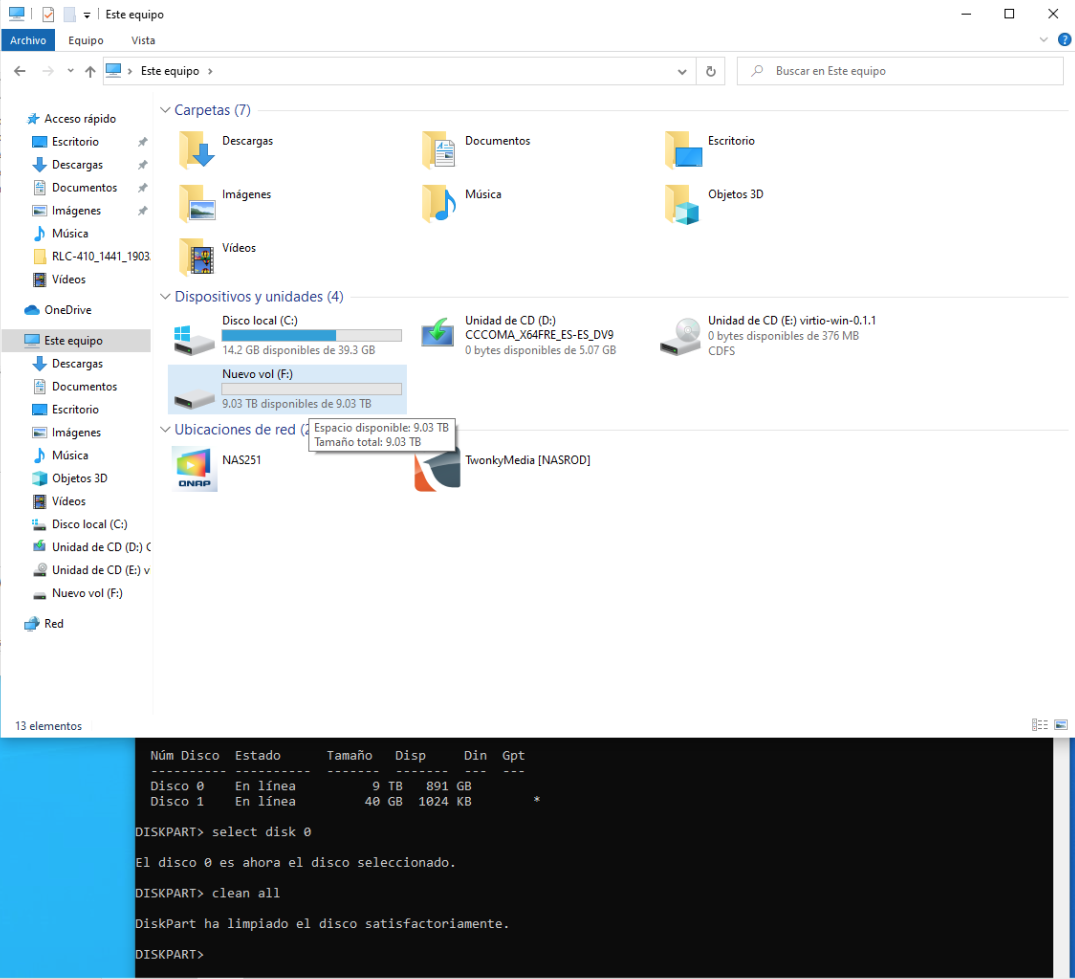

Dear Ghost82!
Thank you so much for your guidance and your patience, you are one of the kindest people I've found here. I wish more people were as kind as you.
Not only you guided me, but you even took some of your precious time to find a youtube video in spanish (which is my mother language) to help me overcome this issue. I can't be thankful enough!
I formated the drive under unraid and because of the size it had the locked GPT partition, I totally overlooked Diskpart, I don't use it that much, normally I adress and solve drive issues with disk manager.
Now I have my full 10 TB drive available in the Windows 10 VM. It is the "F" drive (not word hehe).
I hope that I can return you the favor in the future. If there was more people like you in this world, it would be way different!
Again! Thank you so much!
Cheers!

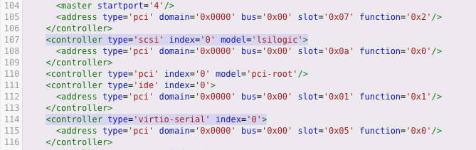

Ok, now I get it, I went over my xml file and found that I have such lines:
Then should I change my xml :
