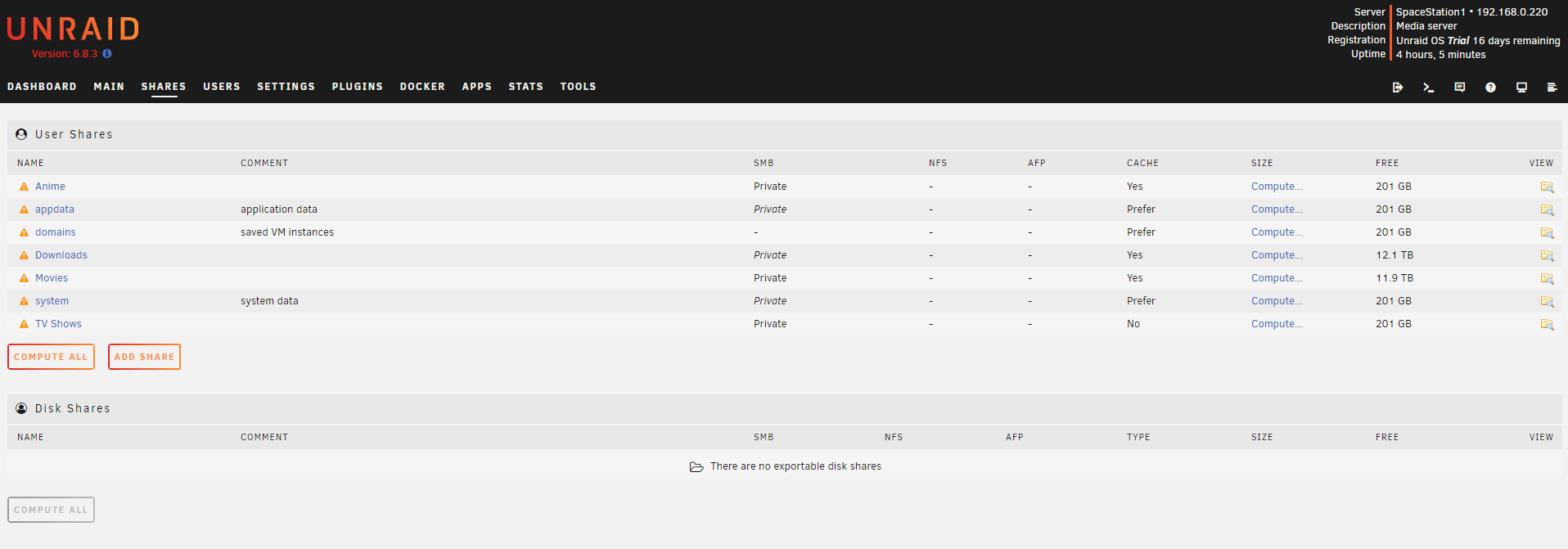

I did look around and I'm getting ideas but cannot seem to figure out what I can do to get my data back. I can see my shares in the diagnostics, but as per below image, it does not seem to be present. Now there are are orange exclamations next to each listed share below (not all present) and say "some or all files not protected".

The shares in your screenshot all exist, most with files on cache, some on disk1. There are other share .cfg files in your diagnostics but they don't exist on any drive.
Can you tell us more about how you did this?
I can only see 1 file in me cache drive in my anime folder, and 2 TV show series (not complete), which I'm assuming are on my cache drive.
