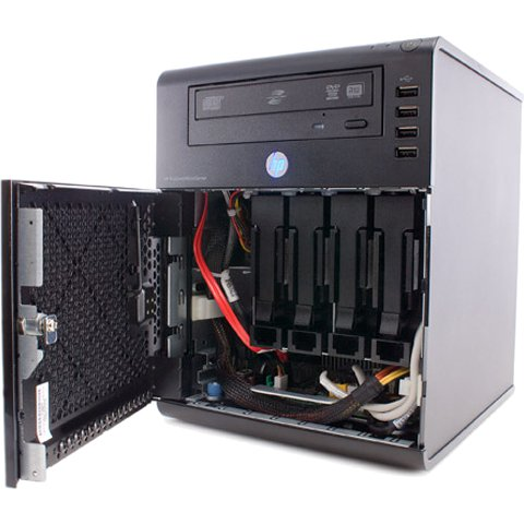

Just thinking, I have this model lying around.
It's called HP Microserver N40L, with an AMD Turion processor.  I can't recall how many GB I have on my memory.  Behind those 3.5" bays, I assume there is a backplane, with cable such as this.

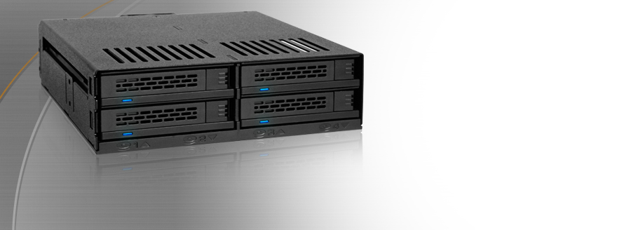

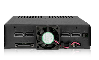

I want to add 4 more sata drives.  I'm thinking what if I placed an IcyDock ExpressCage.
And use an HBA controller that accepts 2 internal SFF-8087 and at the back, have an SFF-8088 port, and plug it onto my Fractal as additional drives, will this work?
Currently, the HDDs from the bays are currently connected to the SAS port on the motherboard.  I believe I can plug it to the additional HBA controller I'm gonna connect?  The HBA controller gets power from the PCI-e slot from the motherboard?  I believe it is PCI-e Gen 2, x16 slot.  Which card can you recommend?

IIRC the cable on the HP can't be replaced with one of those, the SATA part is part the the backplane.
If it cannot be replaced, the current cable terminates in SFF-8087.  I can just unplug it, and connect it to an HBA controller, and not plug it to the onboard one.

That you can do, it uses a standard SFF-8087 connection.
