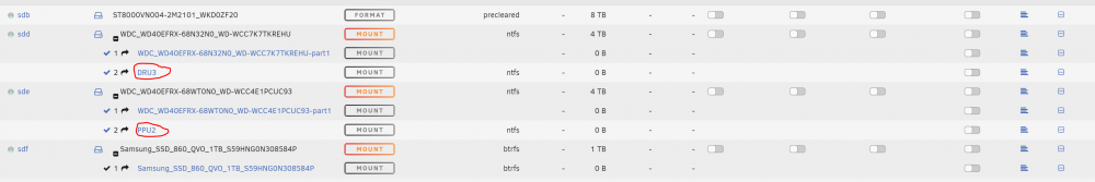

I have added by old flexraid disks to the server however when I click the mount button for these discs only PPU2 and DRU3 portion of the disc mounts. If I go into Krusader I only that portion of the disc which is full old flexraid files junk meta files I no longer need. All the media files appears to be in the WDC xxxxxx portion of the disc. If I take the disc out of the array and attach to to a separate windows machine I see all the media file, so the disc looks good. How can I mount this portion of disc in unassigned?
Here is a screenshot:
Edited by stepmback
Perhaps ask on the Unassigned Devices support thread and post your diagnostics.
To close the loop on this. I was told that : "Unraid (Linux) does not recognize a valid partition on the first partition of those disks."
My only option appears to be to copy over the network from my windows machine.
