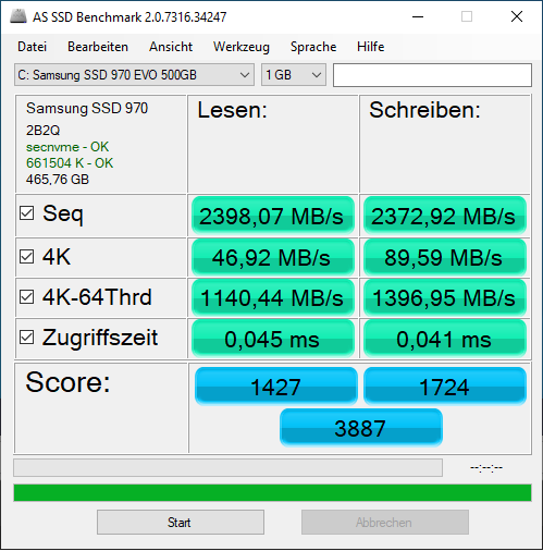

After adding this I get the following results in AS SSD:
Very close to bare metal performance!! And my vm is blazing fast! Can't tell I'm running in a vm or bare metal!

Hope this can help anyone else that have performance issues in a vm and where the vm feels slow and sluggish. Like night and day here now.
