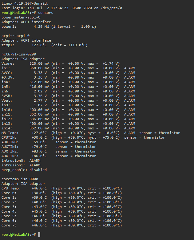

1 hour ago, rjack said:
Modprobe: ERROR could not insert 'nct6775': no such device. Is this related to my iGPU
No, that's a common motherboard sensor.  Something is likely trying to load a sensor you don't have or there is a problem with the sensor.
Start a terminal session from the GUI and type 'sensors' at the command line.
That shows what sensors your motherboard has.

Thank you for the response. I input sensors and it does not show the middle part in your picture (nct6791). Is this an issue with the build or a compatibility issue with my motherboard?
