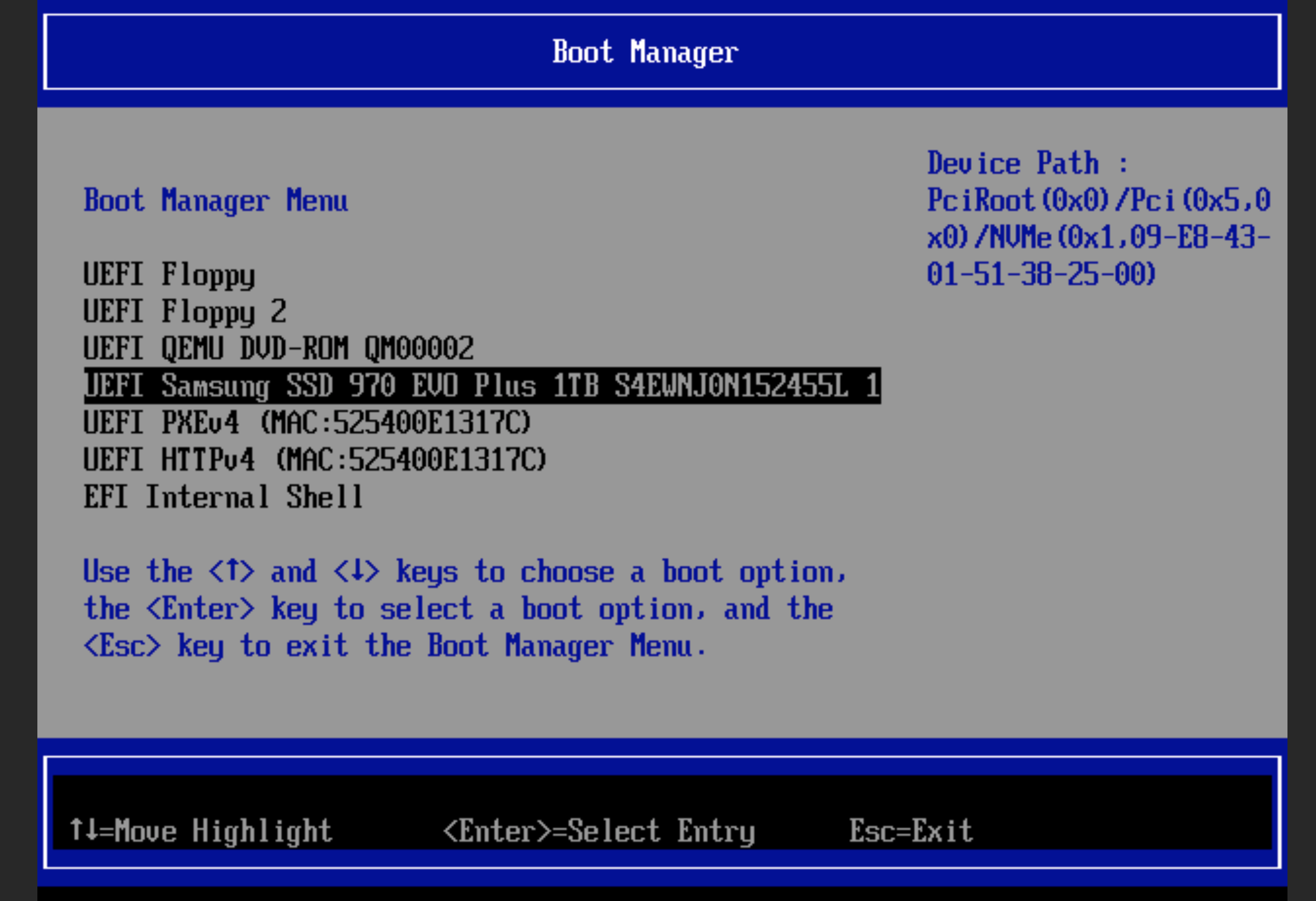

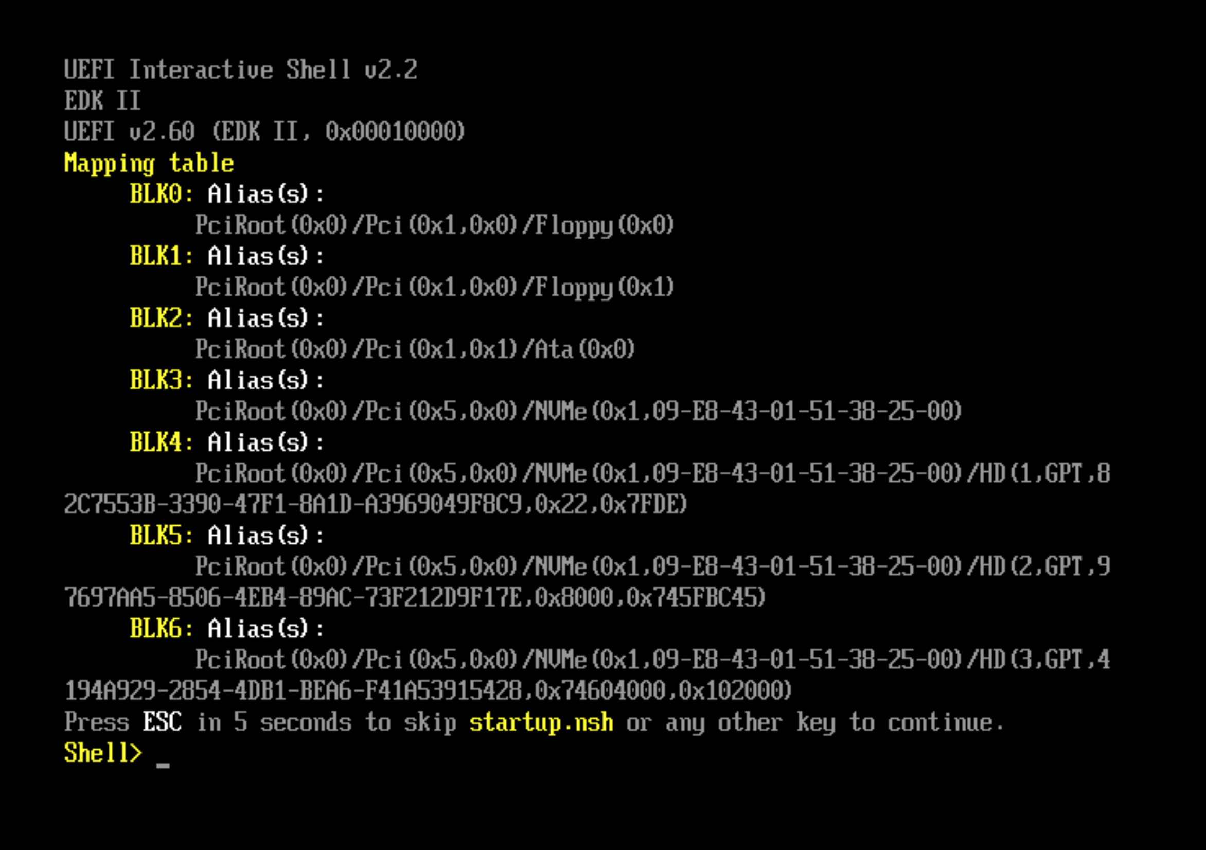

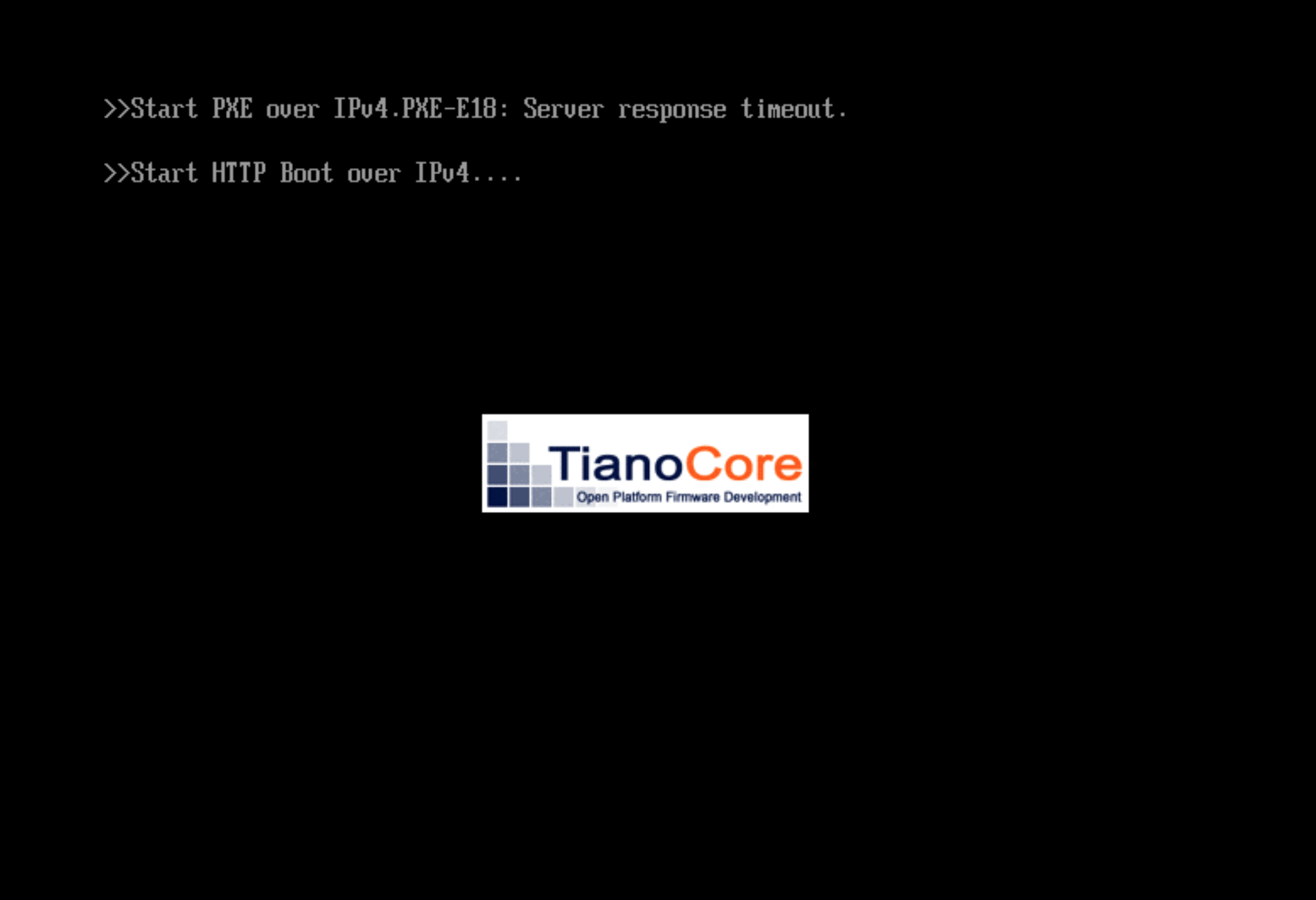

July 5, 20206 yr Hi! I just setup my new rig (specs below). I installed a bare metal Win10 install on my NVMe m.2, installed some apps and ran some benchmarks for a comparison later. I followed SI1 walkthrough here: https://www.youtube.com/watch?v=fnIn6GnA87c I setup my bios to get IOMMU groups and it looks they are all nicely seperated from eath other. Used VFIO-PCI Config from community applications to be able to pass through my NVMe in the VM. I tried different combinations with gpu passthrough and just VNC, combination of CPU cores and RAM allocations, Hyper-V on/off. The Problem is: When I boot the VM is instantly comes up with "Start PXE over IP4" then "Start HTTP boot over IP4" and then into shell. Intercepting it with F2 and clicking on the NVMe in bios manually wont do anything. (monitor goes black for a split second but nothing happens) I tried to add boot order in the form view but it did not change anything. My very uneducated guess is that the NVMe can’t be bootet. I checked and it is UEFI. Bare Metal boot works fine. Would love some help as I tried to rule out quite a few things on the weekend but don’t get anywhere atm. <?xml version='1.0' encoding='UTF-8'?> <domain type='kvm'> <name>Windows 10</name> <uuid>7fee0944-a204-83b3-7e75-f5c904b6aa45</uuid> <metadata> <vmtemplate xmlns="unraid" name="Windows 10" icon="windows.png" os="windows10"/> </metadata> <memory unit='KiB'>8388608</memory> <currentMemory unit='KiB'>8388608</currentMemory> <memoryBacking> <nosharepages/> </memoryBacking> <vcpu placement='static'>7</vcpu> <cputune> <vcpupin vcpu='0' cpuset='2'/> <vcpupin vcpu='1' cpuset='14'/> <vcpupin vcpu='2' cpuset='4'/> <vcpupin vcpu='3' cpuset='16'/> <vcpupin vcpu='4' cpuset='6'/> <vcpupin vcpu='5' cpuset='18'/> <vcpupin vcpu='6' cpuset='20'/> </cputune> <os> <type arch='x86_64' machine='pc-i440fx-4.2'>hvm</type> <loader readonly='yes' type='pflash'>/usr/share/qemu/ovmf-x64/OVMF_CODE-pure-efi.fd</loader> <nvram>/etc/libvirt/qemu/nvram/7fee0944-a204-83b3-7e75-f5c904b6aa45_VARS-pure-efi.fd</nvram> <boot dev='hd'/> </os> <features> <acpi/> <apic/> <hyperv> <relaxed state='on'/> <vapic state='on'/> <spinlocks state='on' retries='8191'/> <vendor_id state='on' value='none'/> </hyperv> </features> <cpu mode='host-passthrough' check='none'> <topology sockets='1' cores='7' threads='1'/> <cache mode='passthrough'/> <feature policy='require' name='topoext'/> </cpu> <clock offset='localtime'> <timer name='hypervclock' present='yes'/> <timer name='hpet' present='no'/> </clock> <on_poweroff>destroy</on_poweroff> <on_reboot>restart</on_reboot> <on_crash>restart</on_crash> <devices> <emulator>/usr/local/sbin/qemu</emulator> <disk type='file' device='cdrom'> <driver name='qemu' type='raw'/> <source file='/mnt/user/isos/virtio-win-0.1.173-2.iso'/> <target dev='hdb' bus='ide'/> <readonly/> <address type='drive' controller='0' bus='0' target='0' unit='1'/> </disk> <controller type='usb' index='0' model='ich9-ehci1'> <address type='pci' domain='0x0000' bus='0x00' slot='0x07' function='0x7'/> </controller> <controller type='usb' index='0' model='ich9-uhci1'> <master startport='0'/> <address type='pci' domain='0x0000' bus='0x00' slot='0x07' function='0x0' multifunction='on'/> </controller> <controller type='usb' index='0' model='ich9-uhci2'> <master startport='2'/> <address type='pci' domain='0x0000' bus='0x00' slot='0x07' function='0x1'/> </controller> <controller type='usb' index='0' model='ich9-uhci3'> <master startport='4'/> <address type='pci' domain='0x0000' bus='0x00' slot='0x07' function='0x2'/> </controller> <controller type='pci' index='0' model='pci-root'/> <controller type='ide' index='0'> <address type='pci' domain='0x0000' bus='0x00' slot='0x01' function='0x1'/> </controller> <controller type='virtio-serial' index='0'> <address type='pci' domain='0x0000' bus='0x00' slot='0x04' function='0x0'/> </controller> <interface type='bridge'> <mac address='52:54:00:e1:31:7c'/> <source bridge='br0'/> <model type='virtio'/> <address type='pci' domain='0x0000' bus='0x00' slot='0x03' function='0x0'/> </interface> <serial type='pty'> <target type='isa-serial' port='0'> <model name='isa-serial'/> </target> </serial> <console type='pty'> <target type='serial' port='0'/> </console> <channel type='unix'> <target type='virtio' name='org.qemu.guest_agent.0'/> <address type='virtio-serial' controller='0' bus='0' port='1'/> </channel> <input type='tablet' bus='usb'> <address type='usb' bus='0' port='1'/> </input> <input type='mouse' bus='ps2'/> <input type='keyboard' bus='ps2'/> <graphics type='vnc' port='-1' autoport='yes' websocket='-1' listen='0.0.0.0' keymap='en-us'> <listen type='address' address='0.0.0.0'/> </graphics> <video> <model type='qxl' ram='65536' vram='65536' vgamem='16384' heads='1' primary='yes'/> <address type='pci' domain='0x0000' bus='0x00' slot='0x02' function='0x0'/> </video> <hostdev mode='subsystem' type='pci' managed='yes'> <driver name='vfio'/> <source> <address domain='0x0000' bus='0x01' slot='0x00' function='0x0'/> </source> <address type='pci' domain='0x0000' bus='0x00' slot='0x05' function='0x0'/> </hostdev> <memballoon model='none'/> </devices> </domain> Quote IOMMU group 0:[1022:1482] 00:01.0 Host bridge: Advanced Micro Devices, Inc. [AMD] Starship/Matisse PCIe Dummy Host Bridge IOMMU group 1:[1022:1483] 00:01.1 PCI bridge: Advanced Micro Devices, Inc. [AMD] Starship/Matisse GPP Bridge IOMMU group 2:[1022:1483] 00:01.2 PCI bridge: Advanced Micro Devices, Inc. [AMD] Starship/Matisse GPP Bridge IOMMU group 3:[1022:1482] 00:02.0 Host bridge: Advanced Micro Devices, Inc. [AMD] Starship/Matisse PCIe Dummy Host Bridge IOMMU group 4:[1022:1482] 00:03.0 Host bridge: Advanced Micro Devices, Inc. [AMD] Starship/Matisse PCIe Dummy Host Bridge IOMMU group 5:[1022:1483] 00:03.1 PCI bridge: Advanced Micro Devices, Inc. [AMD] Starship/Matisse GPP Bridge IOMMU group 6:[1022:1483] 00:03.2 PCI bridge: Advanced Micro Devices, Inc. [AMD] Starship/Matisse GPP Bridge IOMMU group 7:[1022:1482] 00:04.0 Host bridge: Advanced Micro Devices, Inc. [AMD] Starship/Matisse PCIe Dummy Host Bridge IOMMU group 8:[1022:1482] 00:05.0 Host bridge: Advanced Micro Devices, Inc. [AMD] Starship/Matisse PCIe Dummy Host Bridge IOMMU group 9:[1022:1482] 00:07.0 Host bridge: Advanced Micro Devices, Inc. [AMD] Starship/Matisse PCIe Dummy Host Bridge IOMMU group 10:[1022:1484] 00:07.1 PCI bridge: Advanced Micro Devices, Inc. [AMD] Starship/Matisse Internal PCIe GPP Bridge 0 to bus[E:B] IOMMU group 11:[1022:1482] 00:08.0 Host bridge: Advanced Micro Devices, Inc. [AMD] Starship/Matisse PCIe Dummy Host Bridge IOMMU group 12:[1022:1484] 00:08.1 PCI bridge: Advanced Micro Devices, Inc. [AMD] Starship/Matisse Internal PCIe GPP Bridge 0 to bus[E:B] IOMMU group 13:[1022:790b] 00:14.0 SMBus: Advanced Micro Devices, Inc. [AMD] FCH SMBus Controller (rev 61) [1022:790e] 00:14.3 ISA bridge: Advanced Micro Devices, Inc. [AMD] FCH LPC Bridge (rev 51) IOMMU group 14:[1022:1440] 00:18.0 Host bridge: Advanced Micro Devices, Inc. [AMD] Matisse Device 24: Function 0 [1022:1441] 00:18.1 Host bridge: Advanced Micro Devices, Inc. [AMD] Matisse Device 24: Function 1 [1022:1442] 00:18.2 Host bridge: Advanced Micro Devices, Inc. [AMD] Matisse Device 24: Function 2 [1022:1443] 00:18.3 Host bridge: Advanced Micro Devices, Inc. [AMD] Matisse Device 24: Function 3 [1022:1444] 00:18.4 Host bridge: Advanced Micro Devices, Inc. [AMD] Matisse Device 24: Function 4 [1022:1445] 00:18.5 Host bridge: Advanced Micro Devices, Inc. [AMD] Matisse Device 24: Function 5 [1022:1446] 00:18.6 Host bridge: Advanced Micro Devices, Inc. [AMD] Matisse Device 24: Function 6 [1022:1447] 00:18.7 Host bridge: Advanced Micro Devices, Inc. [AMD] Matisse Device 24: Function 7 IOMMU group 15:[144d:a808] 01:00.0 Non-Volatile memory controller: Samsung Electronics Co Ltd NVMe SSD Controller SM981/PM981/PM983 IOMMU group 16:[1022:57ad] 02:00.0 PCI bridge: Advanced Micro Devices, Inc. [AMD] Matisse Switch Upstream IOMMU group 17:[1022:57a3] 03:03.0 PCI bridge: Advanced Micro Devices, Inc. [AMD] Matisse PCIe GPP Bridge IOMMU group 18:[1022:57a3] 03:04.0 PCI bridge: Advanced Micro Devices, Inc. [AMD] Matisse PCIe GPP Bridge IOMMU group 19:[1022:57a4] 03:08.0 PCI bridge: Advanced Micro Devices, Inc. [AMD] Matisse PCIe GPP Bridge [1022:1485] 06:00.0 Non-Essential Instrumentation [1300]: Advanced Micro Devices, Inc. [AMD] Starship/Matisse Reserved SPP [1022:149c] 06:00.1 USB controller: Advanced Micro Devices, Inc. [AMD] Matisse USB 3.0 Host Controller [1022:149c] 06:00.3 USB controller: Advanced Micro Devices, Inc. [AMD] Matisse USB 3.0 Host Controller IOMMU group 20:[1022:57a4] 03:09.0 PCI bridge: Advanced Micro Devices, Inc. [AMD] Matisse PCIe GPP Bridge [1022:7901] 07:00.0 SATA controller: Advanced Micro Devices, Inc. [AMD] FCH SATA Controller [AHCI mode] (rev 51) IOMMU group 21:[1022:57a4] 03:0a.0 PCI bridge: Advanced Micro Devices, Inc. [AMD] Matisse PCIe GPP Bridge [1022:7901] 08:00.0 SATA controller: Advanced Micro Devices, Inc. [AMD] FCH SATA Controller [AHCI mode] (rev 51) IOMMU group 22:[8086:2723] 04:00.0 Network controller: Intel Corporation Wi-Fi 6 AX200 (rev 1a) IOMMU group 23:[8086:1539] 05:00.0 Ethernet controller: Intel Corporation I211 Gigabit Network Connection (rev 03) IOMMU group 24:[10de:1e84] 09:00.0 VGA compatible controller: NVIDIA Corporation TU104 [GeForce RTX 2070 SUPER] (rev a1) [10de:10f8] 09:00.1 Audio device: NVIDIA Corporation TU104 HD Audio Controller (rev a1) [10de:1ad8] 09:00.2 USB controller: NVIDIA Corporation TU104 USB 3.1 Host Controller (rev a1) [10de:1ad9] 09:00.3 Serial bus controller [0c80]: NVIDIA Corporation TU104 USB Type-C UCSI Controller (rev a1) IOMMU group 25:[10de:1b82] 0a:00.0 VGA compatible controller: NVIDIA Corporation GP104 [GeForce GTX 1070 Ti] (rev a1) [10de:10f0] 0a:00.1 Audio device: NVIDIA Corporation GP104 High Definition Audio Controller (rev a1) IOMMU group 26:[1022:148a] 0b:00.0 Non-Essential Instrumentation [1300]: Advanced Micro Devices, Inc. [AMD] Starship/Matisse PCIe Dummy Function IOMMU group 27:[1022:1485] 0c:00.0 Non-Essential Instrumentation [1300]: Advanced Micro Devices, Inc. [AMD] Starship/Matisse Reserved SPP IOMMU group 28:[1022:1486] 0c:00.1 Encryption controller: Advanced Micro Devices, Inc. [AMD] Starship/Matisse Cryptographic Coprocessor PSPCPP IOMMU group 29:[1022:149c] 0c:00.3 USB controller: Advanced Micro Devices, Inc. [AMD] Matisse USB 3.0 Host Controller IOMMU group 30:[1022:1487] 0c:00.4 Audio device: Advanced Micro Devices, Inc. [AMD] Starship/Matisse HD Audio Controller CPU Thread Pairings Pair 1:cpu 0 / cpu 12 Pair 2:cpu 1 / cpu 13 Pair 3:cpu 2 / cpu 14 Pair 4:cpu 3 / cpu 15 Pair 5:cpu 4 / cpu 16 Pair 6:cpu 5 / cpu 17 Pair 7:cpu 6 / cpu 18 Pair 8:cpu 7 / cpu 19 Pair 9:cpu 8 / cpu 20 Pair 10:cpu 9 / cpu 21 Pair 11:cpu 10 / cpu 22 Pair 12:cpu 11 / cpu 23 USB Devices Bus 001 Device 001:ID 1d6b:0002 Linux Foundation 2.0 root hub Bus 001 Device 002:ID 048d:8297 Integrated Technology Express, Inc. ITE Device(8595) Bus 001 Device 003:ID 05e3:0608 Genesys Logic, Inc. Hub Bus 002 Device 001:ID 1d6b:0003 Linux Foundation 3.0 root hub Bus 003 Device 001:ID 1d6b:0002 Linux Foundation 2.0 root hub Bus 003 Device 002:ID 8087:0029 Intel Corp. Bus 003 Device 003:ID 05e3:0608 Genesys Logic, Inc. Hub Bus 003 Device 004:ID 03f0:094a Hewlett-Packard Optical Mouse [672662-001] Bus 003 Device 005:ID 05ac:1006 Apple, Inc. Hub in Aluminum Keyboard Bus 003 Device 006:ID 05ac:0220 Apple, Inc. Aluminum Keyboard (ANSI) Bus 004 Device 001:ID 1d6b:0003 Linux Foundation 3.0 root hub Bus 005 Device 001:ID 1d6b:0002 Linux Foundation 2.0 root hub Bus 006 Device 001:ID 1d6b:0003 Linux Foundation 3.0 root hub Bus 007 Device 001:ID 1d6b:0002 Linux Foundation 2.0 root hub Bus 008 Device 001:ID 1d6b:0003 Linux Foundation 3.0 root hub Bus 008 Device 002:ID 0781:5583 SanDisk Corp. Ultra Fit SCSI Devices [0:0:0:0]disk SanDisk Ultra Fit 1.00 /dev/sda 30.7GB [3:0:0:0]disk ATA M4-CT128M4SSD2 0309 /dev/sdb 128GB [5:0:0:0]disk ATA ST4000NE001-2MA1 EN01 /dev/sdc 4.00TB [6:0:0:0]disk ATA ST4000NE001-2MA1 EN01 /dev/sdd 4.00TB Specs of PC: Ryzen 3900x 64GB Ram Samsung NVME Evo Plus 1TB Nvidia 1070ti Nvidia 2070 super Edited July 6, 20206 yr by Grsh added xml as code

July 6, 20206 yr Author 6 minutes ago, audias said: have you try to boot with only passing you NVME drive? i have similar setup with you, when i setup i add one device then boot, shutdown, add another one then boot, repeat until all device added, that way i know which device is causing the problem Thanks for the reply! I tried only the NVMe but same outcome. End up in shell. NVMe is visible in bios but if I select it it still wont boot. It looks like the NVMe is recognised but is not able to be booted. Is there any special trick I have to do?

July 7, 20206 yr You've installed windows as a MBR volume, so convert it to GPT. Lookup mbr2gpt conversion. Edited July 7, 20206 yr by killasniff
July 7, 20206 yr Author 2 hours ago, killasniff said: You've installed windows as a MBR volume, so convert it to GPT. Lookup mbr2gpt conversion. OMG! Read you comment and did it straight away. mbr2gpt would not work for me so I reinstalled Win10 and just tested it and it worked! Thanks so much for your help! I would have never thought og this. Coming from OSX/hackintosh I never really had to deal with this. Thanks a bunch for everyones input.
