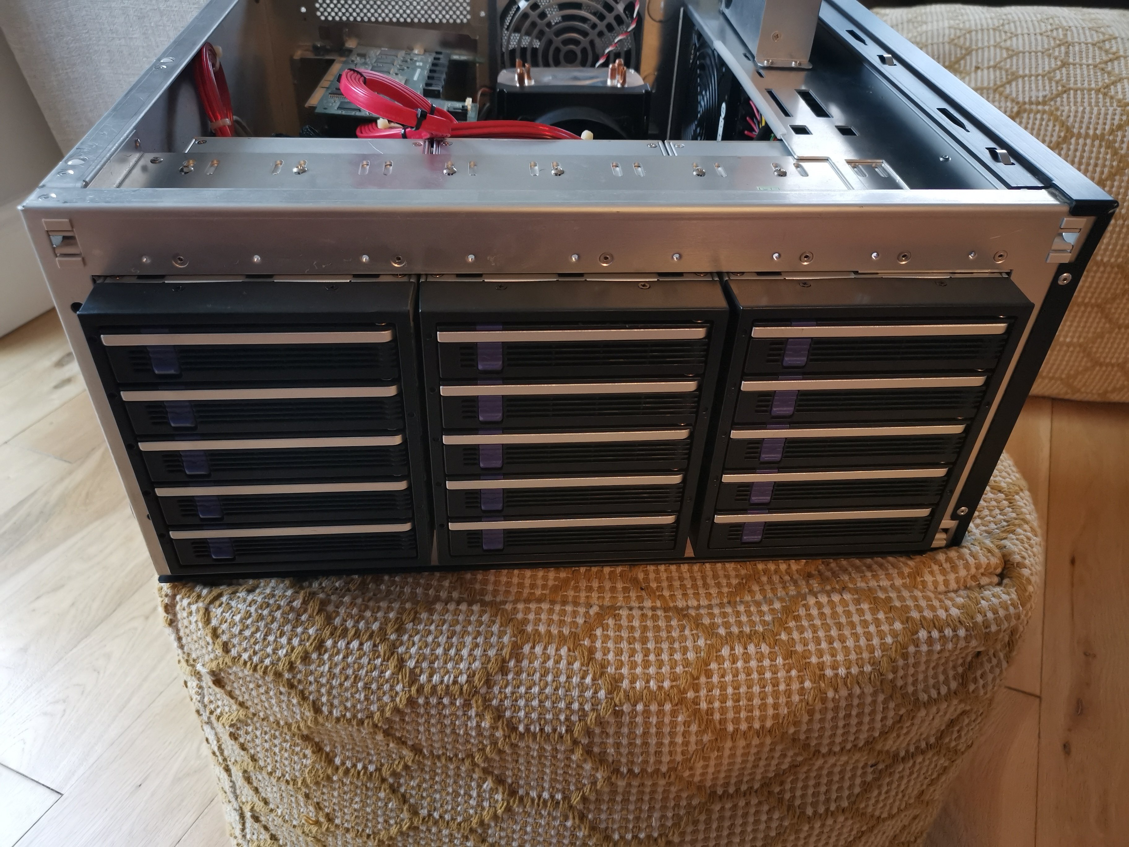

I have this old FreeNas server which i've not powered on for years.  It developed a problem with one of the controllers and i got busy (work, kids, houses etc.) that i never did get around to sorting it.  I wanted to reuse some of the components in it but i'm really out of sync with modern-day computer components so i'm looking for advice / gotchas i should be aware of.
Lian Li full size case with 15 x 5.25" front bays
Asus M2N32 WS Pro Motherboard (believe it's full ATX size)
Unknown AMD AM2 CPU and a massive fan
4 x 2GB DDR2 ram
3 x icydock hot-swap 5 drive drive enclosures giving 15 hot-swap bays
5 x 500G SATA Seagate drives
5 x 1TB SATA WD Green drives
2 x Adaptec 6 port SATA PCIx controllers (one is a Dell rebrand one isn't)
Silverstone modular PSU - can't remember the power but maybe around 400W perhaps
I'm using 5 ports on each controller, plus 5 off the mainboard
I would love to reuse as much hardware as possible but i have some concerns / questions about doing so.  Firstly, i need to understand the power requirements of modern motherboards (the M2M32 is 24 and 8 pin).  If the PSU is man enough for all the drives / motherboard, GPU etc and if i can reuse the SATA cables and drive bays and take advantage of SATA3.  I can't see why the cables should be an issue, the drive bays have a passive backplane as much as i can remember and see so i don't think that'll be a problem either.

Some photos of the old rig
Edited by Jacko_
Added some photos to get your
