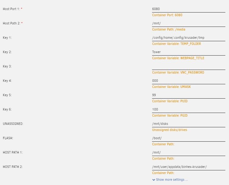

2) I was able to transfer a few movies over Ethernet (everything is wired to gigabit the R720 even has 10GBE) but ran into the retransfer bottle neck where it transfers the data to the remote machine between the NAS and the R720. To facilitate a quicker transfer of files from the WD NAS to Unraid I'd like to use Krusader (I've used windows all my life, CMD prompt file exploring is too foreign to me). But SI1 hasn't updated his Krusader video for the binhex version (or I can't find it) and I can't quite figure out the setup to create the paths and access the things the same way he does in the video. I even tried to brute force his entries. I don't see that any of my modifications show up in Krusader. I've attached a screenshot of the Krusader setup/ configuration.
