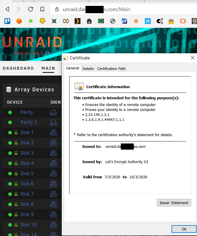

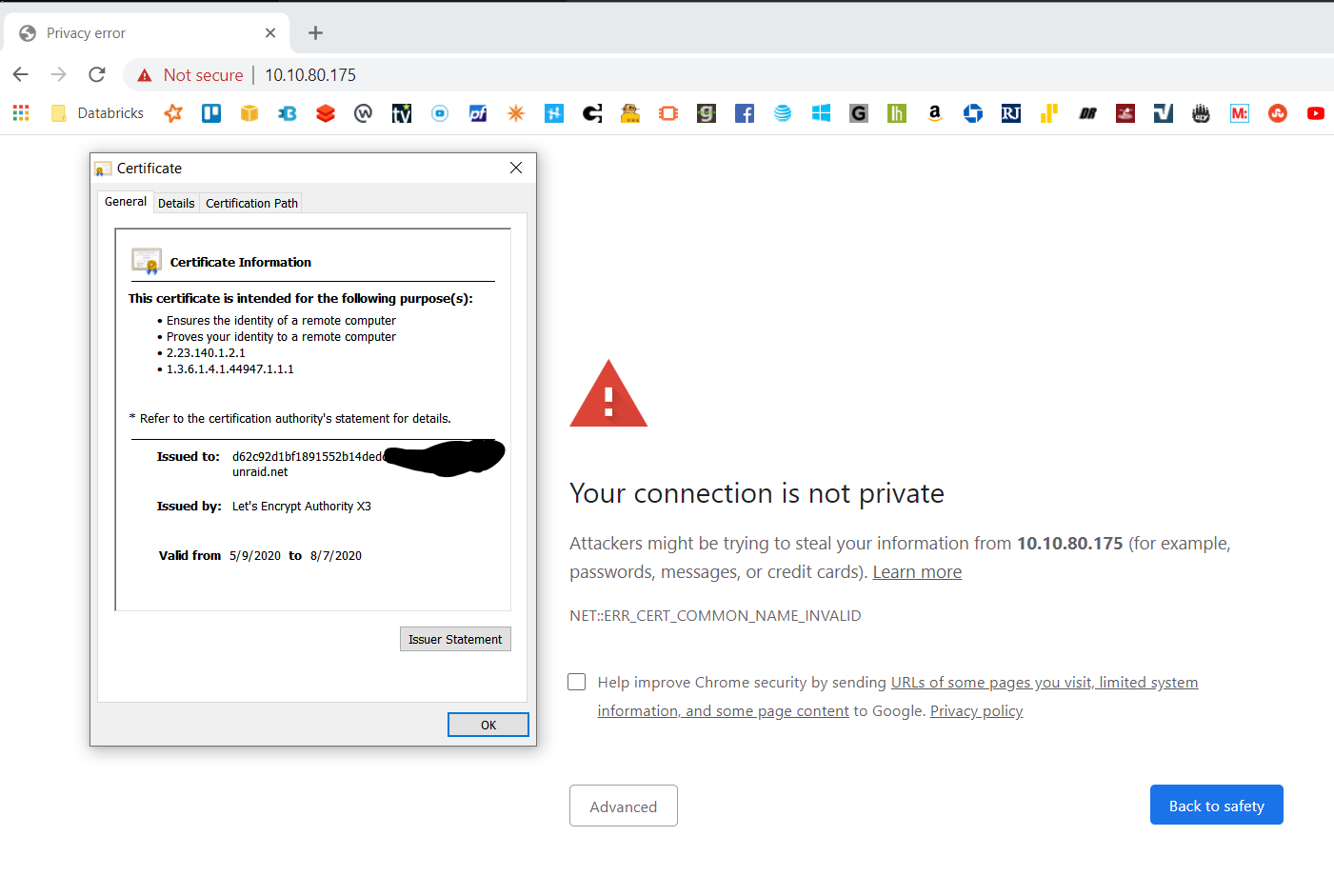

geeksheikh Posted July 8, 2020 Share Posted July 8, 2020 Hello, I've just switched from letsEncrypt to using my own certs, signed by my own CA. Everything is working with the public domains, but the local IP still appears to be registered with unraid and is pulling the let's encrypt cert from unraid.net. How can one deprovision their private ip and clean up the link with unraid's letsencrypt? Thanks Quote Link to comment

geeksheikh Posted July 8, 2020 Author Share Posted July 8, 2020 Thanks, yeah I read that and got my own certs to work...it's just that now the private IP is still provisioned with unraid.net's let'sEncrypt cert. So unraid.mydomain.com cert is correct but the 10.10.80.175 local ip still uses the unraid cert...trying to figure out how to deprovision my local IP from the unraid cert. Quote Link to comment

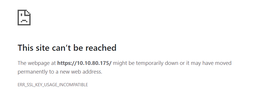

geeksheikh Posted July 8, 2020 Author Share Posted July 8, 2020 ok, so there was a signature issue and that's why it wouldn't restart. I got that fixed...now nginx has been restarted and is healthy. So now there's no unraid.net let'sEncrypt cert reference and my public ACME certs are working on public domain now (via reverse proxy) -- I think this can be ignored for the purpose of this issue. Local IP https cert appears to be invalid -- "ERR_SSL_KEY_USAGE_INCOMPATIBLE" I have 2 pem bundles in the /boot/config/ssl/certs/ dir: certificate_bundle.pem (soft linked from unraid_bundle in /etc/ssl/certs) <server>_unraid_bundle.pem These two bundles were create as such certificate_bundle.pem root_ca private key file root_ca cert intermediate_ca cert <server>_unraid_bundle.pem server_cert.key server_cert Anything sticking out to you that seems wrong? Quote Link to comment
Jerky_san Posted July 8, 2020 Share Posted July 8, 2020 4 minutes ago, srfnmnk said: ok, so there was a signature issue and that's why it wouldn't restart. I got that fixed...now nginx has been restarted and is healthy. So now there's no unraid.net let'sEncrypt cert reference and my public ACME certs are working on public domain now (via reverse proxy) -- I think this can be ignored for the purpose of this issue. Local IP https cert appears to be invalid -- "ERR_SSL_KEY_USAGE_INCOMPATIBLE" I have 2 pem bundles in the /boot/config/ssl/certs/ dir: certificate_bundle.pem (soft linked from unraid_bundle in /etc/ssl/certs) <server>_unraid_bundle.pem These two bundles were create as such certificate_bundle.pem root_ca private key file root_ca cert intermediate_ca cert <server>_unraid_bundle.pem server_cert.key server_cert Anything sticking out to you that seems wrong? Does it do it in IE and Firefox? Also I believe maybe you have the key type wrong perhaps? Not 100% on that as I've never personally got that error but I believe it could be like you have it set as client auth instead of server or something like that. Quote Link to comment

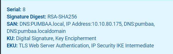

geeksheikh Posted July 8, 2020 Author Share Posted July 8, 2020 Yes, it does the same thing in other browsers. Yeah I was thinking that too but seems right...as far as I can tell (I did also try a client cert but got same error) Appreciate the help. FYI the certs/keys were created and signed in pfsense and I just downloaded them and concat'd them Quote Link to comment
Jerky_san Posted July 8, 2020 Share Posted July 8, 2020 18 minutes ago, srfnmnk said: Yes, it does the same thing in other browsers. Yeah I was thinking that too but seems right...as far as I can tell (I did also try a client cert but got same error) Appreciate the help. FYI the certs/keys were created and signed in pfsense and I just downloaded them and concat'd them In the chrome address bar if it shows the lock at all click it go to view certificate, details, and look for "enhanced key usage" and see what it says if it will let you. Below is an example of what it should say. Quote Link to comment
