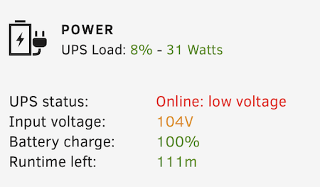

August 9, 20206 yr Author Today I saw evidence of AVR kicking. Voltage at the wall outlet was ~104V Voltage at the UPS was ~116V My UPS is set to High Sensitivity $ upsc cyberpower | grep 'ups.status' Init SSL without certificate database ups.status: OL BOOST Edited August 9, 20206 yr by CS01-HS

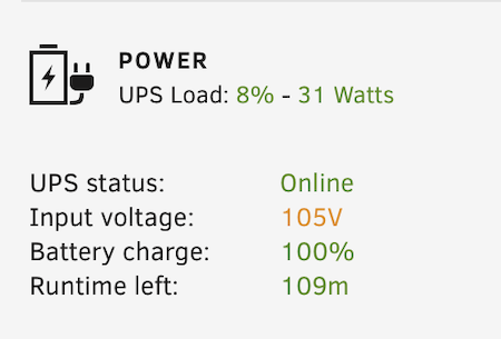

August 9, 20206 yr Author No Boosting at 105 so at least in my case (Cyberpower 685AVRG set to High Sensitivity) the low bound for AVR is 104V.
