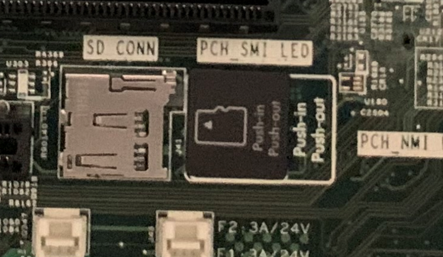

July 8, 20206 yr Hi Guys; I have a HPE server which has motherboard with a microsd slot. I searched the forum whether it can be unraid booted (& licensed) from microsd card. All I found was regarding microsd usb card readers. Can I buy unraid license and use on motherboard microsd?
July 8, 20206 yr 6 minutes ago, emrepolat7 said: Hi Guys; I have a HPE server which has motherboard with a microsd slot. I searched the forum whether it can be unraid booted (& licensed) from microsd card. All I found was regarding microsd usb card readers. Can I buy unraid license and use on motherboard microsd? It depends on whether the card reader has a unique GUID or not. Impossible to know without actually owning the product. You probably are better off assume "No".
July 8, 20206 yr Author Thank you for your reply, I got little confused about slot vs reader. Maybe both are the same. Let me attach my microsd slot/reader picture just in case they are not the same. Then you can easily identify. Edited July 8, 20206 yr by emrepolat7 attachment
July 8, 20206 yr IF it works, then your license would be tied to the motherboard. Can't hurt to try, you will have to follow the directions to manually install Unraid onto the flash. When you boot it and try to register your trial install it will let you know if it can't be licensed. I'm kind of betting that it won't work at all though.
