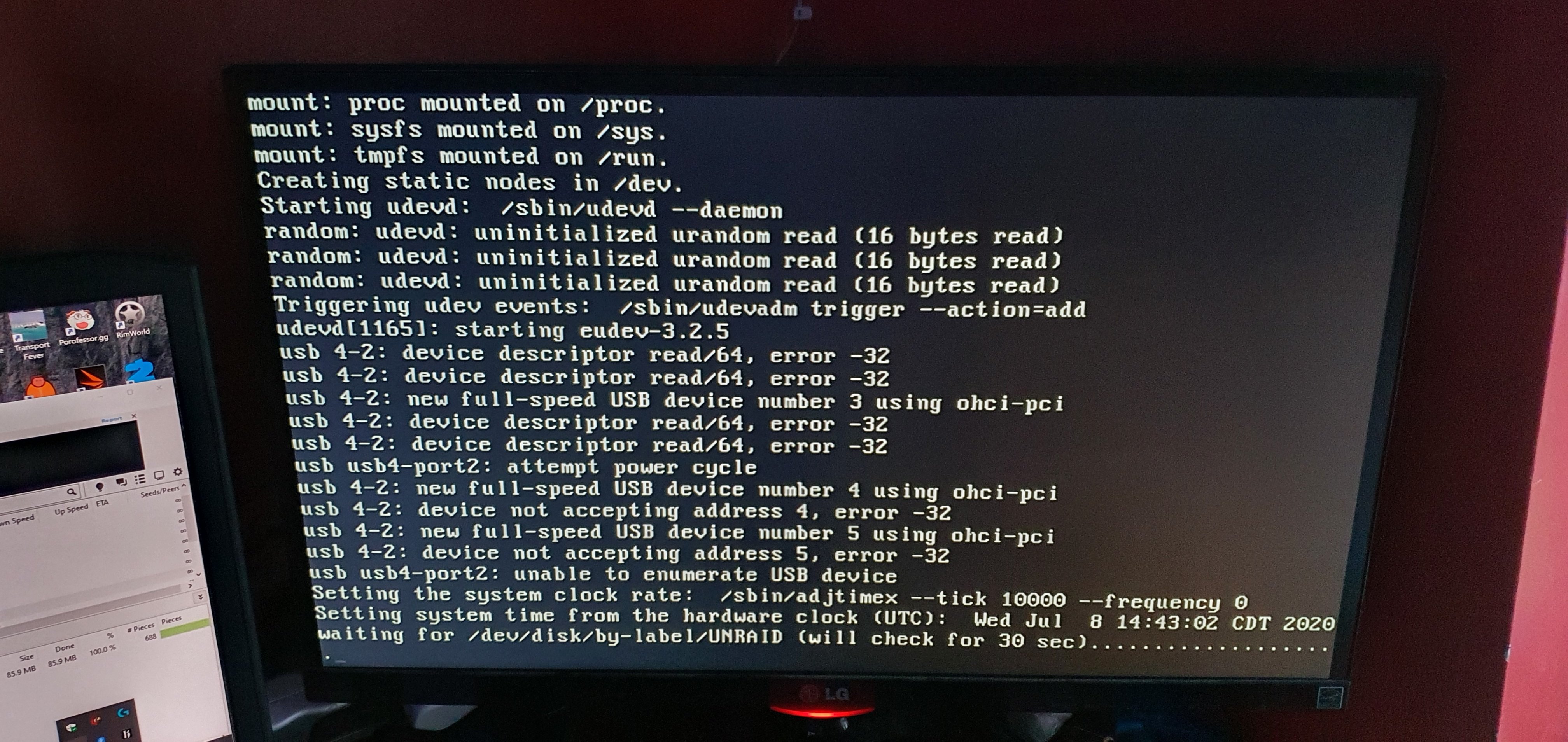

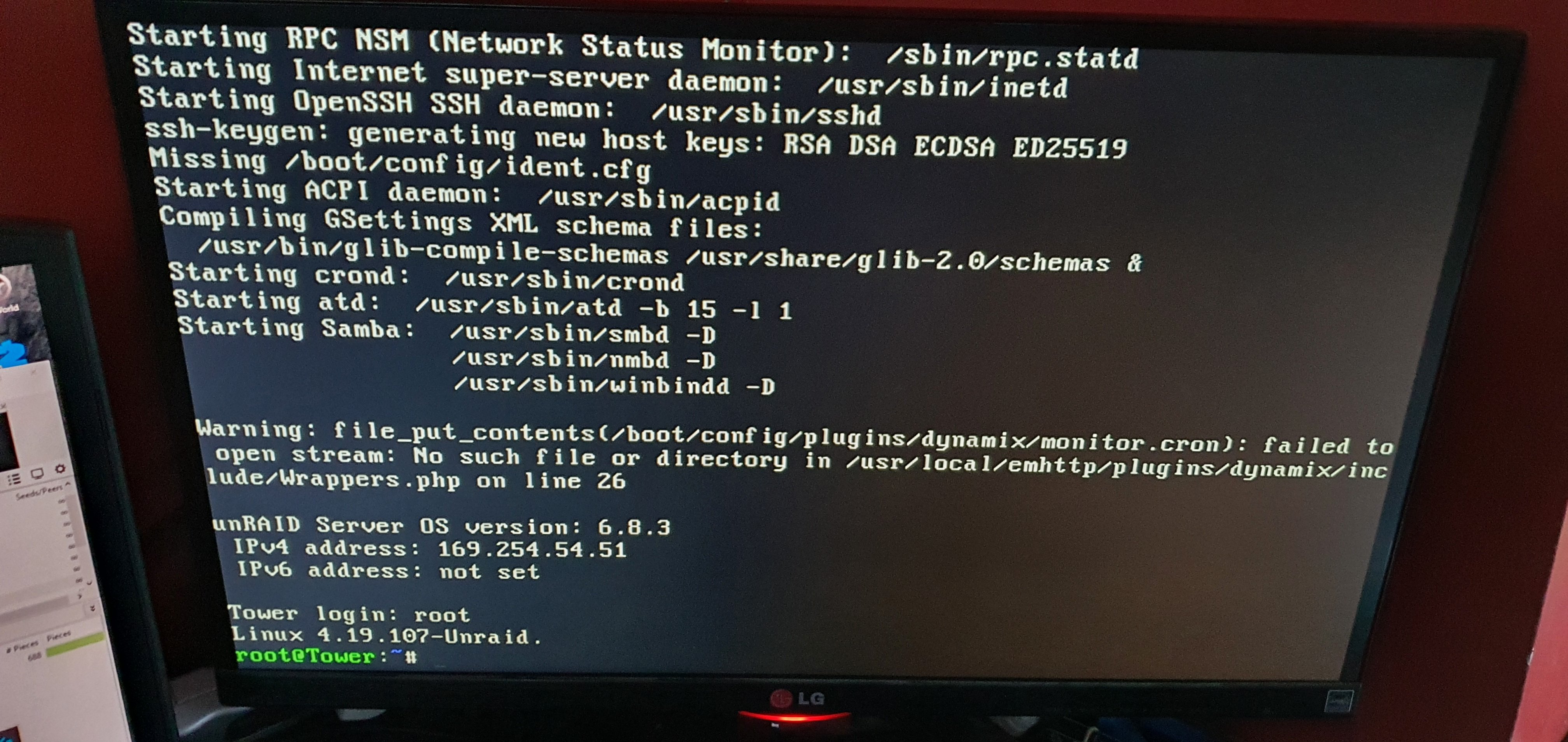

No matter the scenario or what boot options I pick (I tried almost every option in the bios) when I get into unraid I have a 169. Ip address so no connection. While booting I get "device descriptor read/64, error - 32"
I have managed to boot a fully functioning Ubuntu from 2 of the 3 usbs (1 wouldn't work for Ubuntu on the desktop but all 3 would boot unraid and Ubuntu on my laptop)

Any help is appreciated I have attached photos of the boot screen and the ip address when fully booted, when trying to pull the diagnostics from the flash drive after running the command it is not present or is not displaying on my windows machine.

Based on the screens it's a flash drive problem, try redoing it or using a different one.

I have tried using both the USB creator provided by unraid and using the zip file and manually installing, both times running the make bootable as admin.
I'm the photo I used the USB creator to make the most recent stable build and done no manual configuration.
I also get a bond0 error.

Also a flash related error, try a different flash drive.
Hi, I have tried 3 different flash drives across 6 different USB ports and it's always a similar error, I know the pc can boot from flash drive as I successfully done a Ubuntu live environment from the drive in the photo.
The drive used for the photo is also brand new I bought it from argos yesterday as I only had been testing with 2 old drives and felt it might be the drive this made no difference.
The drives also all work fine booting unraid on my laptop.

I solved the other issue by changing the network config back to its original from the static IP I had set.
