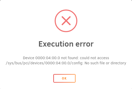

I started unraid, everything came up normal except for the docker containers and and the VMs.  When I try to run the VM (which is my firewall) it reports the following:
When I remove the new card everything works normally, the Firewall VM loads and all dockers load.  I also noticed this exact problem when I moved the HBA from the right most slot (closest to the cpu) to one slot over.  I believe the original slot was 10 and the next slot over was 11.  is there a way to change the behavior?

Adding new hardware usually changes the IDs of some of the existing one, so any passedthrough device might need adjustment to the new ID.

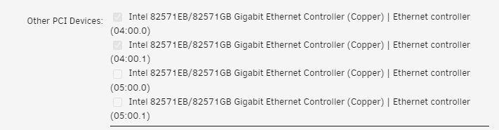

Oh, I know now what is wrong, I am passing through the 4 port Ethernet card to that vm, so I can see where that would be a problem.  I will take a look at this.
Edited by SidebandSamurai
Yes that appears to be my problem.  Take a look at this screen shot here.  That device matches the error I was getting from the VM startup.
