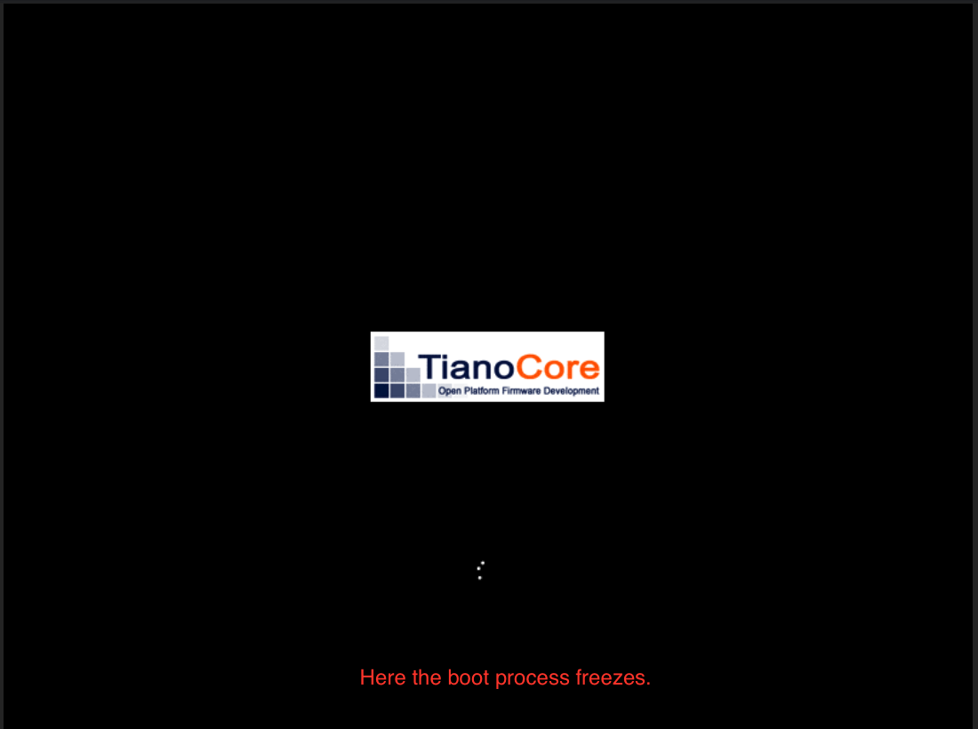

The Windows VM starts up to the TianoCore screen and then the boot process freezes. It won't continue and i have to turn off the VM hard.

5546541_Bildschirmfoto2020-07-09um09_57_18.thumb.png.8ac95818f914e14faa279a14bdf9e86f.png

Perhaps try this.
Go to your motherboard BIOS and turn on the iGPU. Then connect your monitor to the port on the motherboard and boot up - make sure Unraid boots with the iGPU display.
Then look for SpaceInvader One video on how to dump your vbios and dump your own for the 580. Then try that.
Reason: (a) the 580 is notorious on here for not liking passthrough if it has been booted with Unraid and (b) there are 7 different versions of the 580 Pulse and the vbios has to be super specific hence the best way to do it is to dump your own.
Thank you for your answer. Sorry to be so late, but I've been very busy these past few weeks. The Windows VM is now running on my computer. After I activated the iGPU and created the VBIOS of my graphics card, I could boot the Windows 10 VM without any problems. Even a newly installed Windows VM is now running without problems. Thanks for your help!
