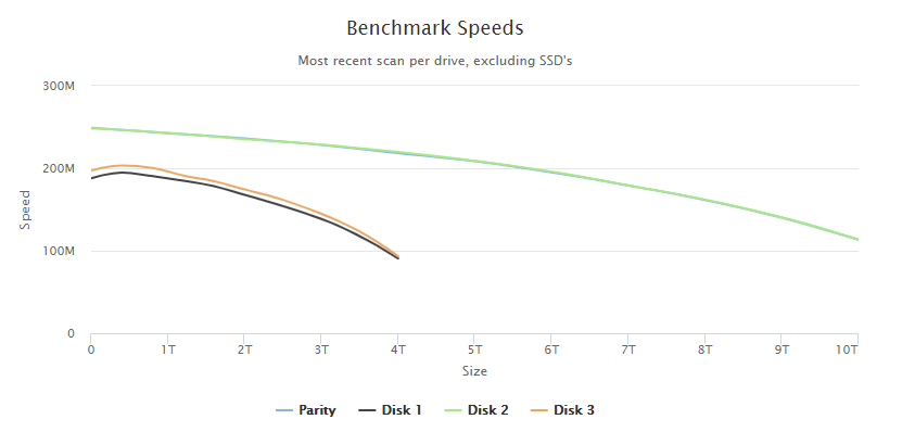

July 10, 20206 yr Community Expert 1 hour ago, Giovanni Kosman said: I did some more testing and made a share that only used 1 disk at a time. Performance seems fine on every disk except for disk1. I think it's a faulty disk. The disks came from my old NAS so was to be expected I think. Will test some more with the disk out of the array and keep this post updated. You might want to try installing the DiskSpeed docker to test the disk. you should be able to do that with the disk still in the array.
July 10, 20206 yr Author 32 minutes ago, itimpi said: You might want to try installing the DiskSpeed docker to test the disk. you should be able to do that with the disk still in the array. I'll do that after I moved the files. Currently running the unbalancer plugin so I can test some more later.

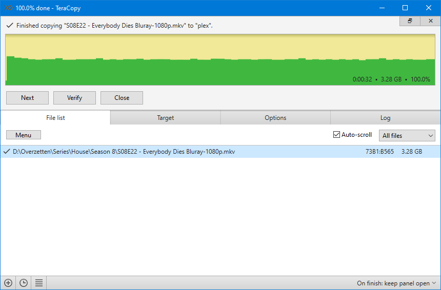

July 11, 20206 yr Author So now I actually do not think the disk is the problem. I emptied the disk and ran a couple of copy tests again, this time no speed decrease at all. @itimpi I also ran the benchmark as asked, I don't see any issue here either (although it looks like it does only read tests?) root@Kratos:/mnt/user/testabc# rsync -av --progress /mnt/user/plex/TV\ Shows/House/Season\ 8/* ./ sending incremental file list S08E01 - Twenty Vicodin Bluray-1080p.mkv 3,519,696,181 100% 143.10MB/s 0:00:23 (xfr#1, to-chk=21/22) S08E02 - Transplant Bluray-1080p.mkv 3,519,986,886 100% 124.77MB/s 0:00:26 (xfr#2, to-chk=20/22) S08E03 - Charity Case Bluray-1080p.mkv 3,519,238,379 100% 76.13MB/s 0:00:44 (xfr#3, to-chk=19/22) S08E04 - Risky Business Bluray-1080p.mkv 2,617,081,856 74% 91.85MB/s 0:00:09 kratos-diagnostics-20200711-0831.zip Edited July 11, 20206 yr by Gio
