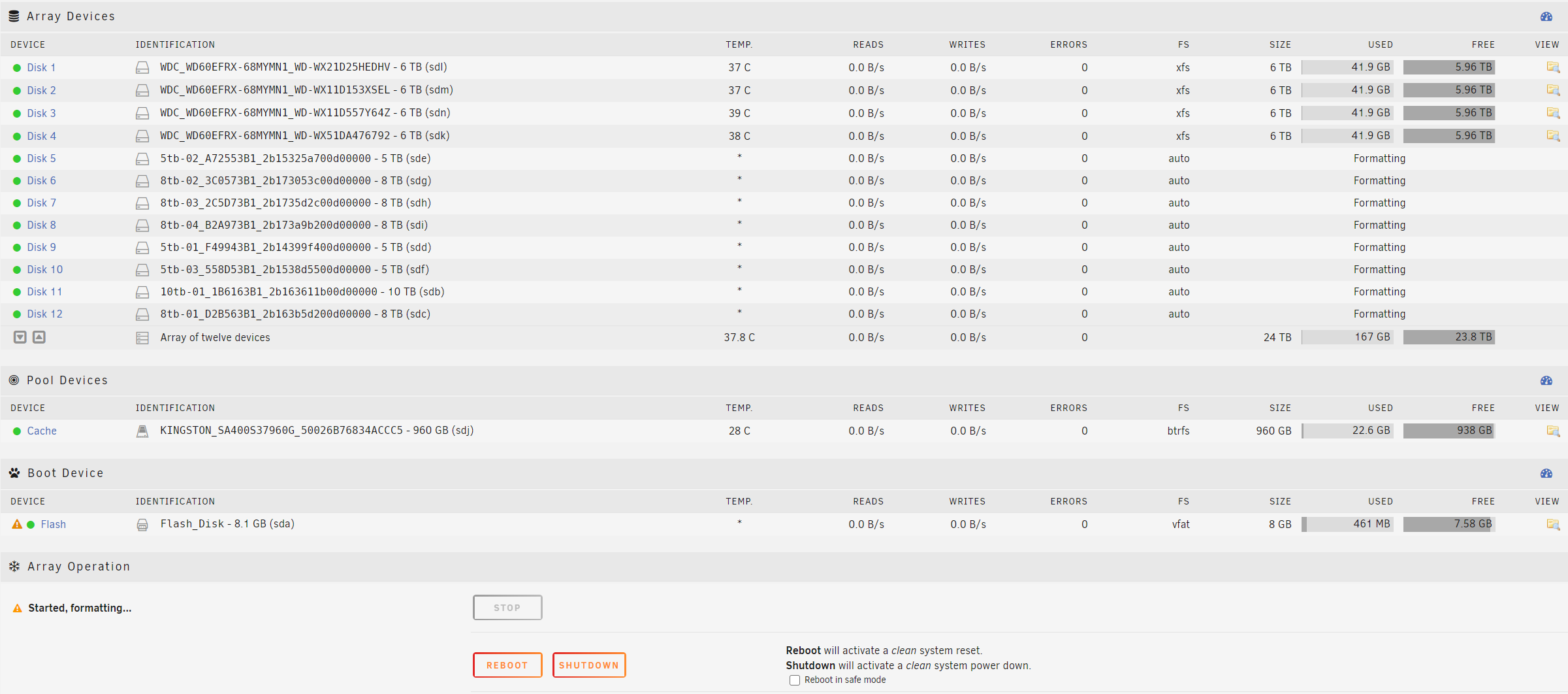

July 11, 20206 yr Author 1 minute ago, johnnie.black said: Adaptec is being correctly detected and the driver loaded, I'm not familiar with that model but if it's a RAID controller you might need to create a raid0 or similar volume for each disk, or it won't present any devices to the OS. The adaptec detects all drives in its utility start before bios. I have created an array with Raid0. Not knowing how the settings should be for catche etc. I have now the raid0 visable in the Array Devices. A huge step forward It is showing as a 20tb drive (array) as the drives have been set to Raid0. I misread your advise, on an Raid0 on each drive. Will try it out now
July 11, 20206 yr Author I have sucessfully loaded all drives in, currently formatting. I see that there is some details that is missing due to the fact, that drives runs trough the controller. However, temperature etc. can be monitored in the controller utility. I will post again, when all drives have been formatted, and put into array. Thanks again for the support @tee-tee jorge
July 11, 20206 yr 57 minutes ago, [email protected] said: I see that there is some details that is missing due to the fact, that drives runs trough the controller. Yep, that's one of the reasons you don't recommend RAID controllers with Unraid, also note that if you change those disks to a different controllers they will likely need to be rebuilt, or at least require a new config.
