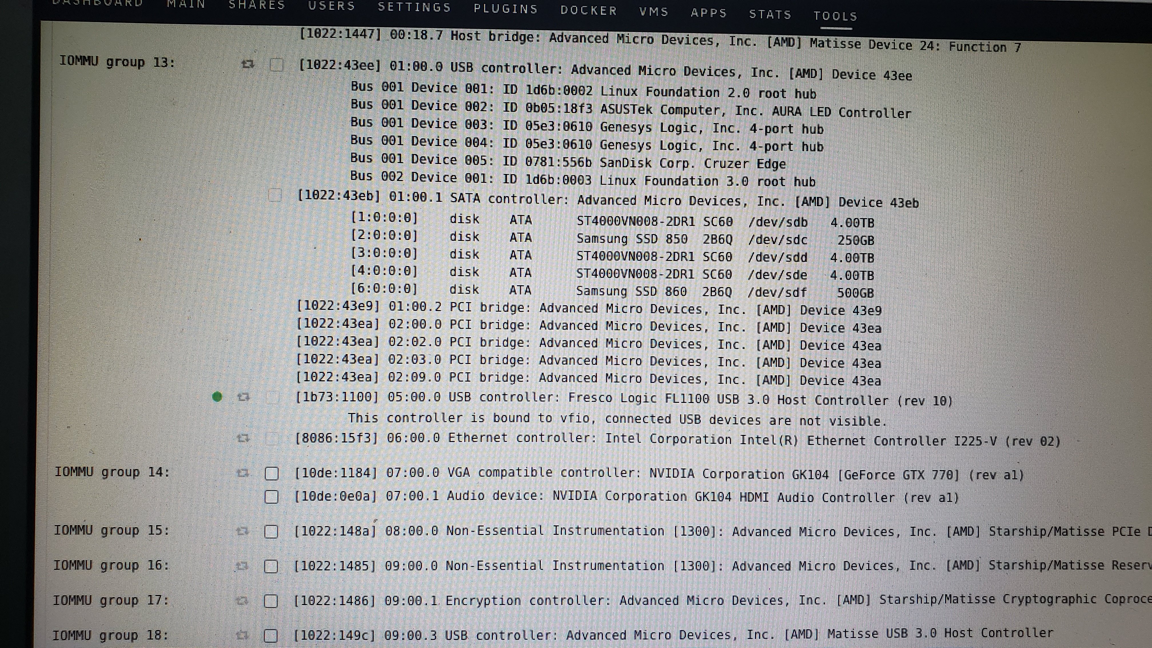

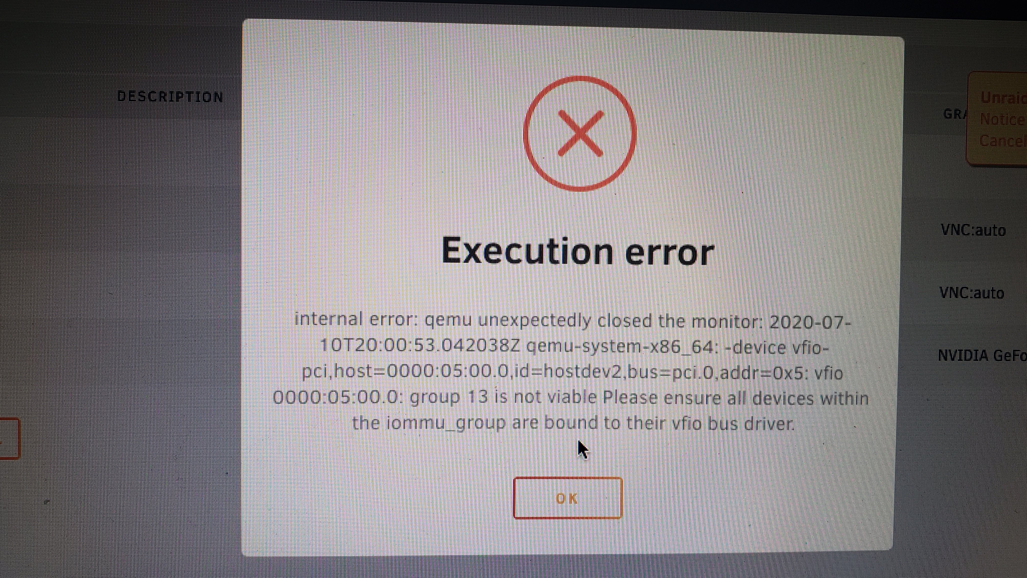

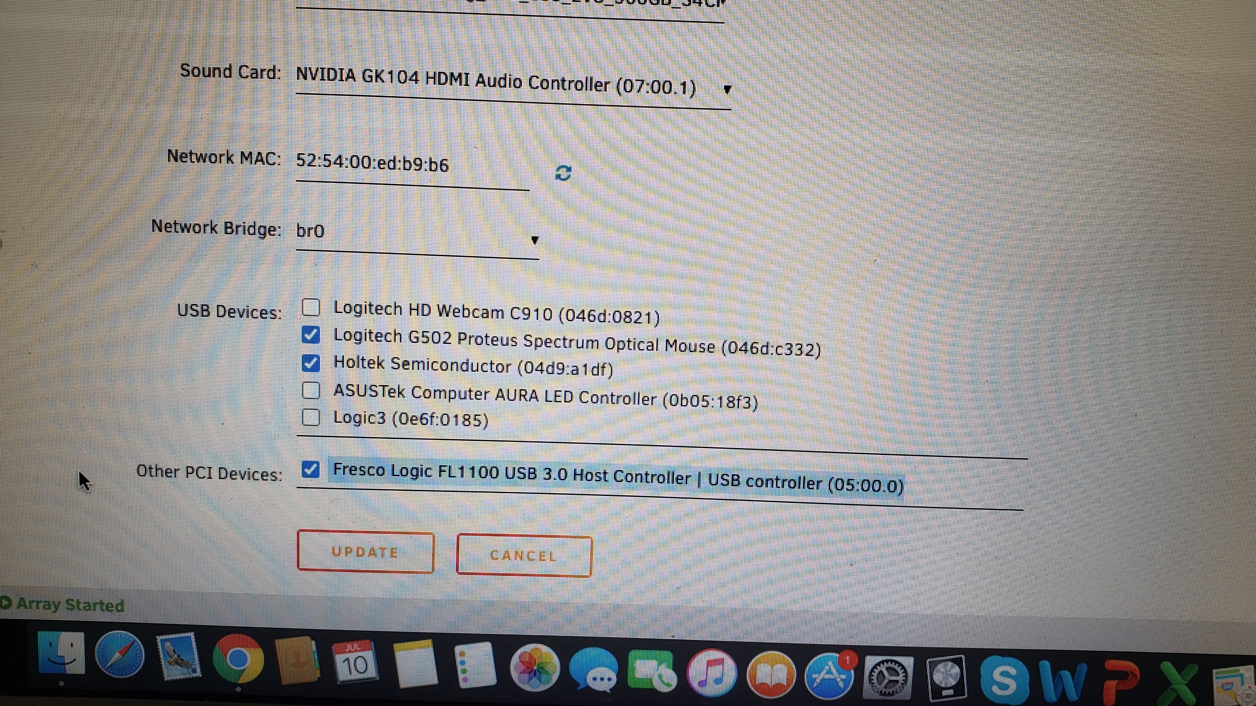

I'm been wrestling with getting my new Ryzen server trying to get VMs working. I have a two-part issue.

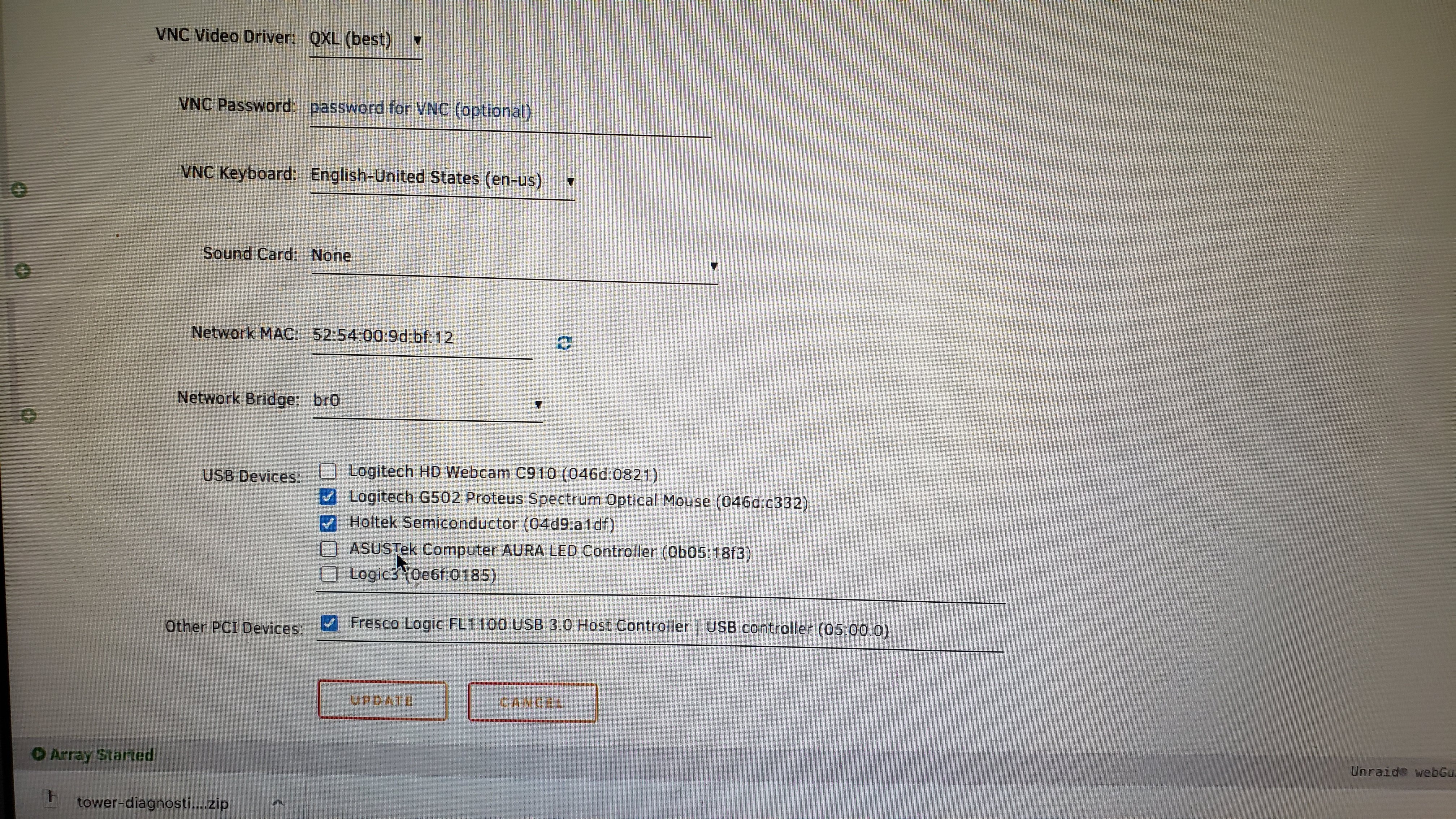

1. I'm having an issue passing through my USB controller "Fresco Logic". When starting my Windows 10 vm, I receive the "Execution error" attached. How do I ungroup the controller from iommu group 13 (see attached)? The vfio APP does not appear in my APPs to separate iommu groups.
2. When I unplug the USB controller I am able to start my Windows 10 VM passing through my Nvidia 770 using a vbios which I downloaded from techpowerup.com. I made sure it was from the same exact gpu and removed the header using a hex editor per Spaceinvader One's instructions. When I boot I get the following graphic glitch with a Windows crash screen. Is this a vbios issue or something else? Thanks
One of the ACS override options in VM settings
To pass through any pcie device, like the USB adapter, it must either be in its on iommu group, or you must pass through all the devices in the group.
ACS override is set to "Disabled"

Choose one of the options, reboot and see what impact it has on your setup. We cannot tell you which to chose as the result will be different for various motherboards.

1. I changed the ACS override to Override and it didn't help I'll keep going down the list.

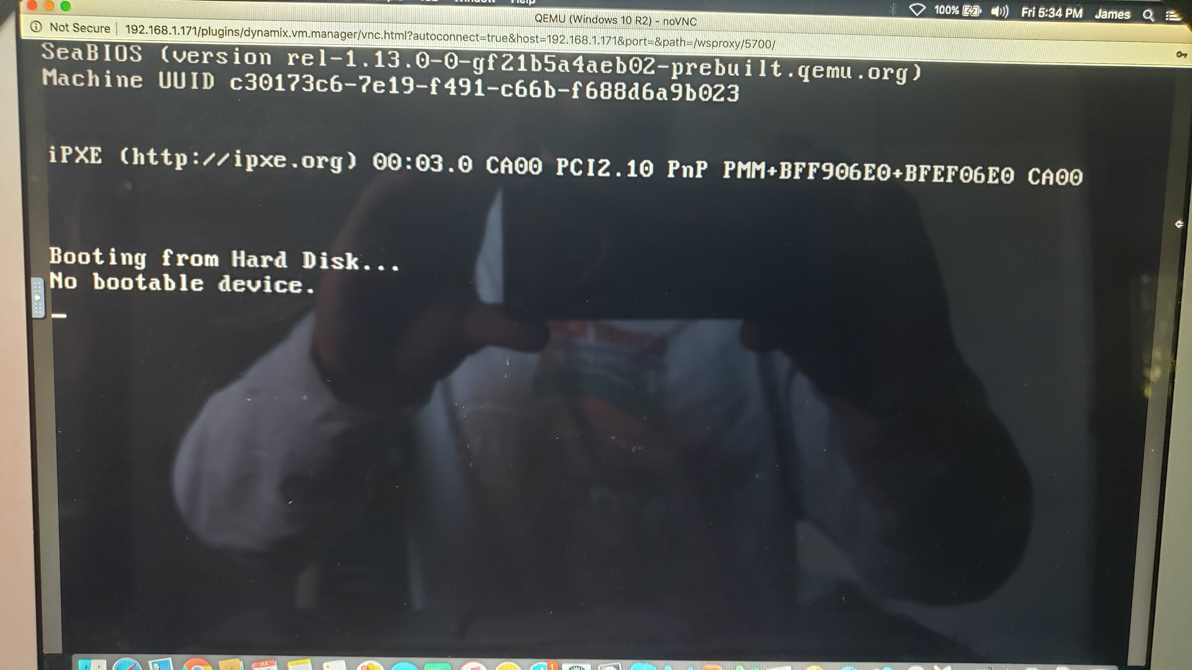

2. I booted with VNC and I'm having the same issue booting. I switched back to my old hardware last week and this Windows 10 VM started fine. Here are some of the VM settings:
 Machine: i440fx-5.0
BIOS: OVMF (This is greyed out. Could it be something I need to change with in my chipset bios?)
You cannot change  the bios for an existing vm. You need to create a new vm with the changed settings. Since you have the same boot issue in vnc, that rules out the gpu as the source of the problem. It’s very difficult to read the specific windows error your encountering,, but if this runs on different hardware, it’s likely something to do with part of your vm config that’s specific to your old system.
starting fresh with a new vm on this new hardware should point you in the right direction.

First off, thanks so much for helping! I solved the iommu grouping by setting ACS Override to Multi-function.

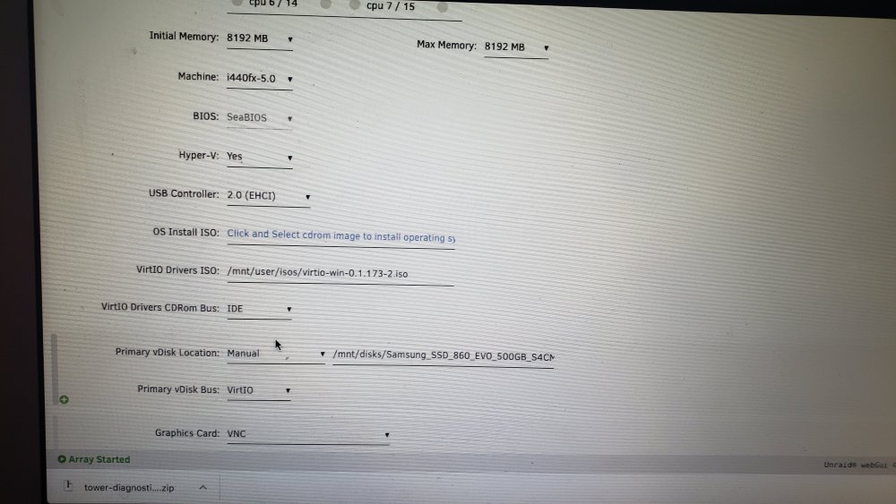

I created a new VM for Win 10 and tried SeaBIOS.. I'm booted with i440fx-5.0 and SeaBios and got the following screen. I'm not sure what needs to change for SeaBIOS to work.

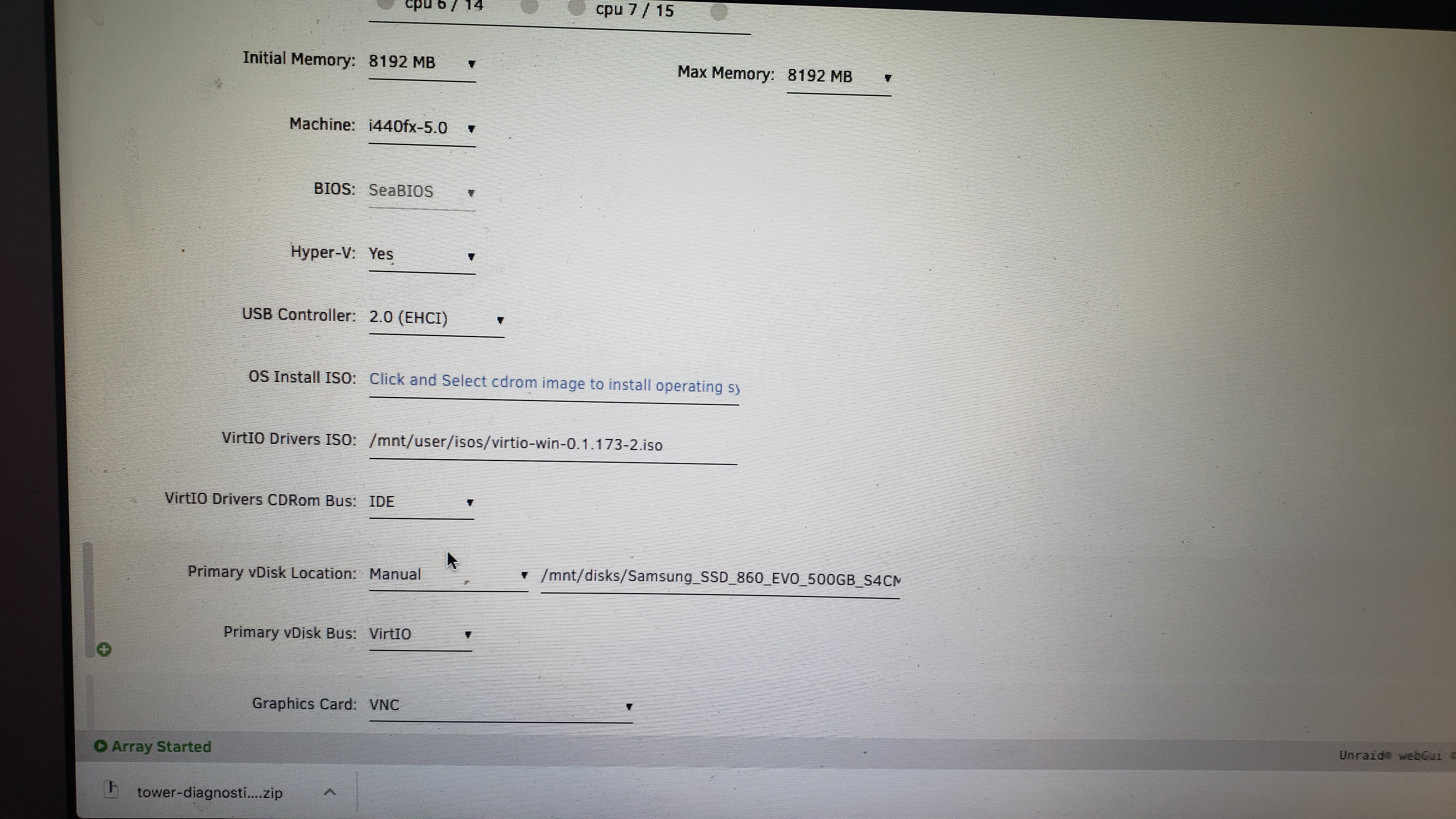

Here are my VM settings...
Great news on the iommu groups!
You don’t have an os install image defined.
as you are setting up the vm afresh, you need to point to an install iso to get the os installed

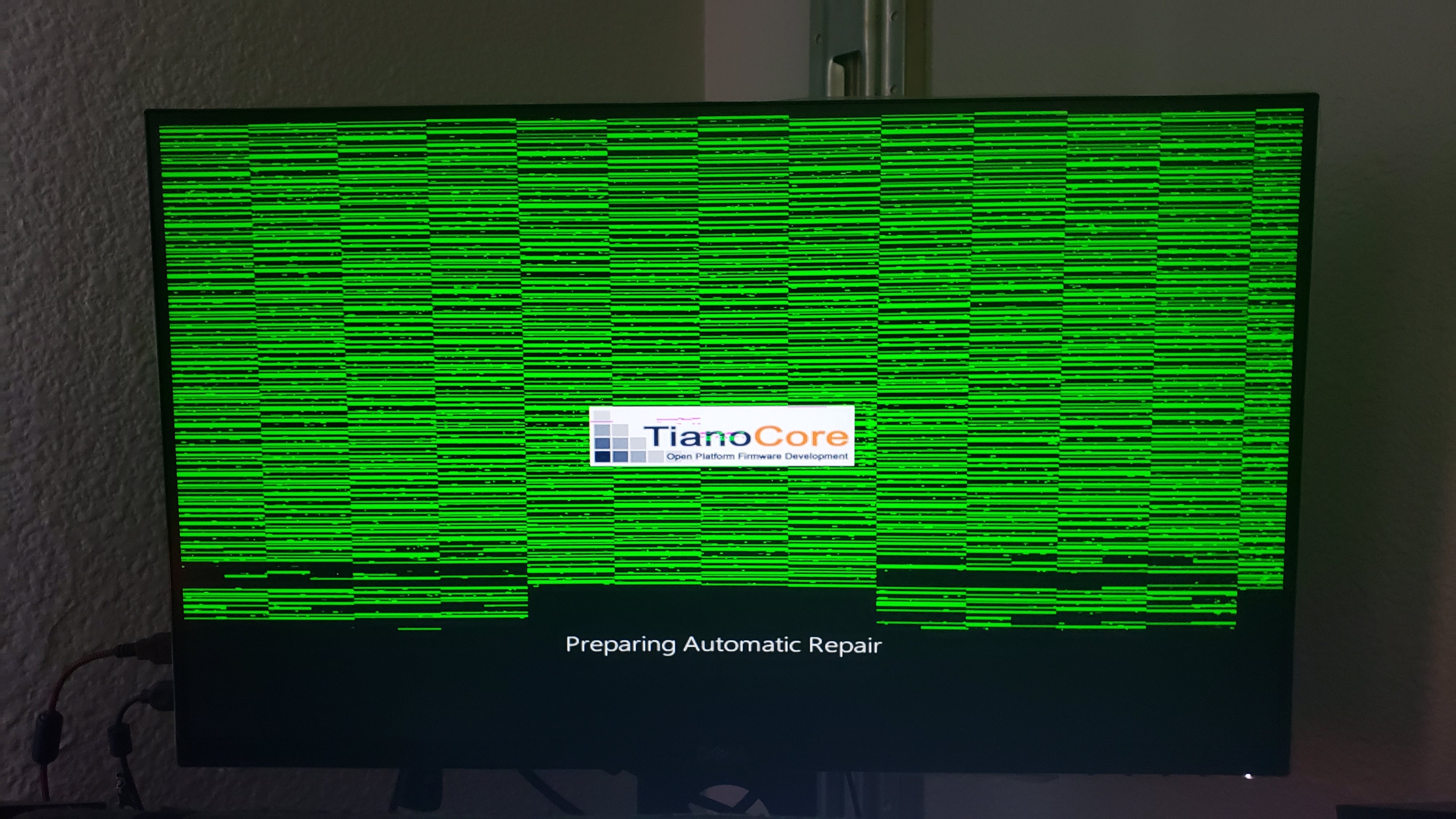

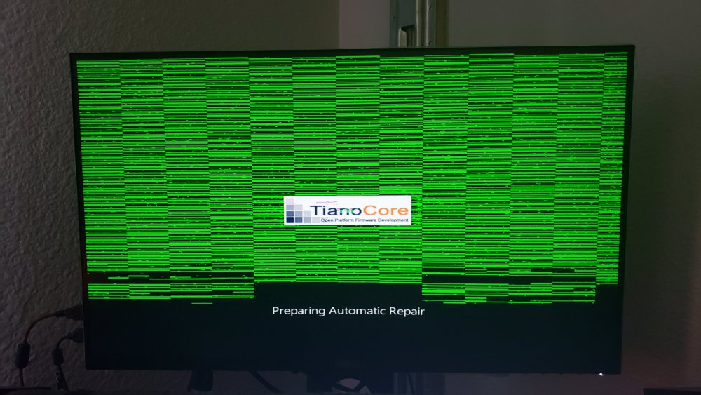

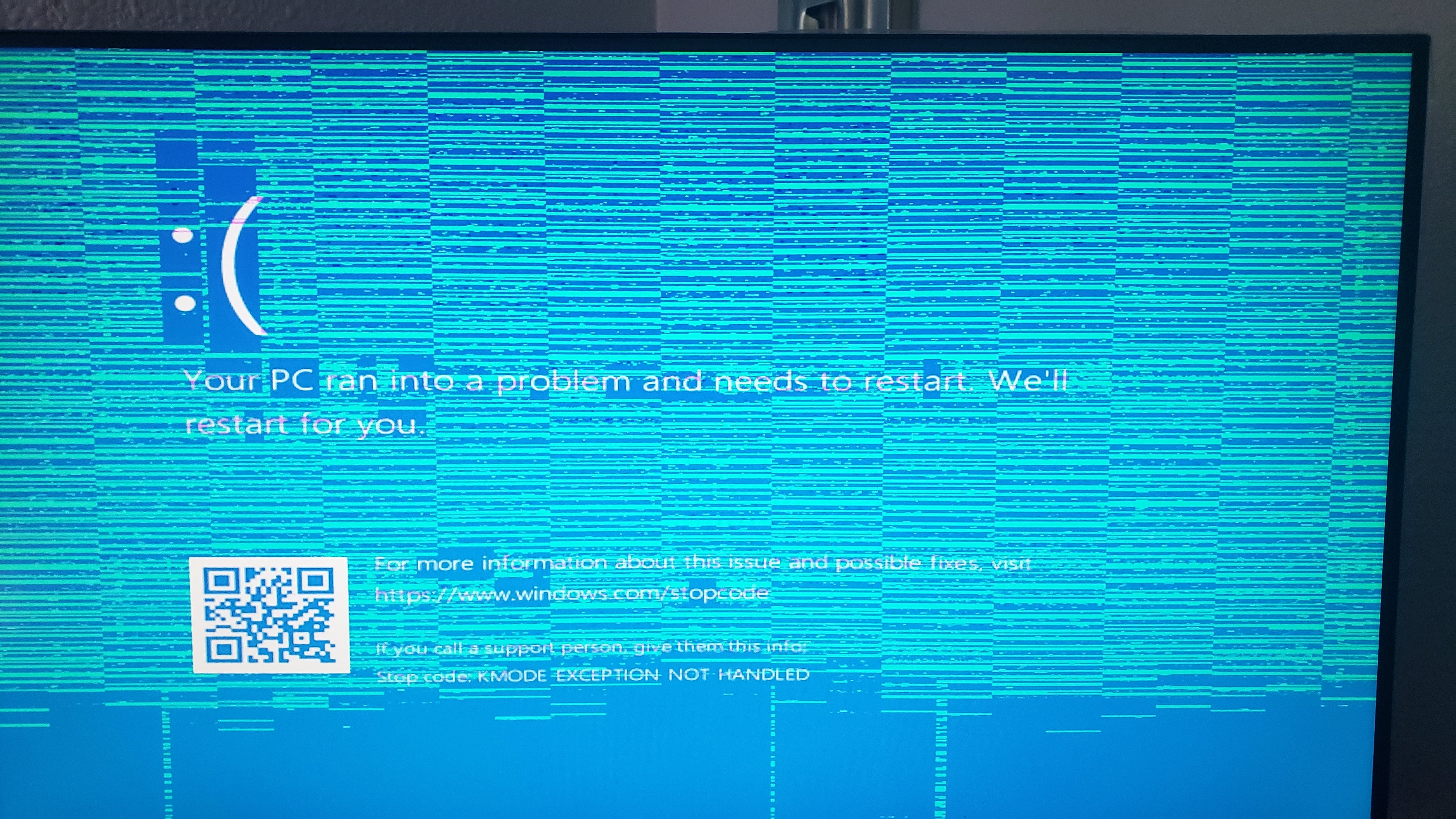

I pointed the VM to the Win iso and it just gives me the Windows blue screen "Your PC ran into a problem and needs to restart. We'll restart for you." It's a constant loop. I've tried using both Q35 and i440.

Also my Fresco Logic USB controller says "This controller is bound to vfio, connected USB devices are not visible." I tested my Linux VM and the mouse and keyboard won't work plugged into this usb controller. I guess I don't really understand the vfio thing.
