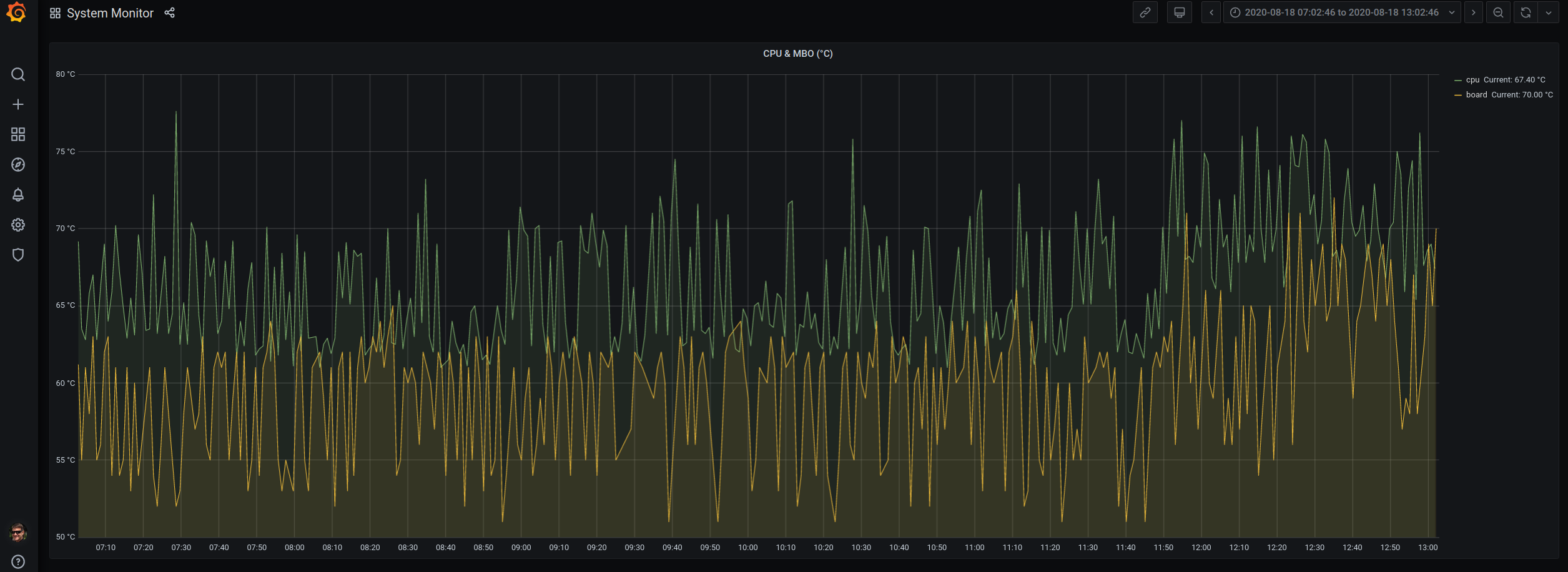

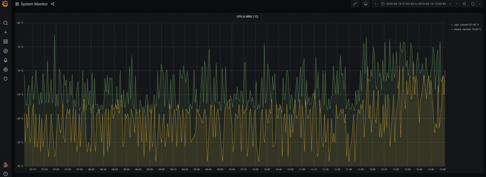

See attached temps snapshot. This is at usual 10 to 15% cpu utilisation.
