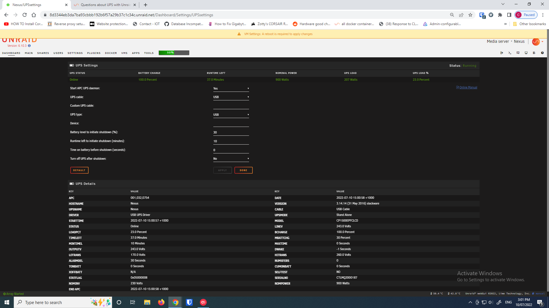

July 10, 20224 yr Hi, just to help out with choice. I've recently installed this: Cyberpower Systems PFC LCD 1500VA Tower UPS with AVR Model: CP1500EPFCLCD Amazon Australia It was a straight forward install, I was expecting a headache. I haven't tested it to shutdown yet, but it kicked in when I pulled the plug out of the wall and unRaid is pulling the status from the UPS fine. Hope that helps. I haven't tried installing software on the Window's VMs to shutdown gracefully yet. Edited July 10, 20224 yr by Geck0
