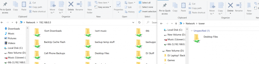

if i type  \\tower     i only get 1 File folder to show up in windows  and it takes time for it to load too (green bar goes across the screen in file explorer slowly)
if i type  \\192.168.0.3    i see all my folders instantly (roughly 20 folders)

Tower (192.168.0.3)   when doing "\\tower"  it only shows 1 of the Share Roots. and only shows 1 file folder inside that Root share
when i do  "\\192.168.0.3" For Tower,  it shows all my Share roots and my other folders in the 1 its only displaying  when i do \\tower

\\192.168.0.3  was almost instant
\\tower  was pretty instant
but you see in the pics  its not displaying properly
tower and 192.168.0.3 are the same server

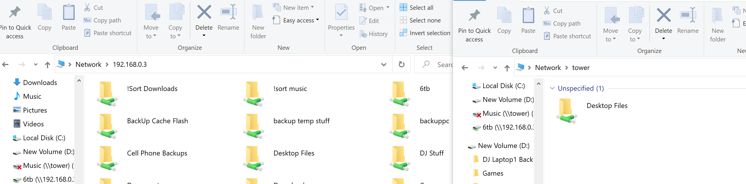

oh and i re tried    \\192.168.0.3    it was quick... . \\tower    was slow and still only displays the 1 share

i  still cant do  \\tower   only 1 share shows up  i cant even get  tower/  (in the browser to work)  which is weird  but 192.168.0.3/  works  but ya cant get damn shares to work doing \\tower  but i can do the other server names  like mitchflix/    backupserver/   in the browser   just not  tower/

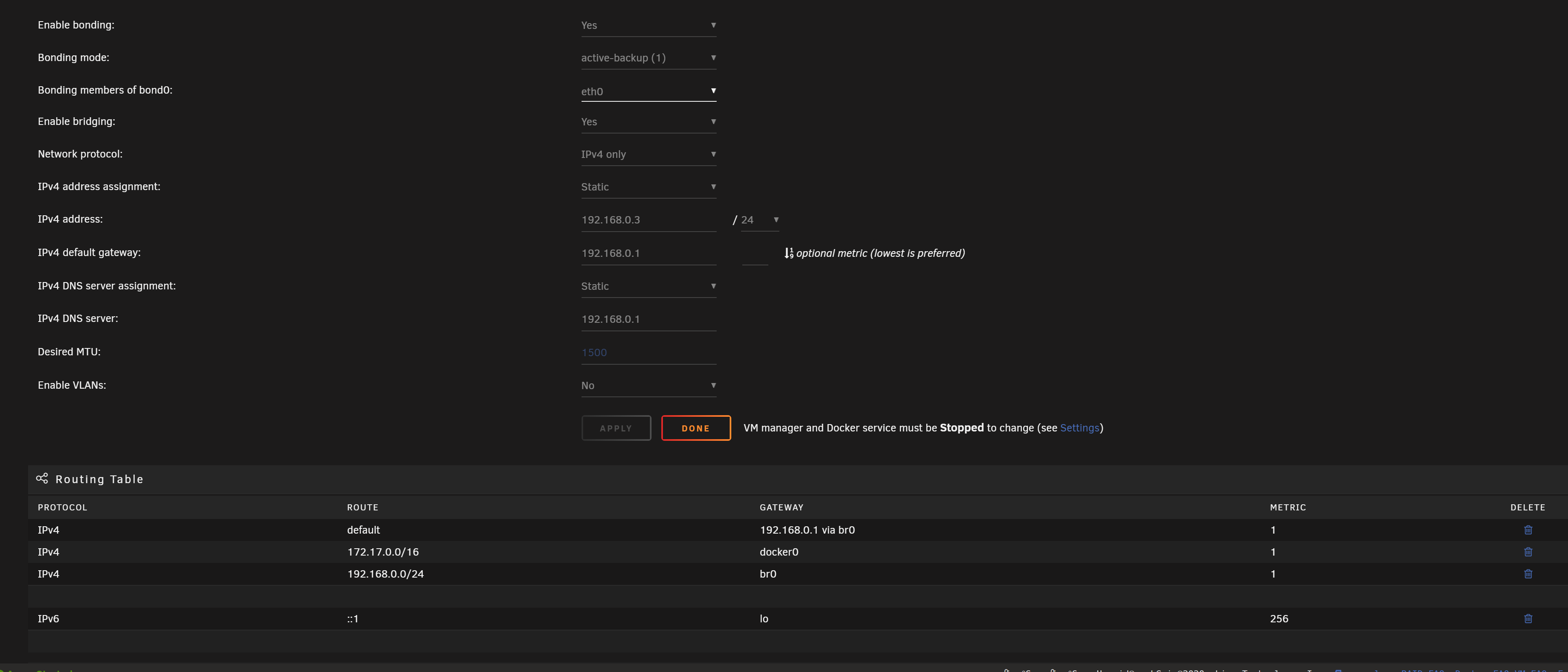

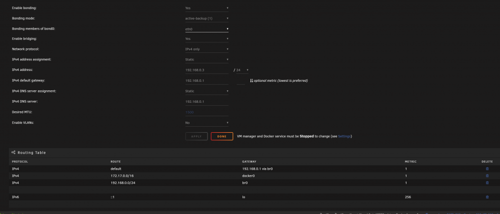

here is my network settings if the diagnostics dont show anything

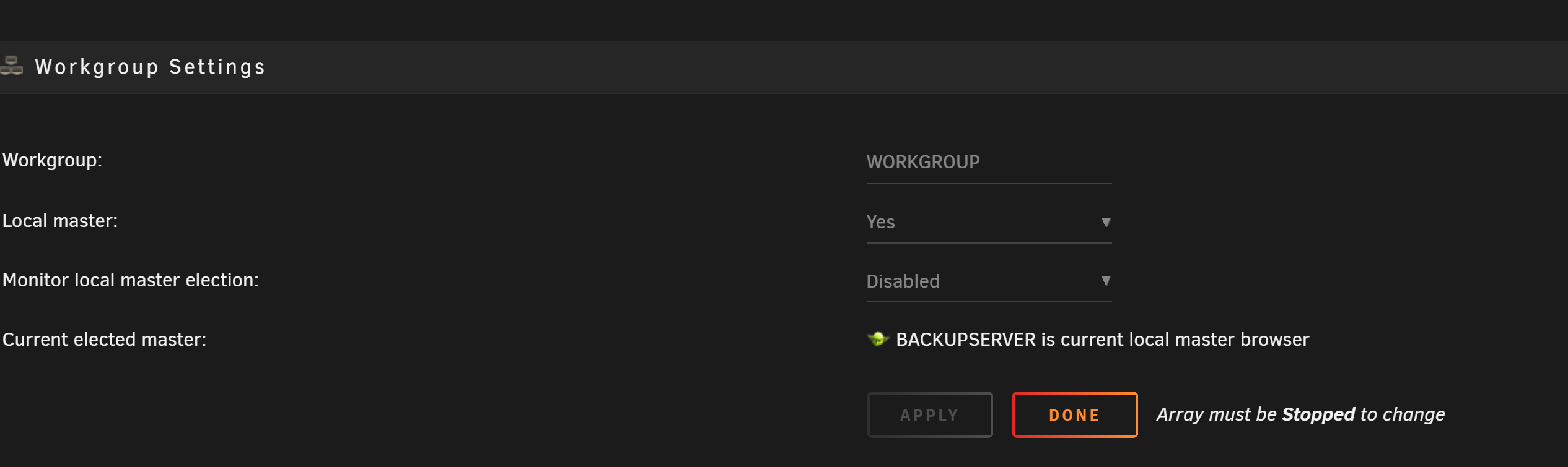

Have you installed the Dynamix Local Master plugin.  If so, what is the name of the computer that is the Local Master.  Settings  >>>  SMB   >>>   Workgroup Settings           It is best if the Local Master is a Unraid server that is on 24-7.
The \\tower is resolved by the Local Master to be \\IP_address.  In other words, the Local Master is the DNS server for the SMB network.

as for the local master plugin  no  never heard of it  but ill try it now.. so why would unraid suddenly stop working like it..   shouldnt  the other 3 unraids have the same problme  ...  but ill try it now  and get back to you
so i installed it  and went to bottom of smb page  its say my backupserver is the master   but how is that possible
this is confusing
and the server is Tower... but you mentioned  the local master is its own dns server... well i use PFsense as a DNS server does that mean its not working right for unraid.. or does unraid have an issue?   as my dns  is 192.168.0.1

still does the what i showed above picture  1 folder for \\tower  everything for \\192.168.0.3  and 192.168.0.3 in browser works  tower/    fails in the browser

soo local master didnt solve it 😞  so what does it actually do in unraid

I just downloaded and checked your Network configuration for this server.  You have set a static IP address for this server.  Just use the IP address in Windows Explorer rather than the server name. If you can't remember the IP Address, setup a shortcut to this server on your desktop.
You can do this by entering the \\IP Address on the Address bar. Hit enter and you will see something like this:
Put your cursor over the IP address (circled), left-click, drag it to the desktop and create a shortcut there by releasing the mouse button.  You can rename the shortcut to anything you want.
By the way, I have used workarounds in the past.  In fact a still have one on my desktop that will get to any of SMB computers on my Network.  (It is a folder with shortcuts in it that were made the same way as I described above.)   I used it when MS did one of their security updates that broke Network Discovery for a while.  I just never removed it because I figure MS will do it again some day...

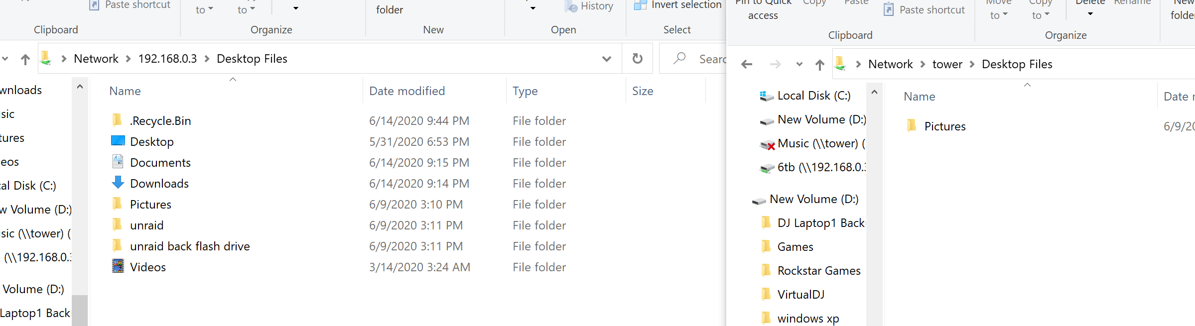

none of them answered why do  "Desktop Shares"  thats on the array  works when the array is stopped
\\tower  shows "Desktop Shares"    and files in it
\\192.168.0.3   shows no shares
i tried looking on cache and Flash drive... why is my array files showing up on share  when Array is stopped

You should have  only     ONE     Local Master on any Unraid server based SMB network!    (You can have more than one Local Master on a MS SMB network if you are running the MS Server software.  You can read about that in one of the links.)
