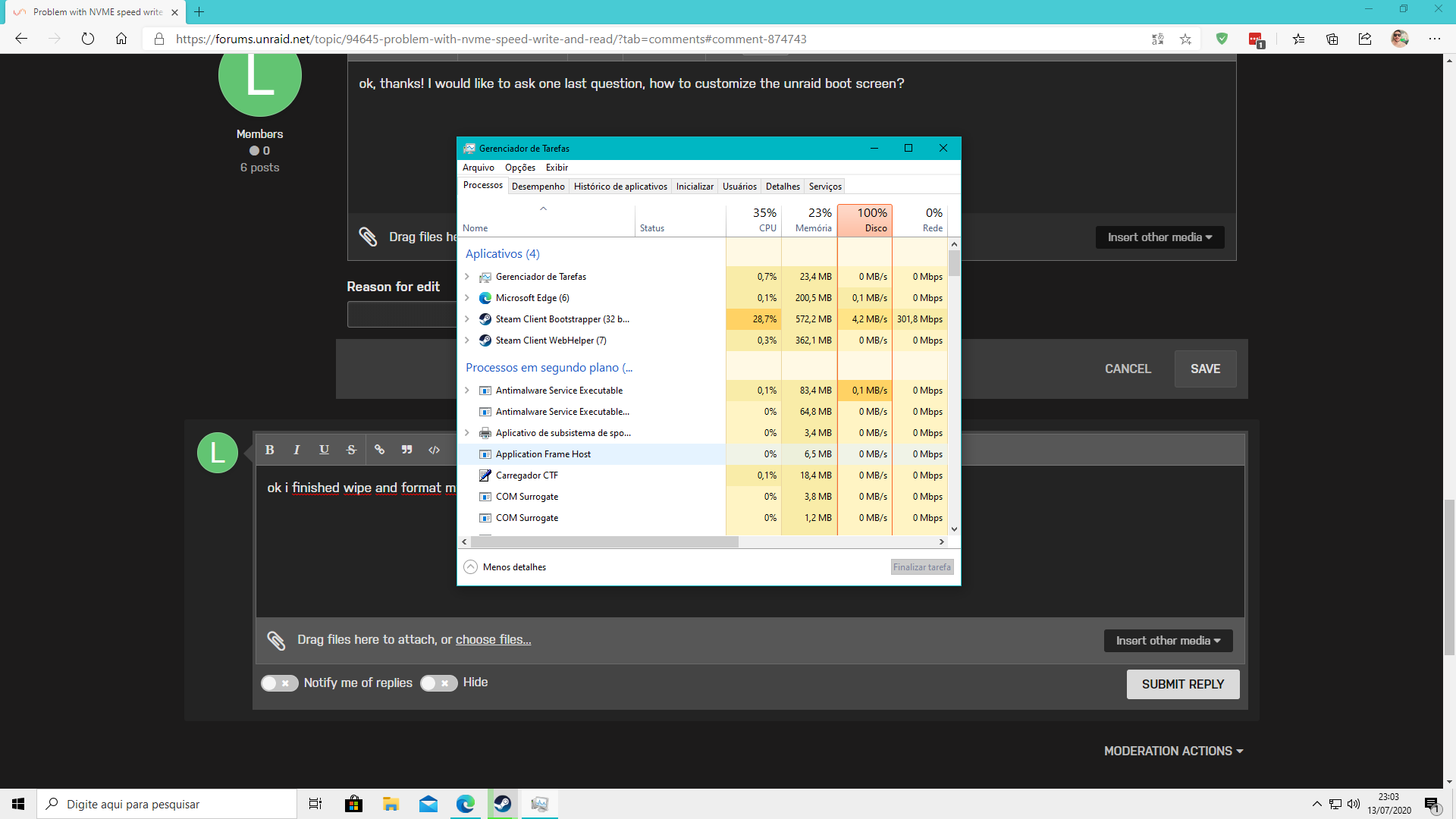

July 14, 20206 yr Author ok i finished wipe and format my nvme, i make a new installation of windows 10 and still a 100% of disk all time
