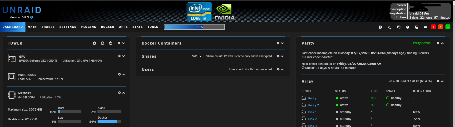

Theme pictured below was created using the "Theme Engine" Plugin. Most of the areas I customized was done in the Custom Styling section with CSS code. Used the original themes as a template to find the CSS areas I wanted to modify. Alot of trial an error for what works)
As far as the logo and loading pics go, they are svg files and are over written when the system reboots. So I used the plugin "User Scripts" to create a script to replace them and have it run "At Startup of Array".  Store the files somewhere in a shared folder and then point to them.

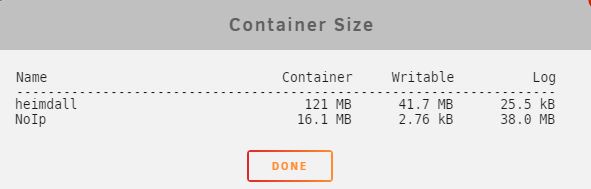

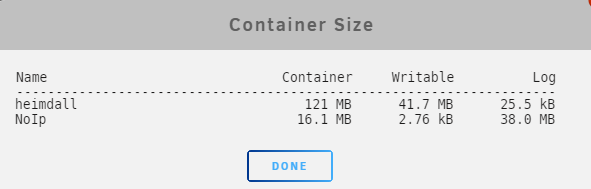

     Popup Windows, the buttons (Such as when you get container size, the done button does not change with other buttons it stays orange)

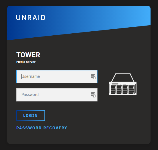

     Login Screen, Would like to change the look there also, Buttons and colors.

So I think I have found all the orange themed stuff and made it blue. Now I just need to update my code and fix some other things. and then it might be ready!
