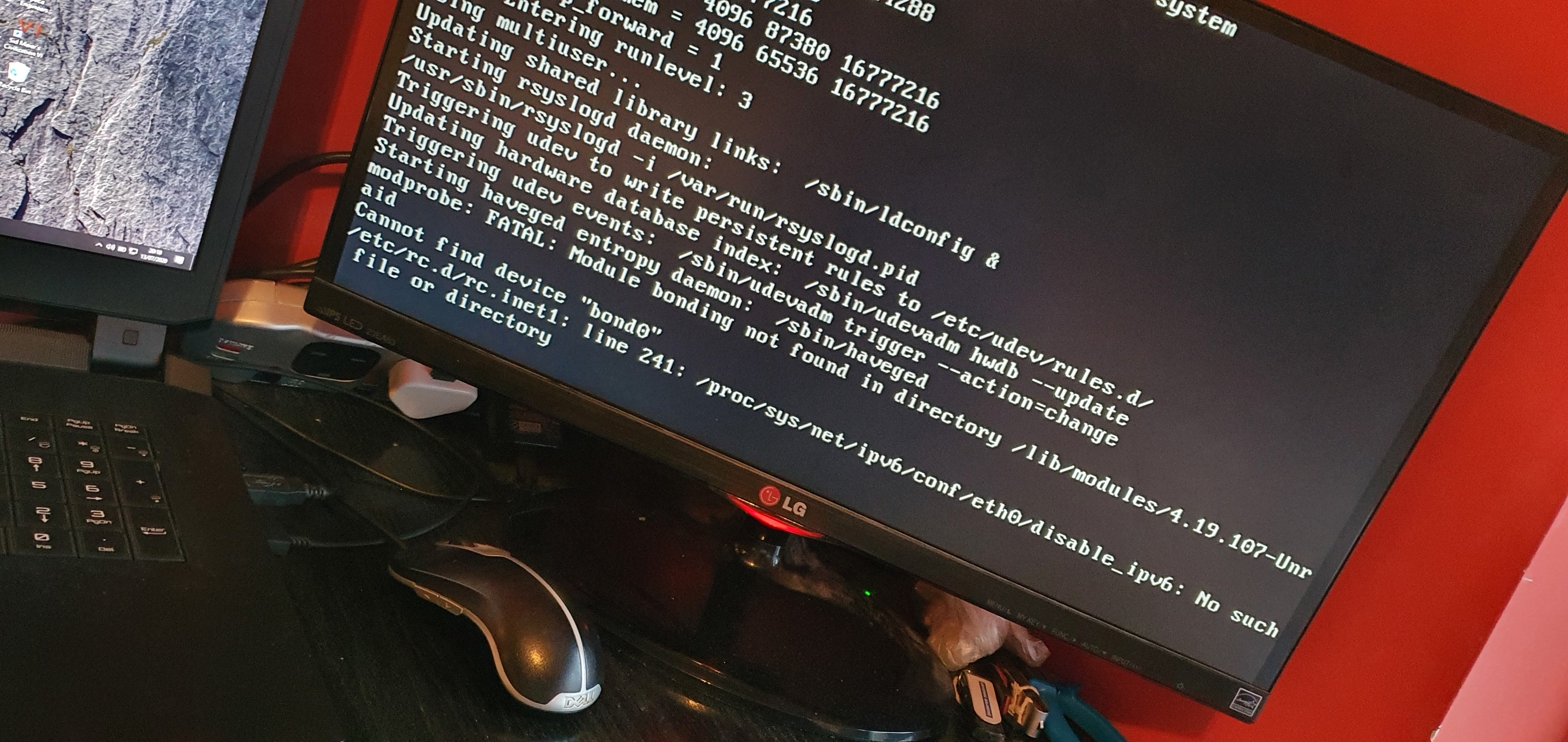

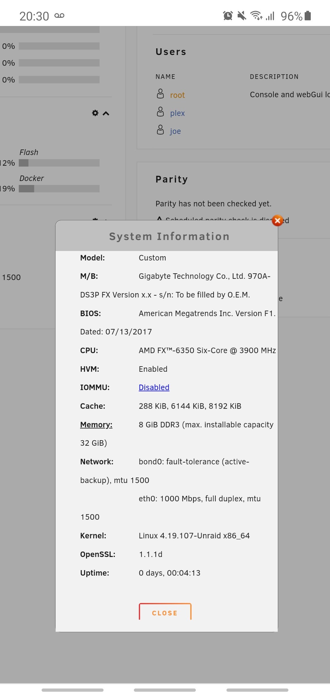

July 13, 20206 yr I need some help, I have my unraid machine fully working and have tested stability by running for 24hrs (I know its not long in but it's for testing purposes) When I enable IOMMU it fails to boot into unraid photo of the only error I can see attached. As with the last issue I had I cannot get unraid to dump a diagnostic file to pull while it's in this state. Screenshot of hardware info screen is attached (this screenshot was taken with IOMMU disabled allowing me to correctly boot. Any suggestions are appreciated.
July 13, 20206 yr Make sure your BIOS is up to date. Also to be aware of is that your processor was released in 2013 and may (or may not) actually have proper IOMMU support that works properly. But, TBH with only 8GB of RAM your ability to run any VMs with passthrough is going to be severely limited anyways.
July 13, 20206 yr Author 2 minutes ago, rachid596 said: do you bind some pci device? do you edit your syslinux.cfg? I didn't change anything between booting it in its stable working form and it not booting atall other than turning IOMMU on in the bios. Everything else was identical.
July 13, 20206 yr Author 24 minutes ago, Squid said: Make sure your BIOS is up to date. Also to be aware of is that your processor was released in 2013 and may (or may not) actually have proper IOMMU support that works properly. But, TBH with only 8GB of RAM your ability to run any VMs with passthrough is going to be severely limited anyways. I will check for a bios update and the 8gb of ram is just what I had laying around to test unraid with I'm still in the 30day trial. All the vm will do is run citrix receiver and plex desktop client on the TV in another room as I have a gaming laptop which I use for everything. Edited July 13, 20206 yr by Joe L
July 13, 20206 yr Author I have confirmed there has not been a bios update since the board was released so that is not the issue. I have not touched any configs but have tried another usb and still failed to boot, I also tried another PCI slot still no luck. Does anyone have any suggestions as to what I can try next?
