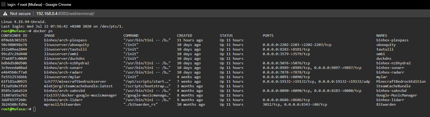

All my containers are running(Docker PS output below) and I can access them but cannot administer any of them through the GUI

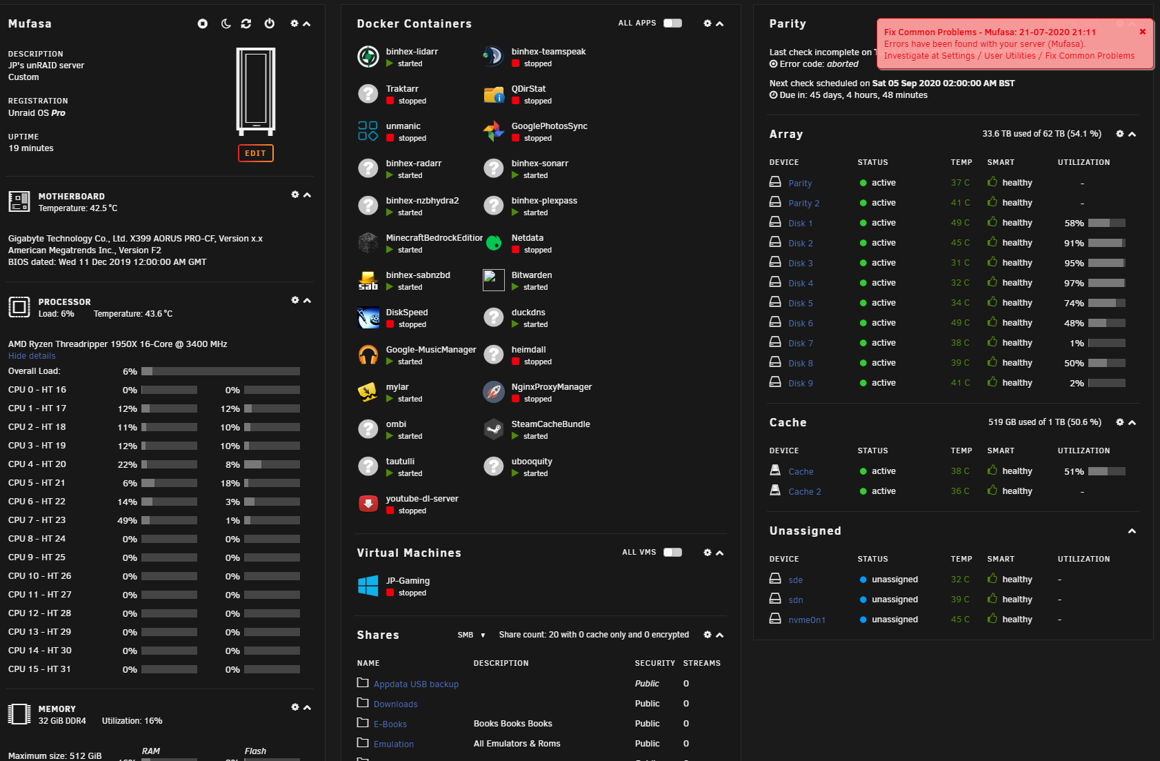

Here are some screenshots.
Diagnostics also attached.

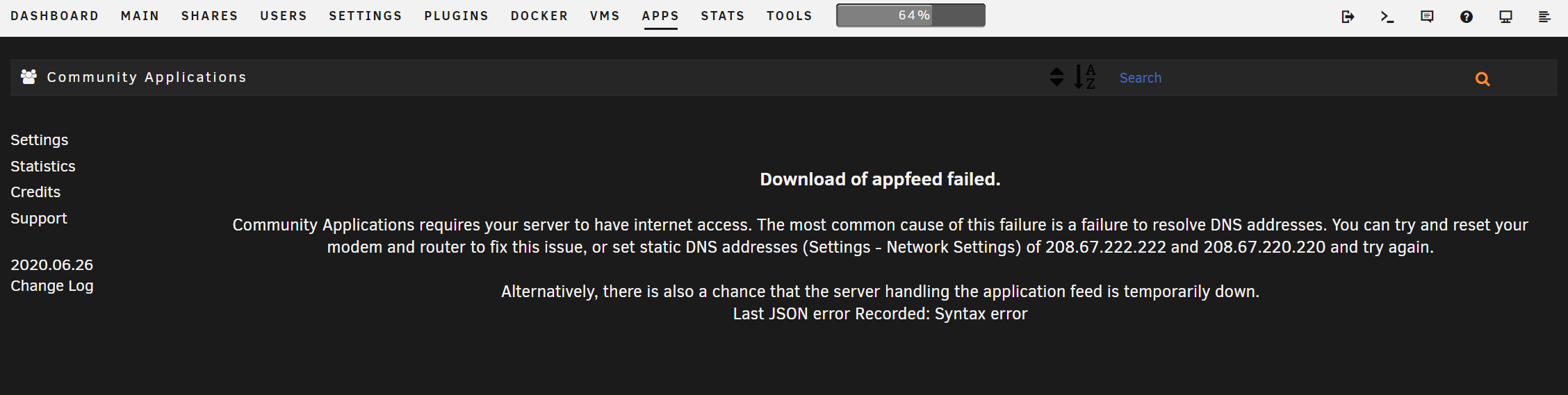

Apps tab showing this.

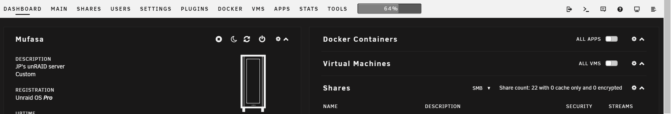

Dashboard not showing containers or VM's

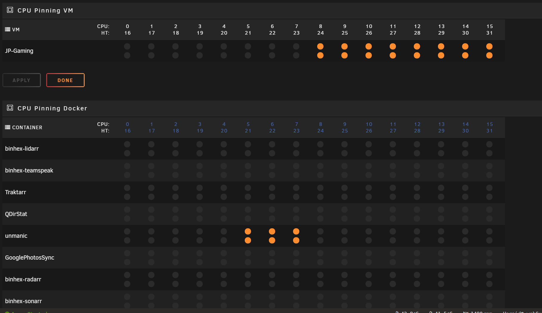

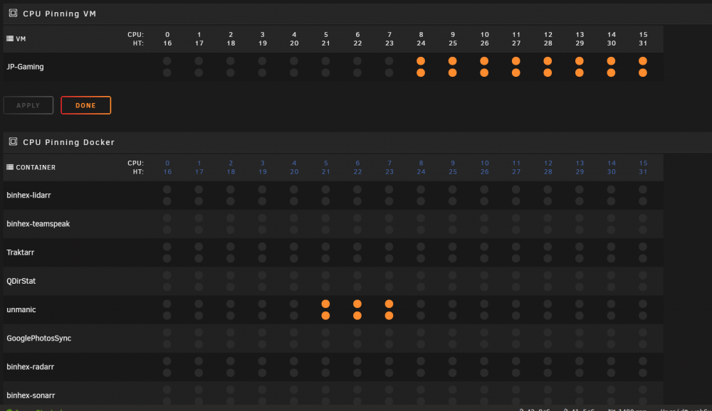

I can see my VM and containers if I go to Settings -> CPU Pinning.

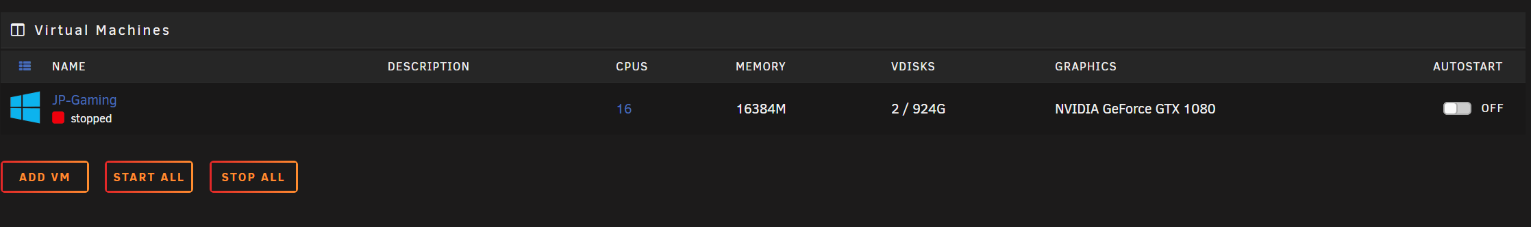

I can see my VM in the VM's tab so it is only missing from the Dashboard screen

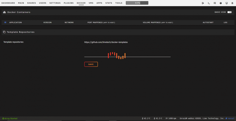

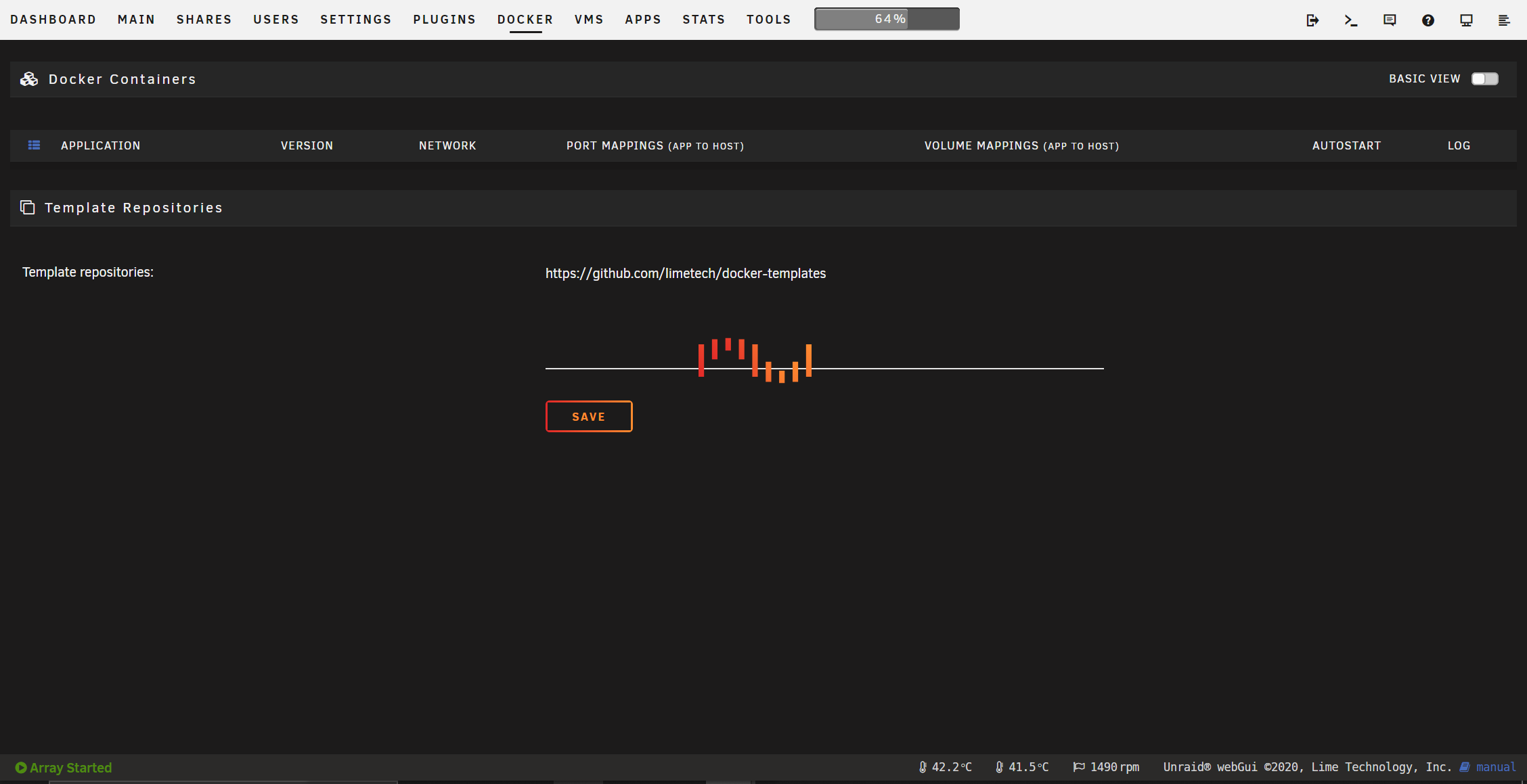

The Docker screen just appears to load but never loads my containers.

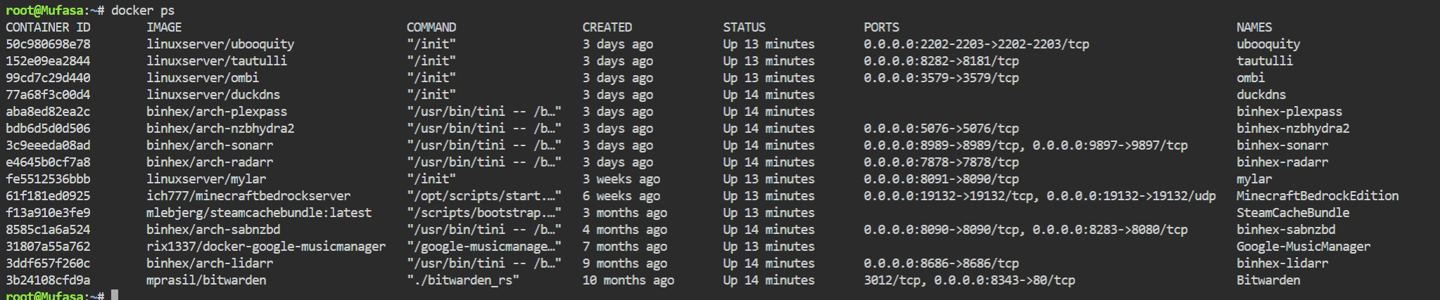

Docker PS output.
Interesting it shows all those containers created 3 days ago. I did click on the docker tab and select update all could that have done it ?

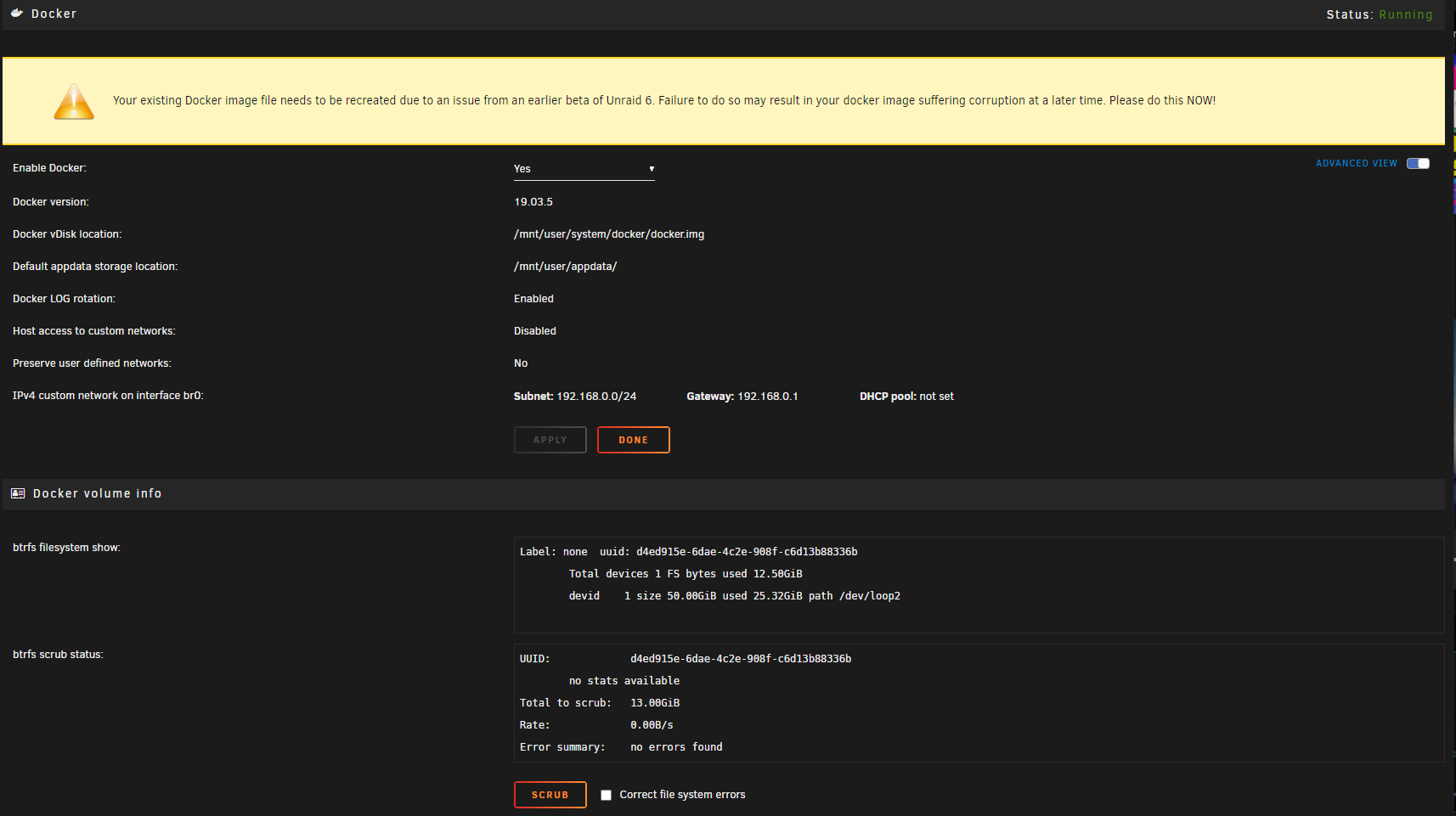

Settings -> Docker is showing this but it has done this for a very long time always ignored it.

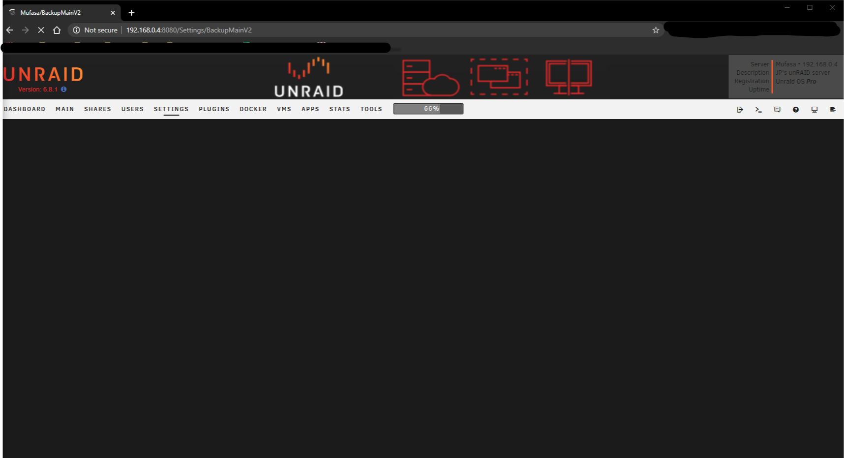

-Backup/restore appdata plugin in settings also does not load it just keeps spinning so cannot rollback the last updates.

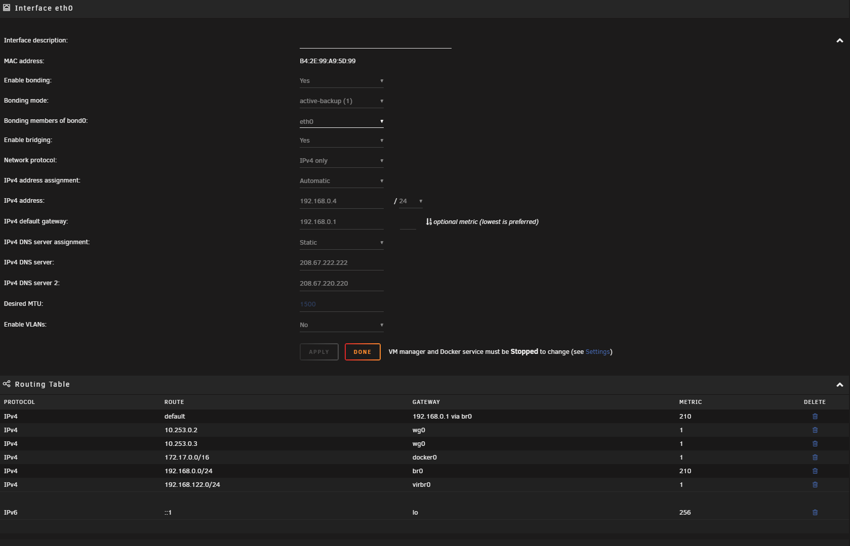

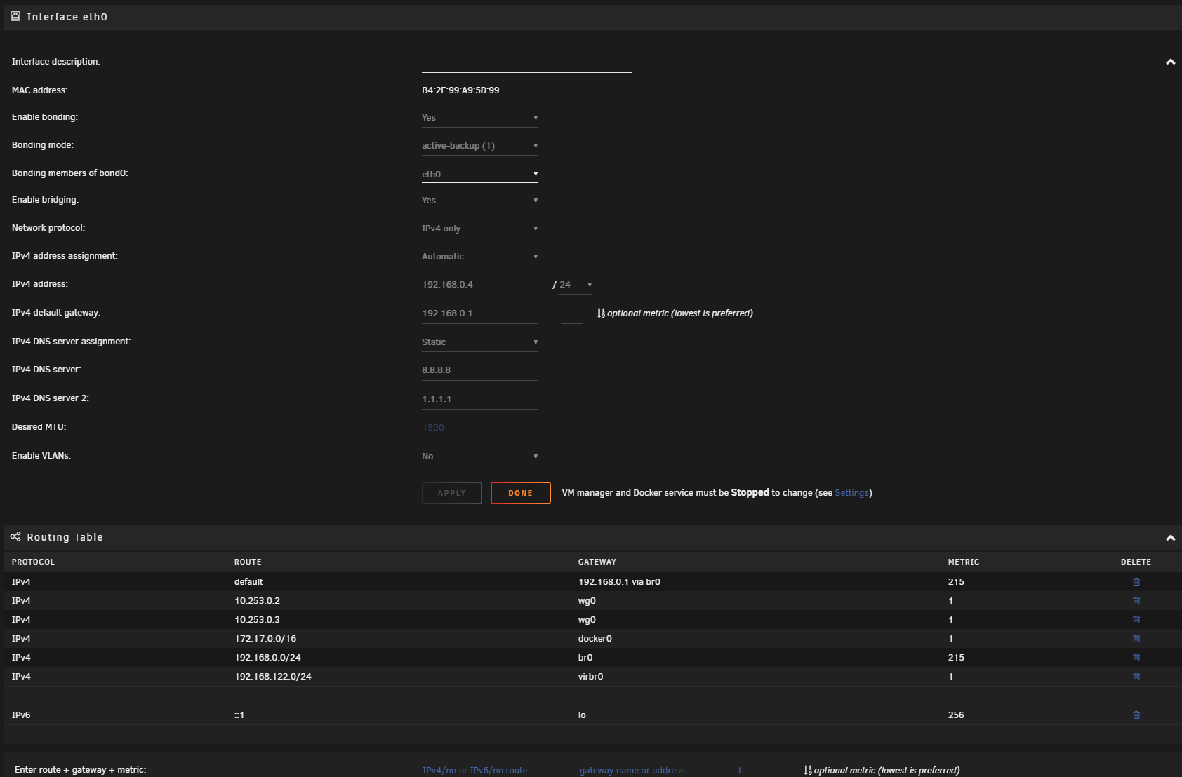

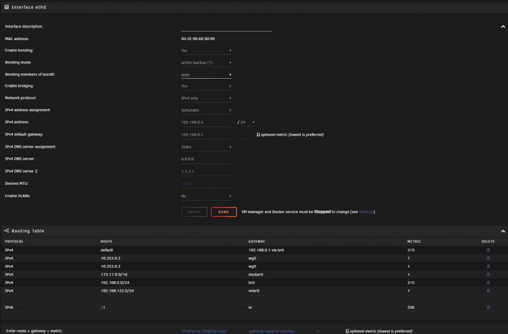

Below is a screenshot of my network settings.
Still broken,

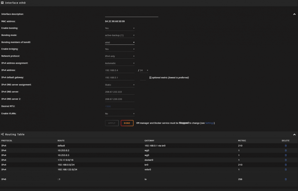

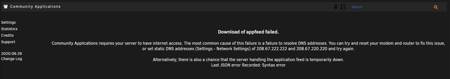

Just tied DNS settings as per the error message on community apps with 208.67.220.220 & 208.67.222.222 made no difference also tried 8.8.8.8, 8.8.4.4. and 1.1.1.1. My download and plex work to the outside world it is only community apps.
Then on the Docker front I still cannot see it on my dashboard or docker tab.

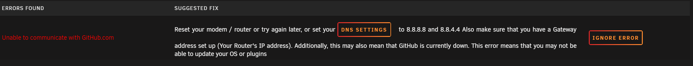

I do get the below within Fix common problems but the fix it suggests does not work.
Suggestions ?

This morning I tried to see if my appdata backup/restore plugin will work to restore my containers once I delete the doker.img as community apps is not working for me and also discoved that this plugin is not loading for me ?
Trying to access it through settings -> backup/restore appdata
Most likely a moo point as my appdata is fine I need the containers installing again after deleting the .img file and for that I will need community apps unless I script it ?

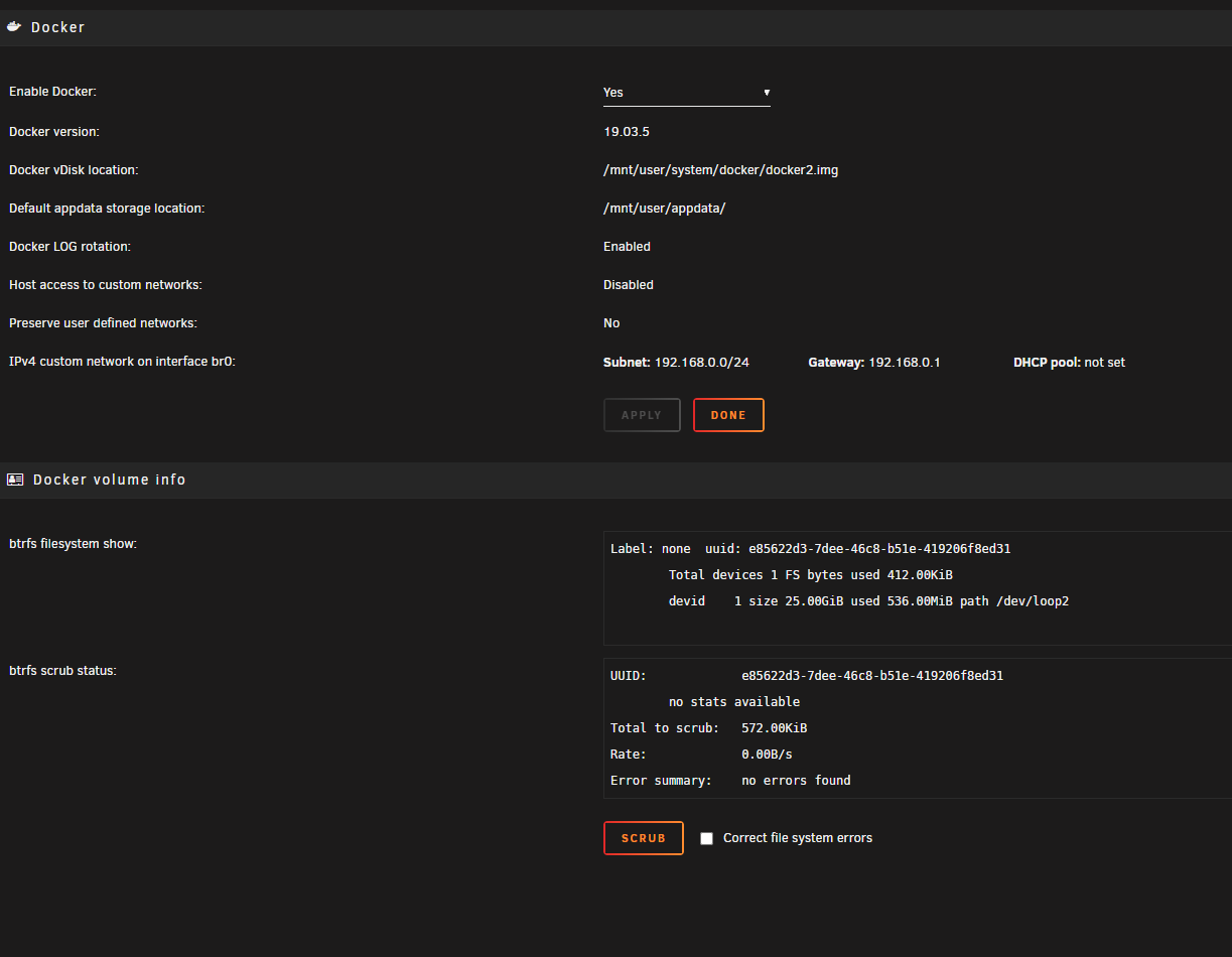

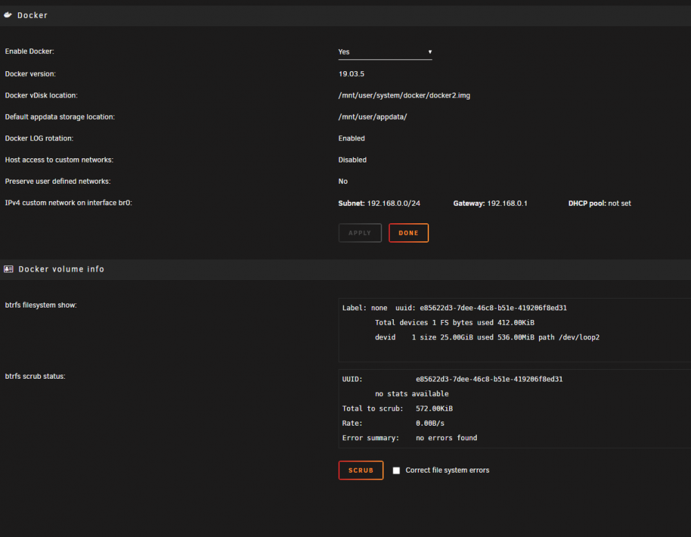

  • Created a new Docker image "Docker2.img" photo below
  • with the new docker image I have access to my dockers again but when trying to load a docker from the templated i get a failure every time see photo below. No errors in the logs assume it is "network"

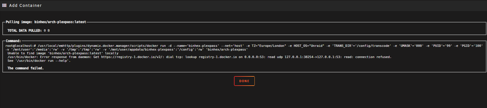

The error I get now when trying to pull a image after

Was happy to see my containers and VM again.
Clicked on apps but still nothing. Went back to Dashboard and nothing loaded.
So left it
Then left it some more and it came back.

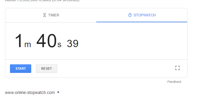

Then decided to run it on a stopwatch to see how long it takes.
And as you can see below. When I refresh my browser it takes 1 minute 40 seconds for it to load my containers in my dashboard.
Any reason for this ?
Because you have quite a number of containers that have the default "?" icon.  When loading the dashboard / docker tab, the system will attempt to try and download the icons.  This is the delay that you're seeing, since it keeps on failing.  Once it succeeds, there will never be a significant delay

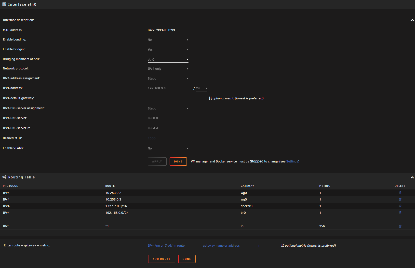

Played with network settings a bit,
use static IP everything is back to normal (speed) but still no apps, docker tab loads instantly Not sure why as I do have a reservation against the MAC address.
Putting the default gateway in makes it really slow again. Taking it out with a static IP makes it error instantly.
No matter what DNS address I put it does not make any difference.
Rebooted the router and then unRAID with static IP, No gateway & 1.1.1.1 as my DNS.
Community applications now show this.image.thumb.png.f0534da74e58122c000a5d60d416f58d.png
This is with a static IP, No default gateway and 1.1.1.1 as my DNS.
Server cannot ping anything on the network not even my router.
All docker containers and VM has internet access just not the host OS.

I'm a little confused on one of your updates from earlier.  You say you created a new docker image called docker2.img and then you say this:

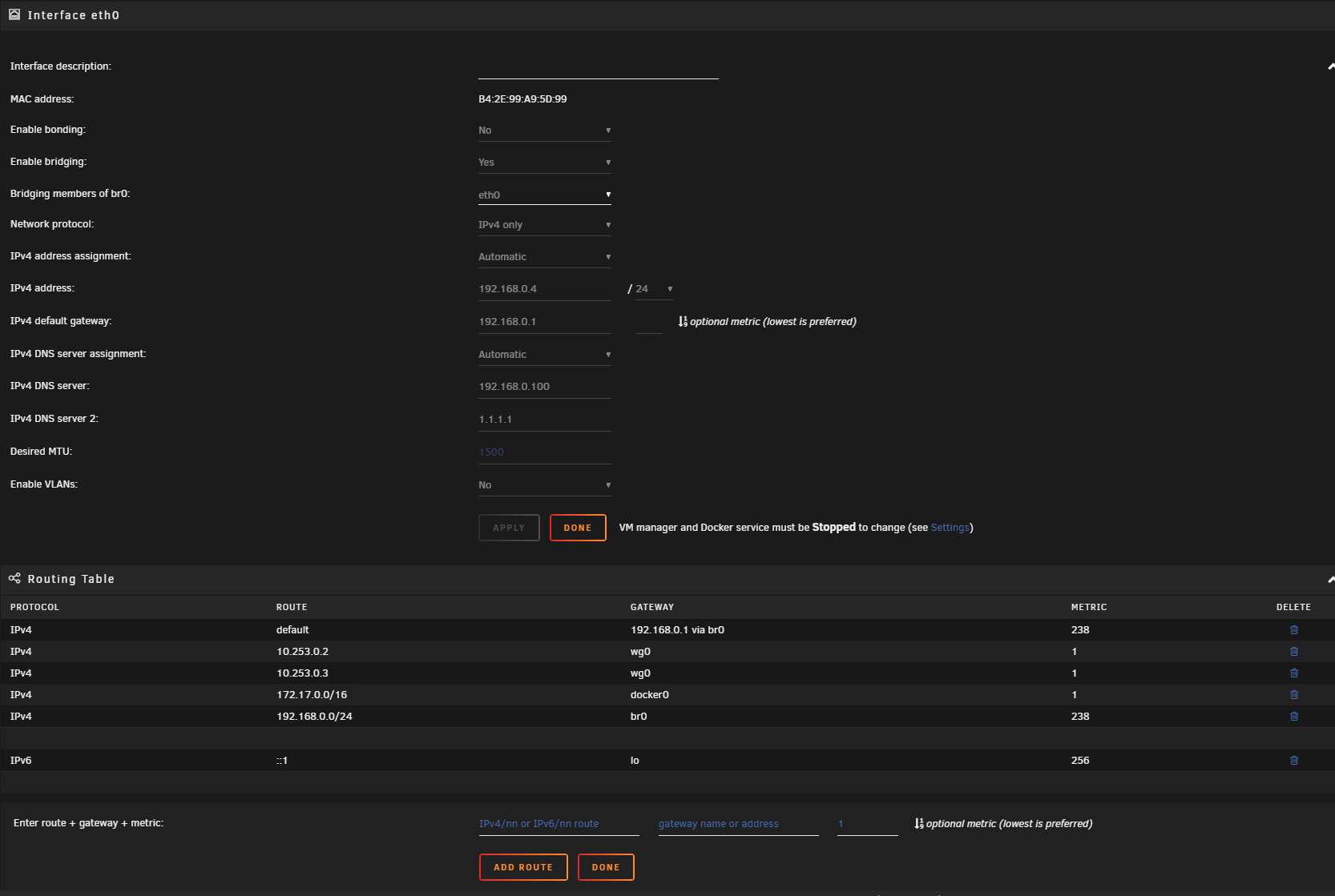

On the Network side I found out that changing the network settings to static without a default gateway gives me the response from the GUI
I would expect but still not working just the long loads are gone. If i put it to automatic or even put a default gateway in I am back to
waiting ages for dockers to appear on the dashboard.
I took your advise and stopped the array then turned off the docker service to test.
made no difference.
Below is a screenshot of my network settings. It is vanilla as I deleted the network config and rebooted Yesterday for the 4th time.
All I have done here is set the DNS servers and IP address.
Everything has internet but the Host OS.
Cannot ping anything from the server.
What else can I do please ?
