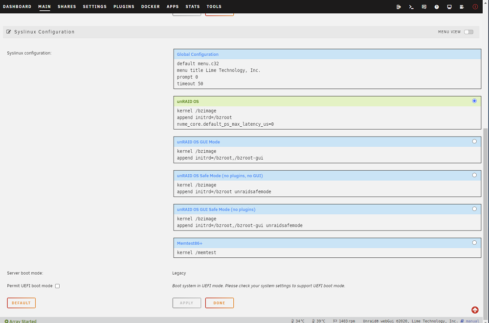

Some NVMe devices have issues with power states on Linux, try this, on the main GUI page click on flash, scroll down to "Syslinux Configuration", make sure it's set to "menu view" (on the top right) and add this to your default boot option, after "append"
nvme_core.default_ps_max_latency_us=0
Reboot and see if it makes a difference.

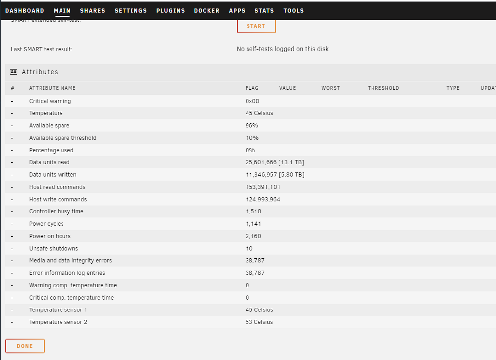

Should I be concerned with this:
"EDAC sbridge: Failed to register device with error -19." ?  Also wondering if the cache media and data integrity errors are an issue?

12 hours ago, mikela said:
I added this to the right location.
No, it's after append and before initrd, like so:
That should be harmless.
Thanks for the clarification!
Here is the diagnostic file.  Does this look OK?

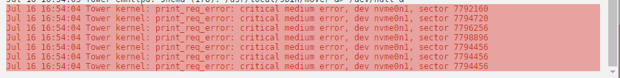

Given my concern about the SSD, I tried to copy files over using the "Replace A Cache Drive" instructions.  I was able to copy everything off the server to a separate hard drive with the exception of my "Windows 10" (vdisk1.img) which is 75.2 GB.  I got this error for that file.
Not sure if my Windows 10 VM is recoverable at this point or what my next steps should be?  Here is the full diagnostic file.
tower-diagnostics-20200716-1707.zip
Edited by mikela
That suggests there could be a real problem with the NVMe device, try the copy again, if you get the same errors probably not much more you can do, you can try reformatting the device but any more similar errors probably best to replace it.
