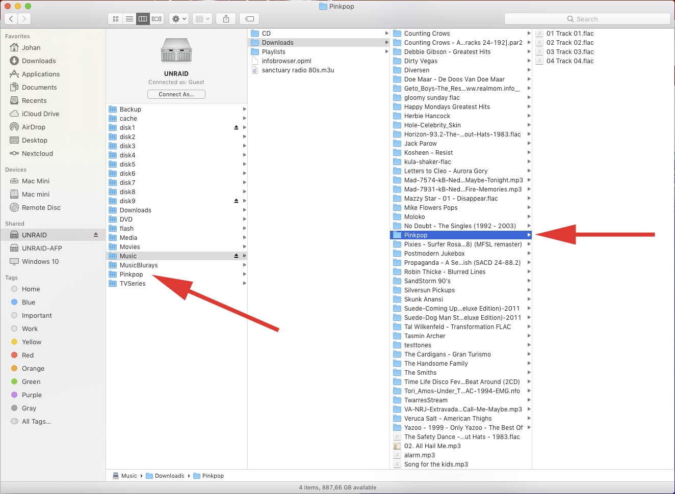

It happened again. I created a new folder inside my /mnt/disk1/music/downloads folder (where 'Music' is an actual unraid share on disk1), named 'pinkpop', copied some files to it, and the folder shows up in osx and windows as an empty (!) user share... i checked all disks, it is not by mistake created on any disk's root so unraid will see it as a new share, it only exists inside the /mnt/disk1/music/downloads folder...
I know i'm not running the most recent version of unraid (mine is 6.5.3, when 6.9.2 is out i will update) but surely this should not happen?
Is this because i have AFP enabled on unraid? I've read that this is obsolete in newer versions? I have it enabled to access my timemachine folder on an unraid disk...

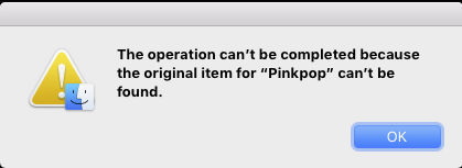

I've chmod-ded the 4 files to 777, they don't show up in the Finder; if i click on the network share (the left arrow that is) i get an error (below). The files do show up if i go to the actual location /mnt/disk1/music/download/pinkpop (or the user share /mnt/user/music/download/pinkpop).
But the share that isn't a share, doesn't contain anything and returns a fault. Also in windows.
