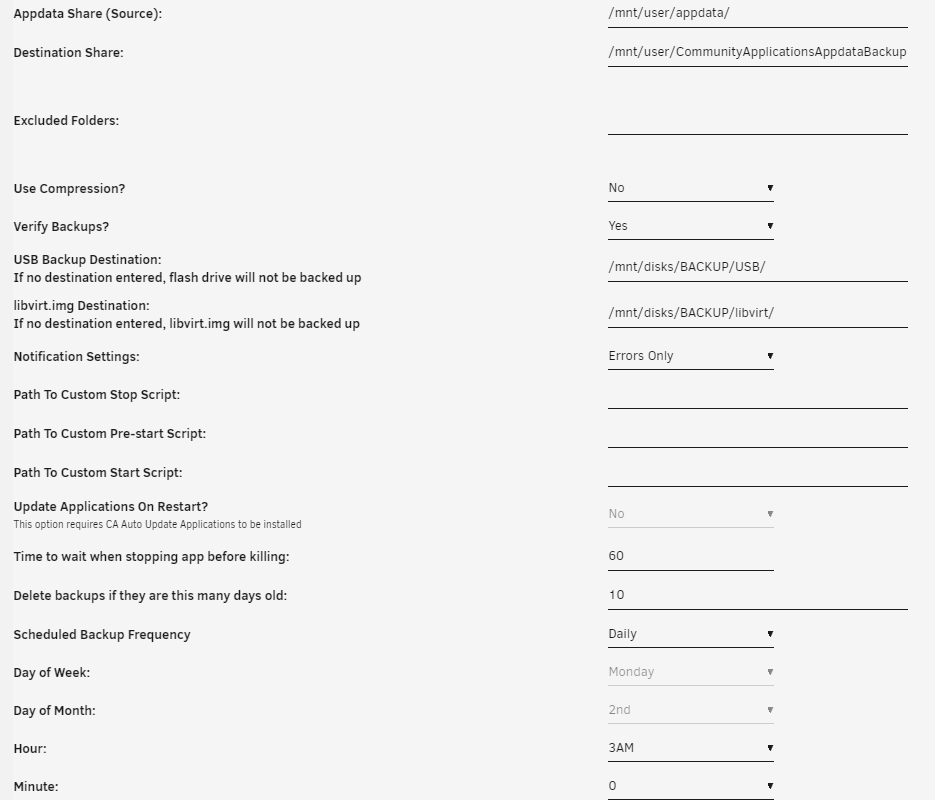

I haven't changed any config since the initial setup. The backup I restored was from the 14th. I've attached my config for CA Backup.
I may just move on, and if it happens again try and get the diagnostics right away unless you've got other suggestions/thoughts on the matter.
Thanks for your help looking into this!
