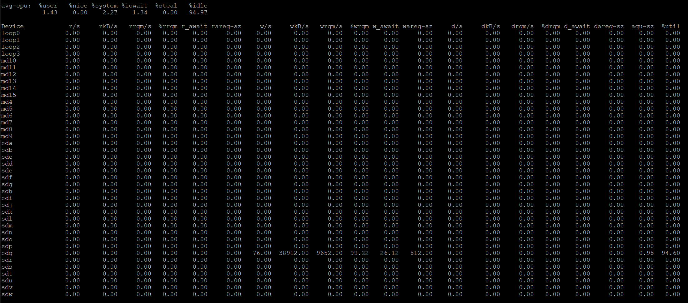

Digging into iostat details, it looks like unraid is using write size of 512 instead of 4k, which is likely slowing this down significantly (I assume the drive internally does a read-modify-write to emulate 512B writes to a 4k physical sector?).

You're likely right, I misinterpreted the output of iostat and came to the wrong conclusion. 'write request size' is listed in kB, writes are just being buffered to 512kB chunks before written. Unlikely to have anything to do with drive block size.

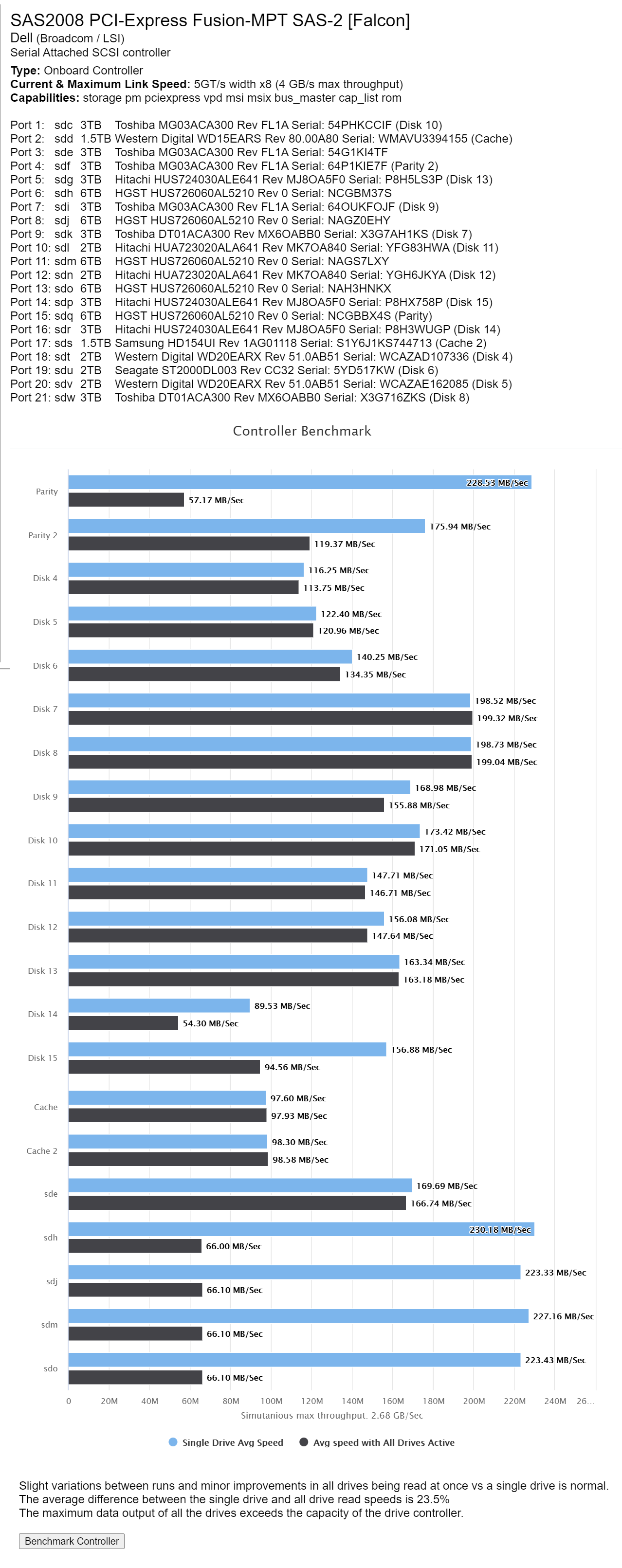

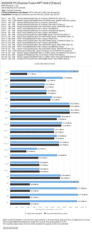

"routine writes" to the array (non-cache, tested with dd) with the new 6tb drive installed go at about 40MB/sec, regardless of RMW or 'turbo write' mode.  The new drives are all 6TB SAS, and individually perform great.  Something odd showed up when testing with the diskspeed plugin, which shows that when all drives are in use -- the new 6TB SAS ones consistently take a much bigger perf hit than the legacy SATA's (when if anything I'd expect them to be faster; and alone they are faster)
Diags and diskspeed results attached
Writeback Cache is:   Disabled
