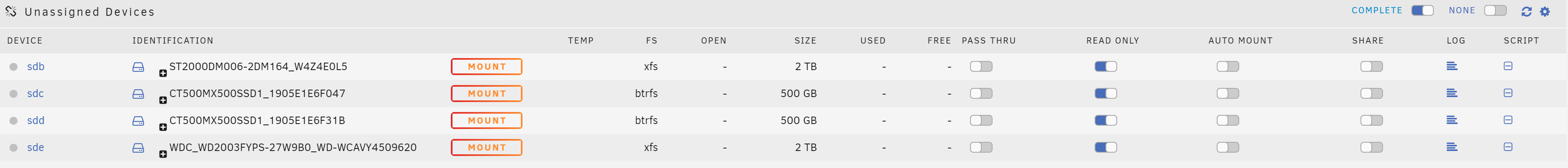

I have now got UD running on the new flash drive and everything appears 'mountable' in UD. Should I just try to mount the spinning disks from the array with the read only flag set to see which one won't mount? Any risk with that?
I tried mounting the spinning disks read only and both mounted, so now I don't know what to do. Any advice on how to figure out my assignments in this situation?
