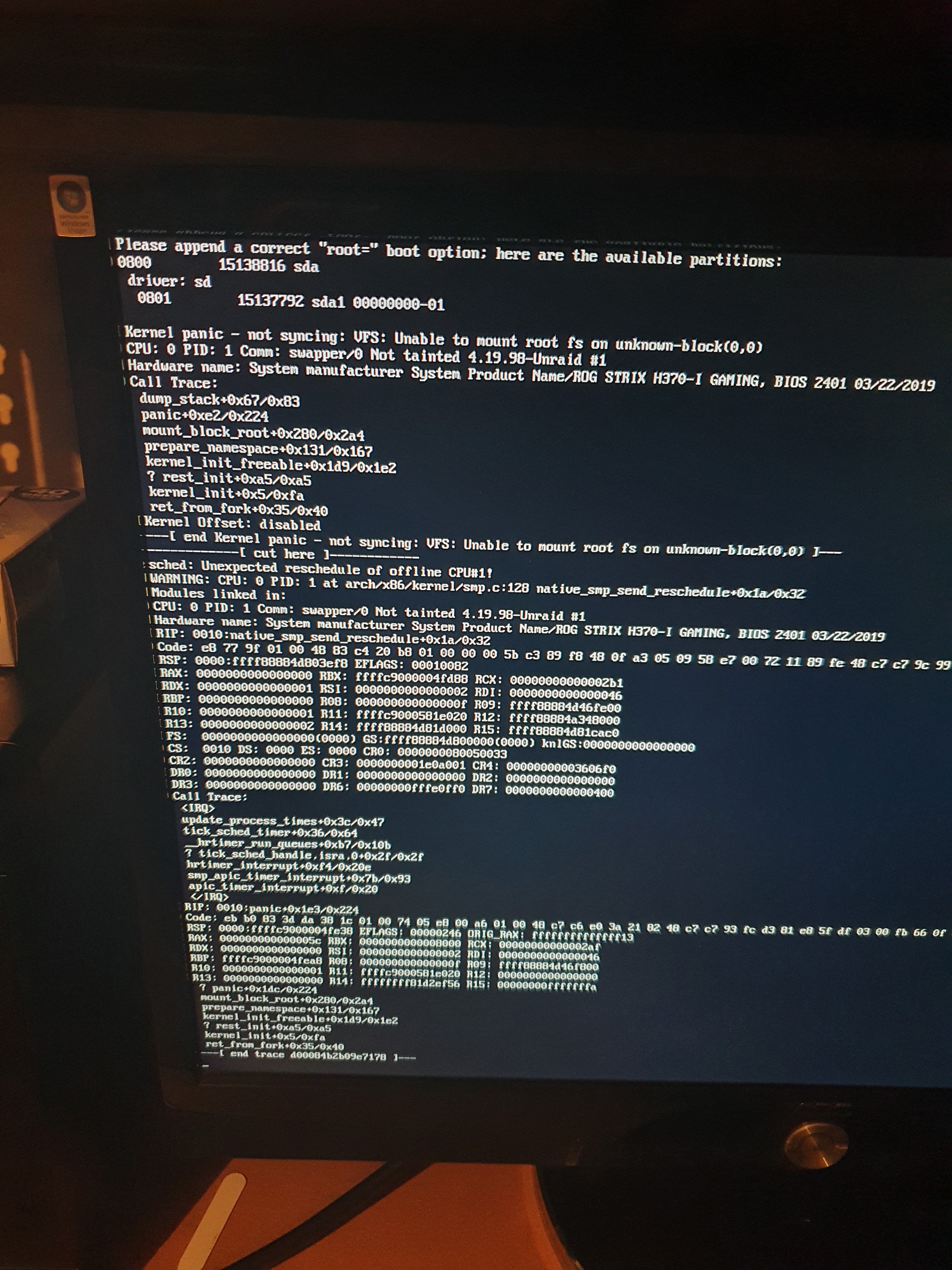

July 18, 20206 yr Hi Team, Can someone help me out here as I am stuck with Kernel Panic and this has become frustrating. This is what my error looks like as attached and below is my syslinux/syslinux.cfg config looks like. Surely I have already checked the FAQ section yet this is as bad and I can't boot. Quote default menu.c32 menu title Lime Technology, Inc. prompt 0 timeout 50 label Unraid OS menu default kernel /bzimage append initrd=/bzroot root=sda Tried even writing old backup on a new USB drive yet I am facing the same issue. Unsure what else might be problem. Some BIOS setting I need to be clear: Secure Boot was cleared CSM Support is Disabled () If someone can guide me that be a great help please. Cheers, TD
July 18, 20206 yr Community Expert This is usually a flash drive problem try another one or re-create it manually following this: Backup your flash drive then open a command prompt window as administrator, then type, in this order: -diskpart -list disk -select disk x (x=your flash drive) -clean -create partition primary -format fs=fat32 label=UNRAID quick -active -assign -exit -close cmd window -Unzip Unraid release to flash drive and restore the config folder from the flash backup -execute make_bootable as admin
July 18, 20206 yr Author Thanks for your response, just woke up and did as requested, unfortunately this didn't work for me. Still it's giving the same dreaded error. Doh!! Any other ideas? Something that I am missing here. Even disabled the Fastboot too. Not unix savvy so help is much appreciated.
July 19, 20206 yr Community Expert These errors sometimes happen with some hardware, no one knows exactly why, unfortunately can't suggest anything other than trying different flash drives and/or a different board.
July 19, 20206 yr Hi there, If this issue has been occurring since you originally went to configure Unraid, then it is likely there is something amiss with the hardware or BIOS that is causing these issues. If you had a working setup originally and then one day this started happening, we have to figure out what changed that caused this to start happening. Perhaps try formatting the flash to default settings and see if you can get Unraid to boot there. If so, then you know something is amiss in the configuration of your previous flash.
