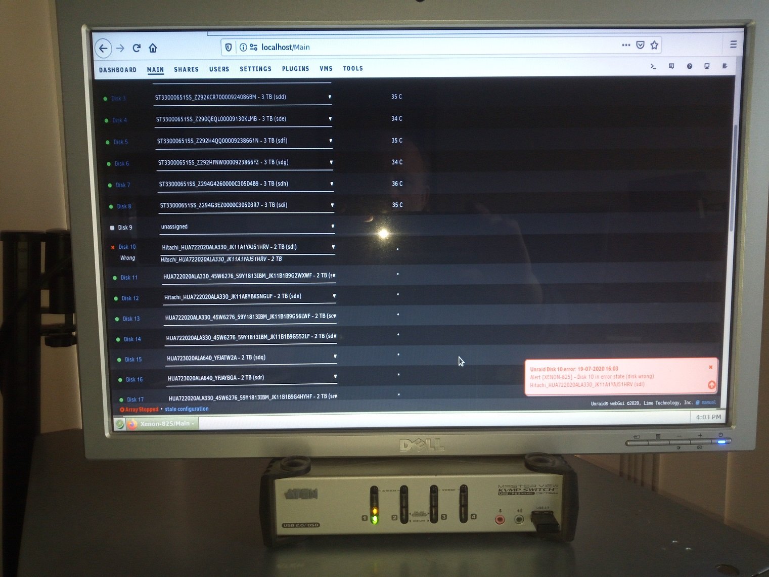

Hi, I have been trying to setup an array using ALL the available slots, with 2 cache & 1 parity drive.
I am using an Adaptec Raid controller, and setting all the disks to JBOD, so that Unraid can "see" them.
After successfully filling all the slots, and starting the array, it's all working fine.
However, after nearly every startup or restart, it has a error (as shown in attached).
If I unassign the "wrong disk", and restart the array, again, everything is fine, UNTIL the next startup or restart, and a different disk has the "disk wrong" fault, and the array has stopped.
So far, I have had 5 different disks have this problem.
It's a mixture of SAS & SATA drives, and it's the SATA's that are having the problem.
I have another "box" almost identical, and so far there has been no issues.
Can someone please guide me to a solution..oh, and resetting the array, (in Tools, new config) does not fix this, and strangely enough, if I re assign the wrong disk, it requires formatting, again.
BTW, running 6.8.2.
Cheers
Would need the diags to confirm but based on the screenshot the disk is likely being detected with a small capacity difference, and if that's the case this would be a controller issue.

So, I have updated the BIOS of the controller card, and I apologize, I'm using an Adaptec ASR-51245, and after several starts & re starts, it has found ALL the hard drives, every time...so that must have been the issue.
