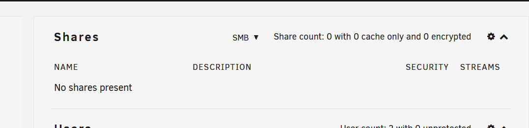

I am currently using the latest unraid next release and I am not sure what happened. After a recent reboot I mentioned that all my shares are missing in Unraid and I am not sure why. Except when I am booting in safe mode. Then the shares are available.
Also docker states that the service is not available as well as the vms.
grafik.png.962616ea8e3bc7b89271692c5a662bd9.pnggrafik.png.b40a09881e8557e4616acffaddb55c46.png
Is this some kind of misconfiguration?

When in safe mode, what's it showing for the appdata folder path?
just the normal path I believe? /mnt/cache/appdata
I've seen that it is not available in the samba shares though. But now the folder flash is available which was not before.

If you still have the situation where booting in Safe Mode works then that means that you must be installing a plugin that is causing your problems.    You could try disabling them all and then re-installing them one at a time to find the culprit.
while running in Safe Mode it can also be a good idea to carry out file system checks on each drive as that can also cause problems if present.
This worked!!
