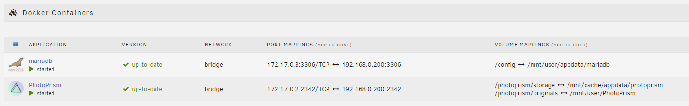

I installed it now and got this when I want to enter PP:
All seems to be fine:
The Log is empty for PP.
Do you have any idea?
I created a database and user on MariaDB for PP and entered the connect string in the settings.
EDIT: I got it. Connection refused. I used localhost in the connect string...
Edited by toasti
