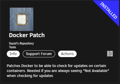

February 24, 20233 yr If you're having trouble with one or two apps that are "not available" then you should install this. I was running Unraid 6.11.5 and I had problems with the MeTube app.
February 26, 20233 yr Thanks, I had another docker image fall victim to this pro On 2/24/2023 at 9:47 AM, TimTheSettler said: If you're having trouble with one or two apps that are "not available" then you should install this. I was running Unraid 6.11.5 and I had problems with the MeTube app. Thanks. I just came here for this. Had another docker image fall victim. Here is the thread on the reason for the patch:
