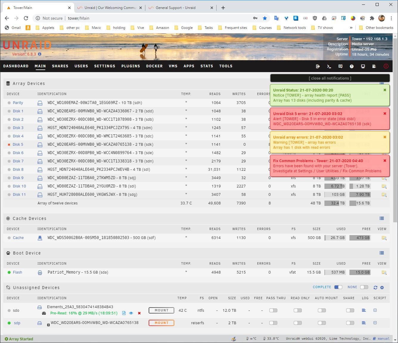

Hello,
This morning my Unraid main page is showing disk5  in an error state but also showing the same disk as unassigned.  I've never seen this before, but I assume that the disk is bad and needs to be replaced.  I had intended to retire this disk, anyway (old 2 TB disk) so this is a good time.  The question is what to do: in the past, when I had a bad disk, I simply replaced it with a new disk of the same size and let Unraid rebuild the array.  I have a new disk that I can put into the array, but it is 8 TB, not 2 TB.  Should I remove the old 2 TB disk and replace it with the new 8 TB?  Will Unraid rebuild the array with that config?  If not, can I just copy (e.g. using rsync) the files from disk5 to another disk which has 2 TB of free space and then remove disk5?
Attached are a screen shot of the main page and the diagnostics logs.

Disk looks fine, most likely an issue with the SASLP, since they are known to drop drives without a reason, could also be a cable/connection issue.
Ok, thanks.  So I re-seated the connectors and re-booted but the disk still shows disabled.  Should I run a parity check to rebuild or what?

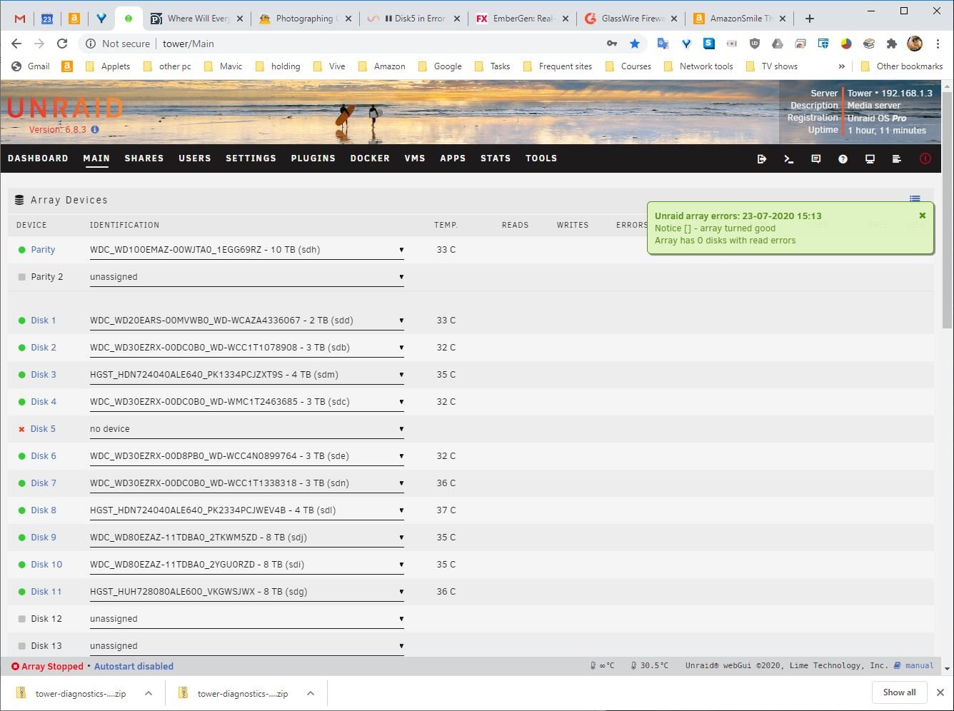

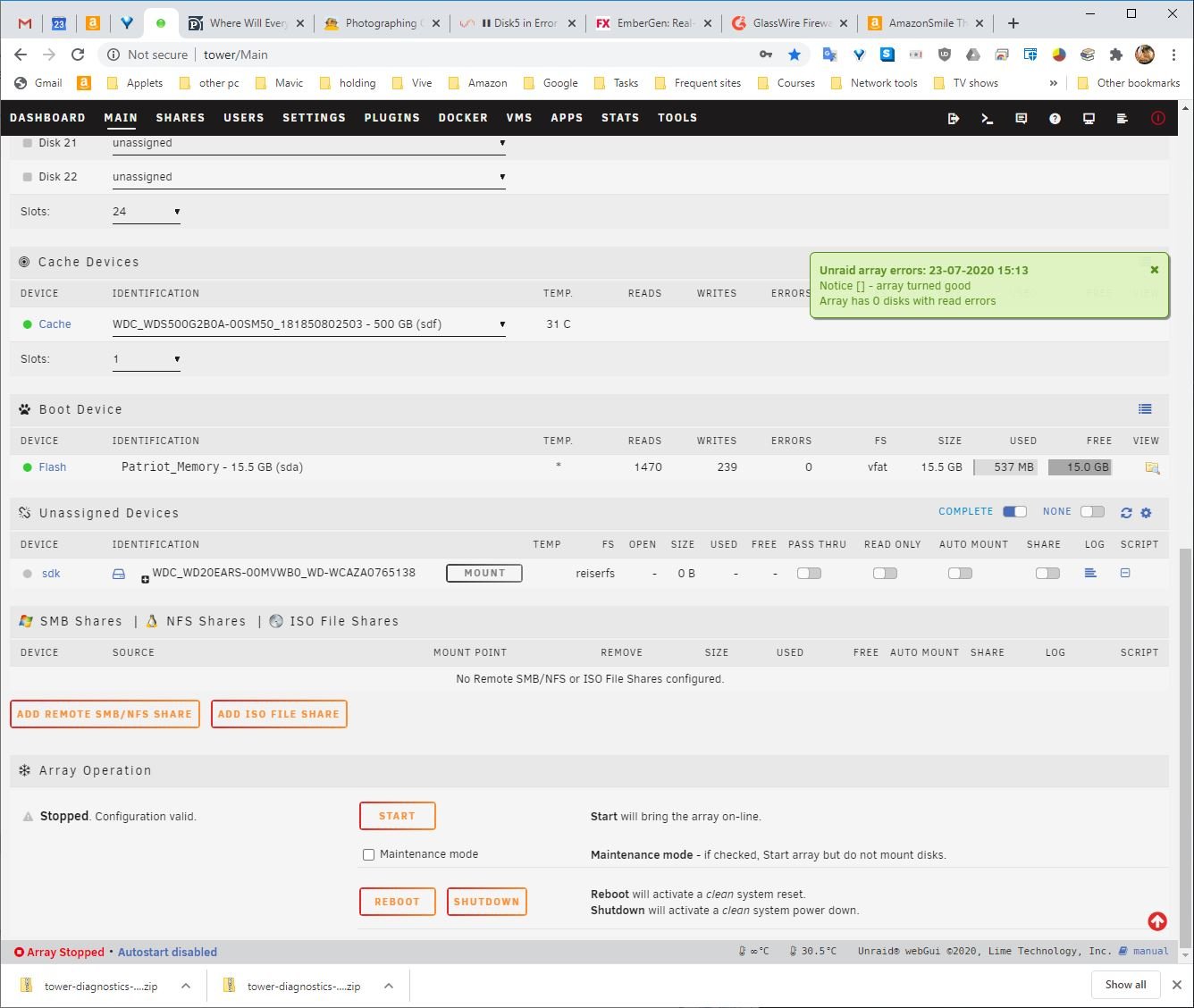

This morning, the array is again reporting that disk5 is in an error state.  I decided to simply reboot and see if the HBA would work long enough to do a SMART test on the drive.  If I was sure it was OK, I would simply copy the (reconstructed) data to another disk and remove disk5.
So I reboot and now I get the weirdness where the Main page shows disk5 with the red x and also showing it in the unassigned disks area. BUT, disk5 is NOT showing in the drop down so I can simply re-assign back to disk5.  To further complicate things, there is a green dialog box showing
"Notice{} - array turned good"!!!!
This is clearly not true.
Anyway, what to do now?
1) Start the array and hope that it has not forgotten that disk5 existed.  I could still copy the data (reconstructed from the other disks and parity) to free space on another disk.
2) start the array in Maintenance Mode and run a SMART test on the disk.  If its good, I could always mount it and copy from there.
3) Other?
Attached are two diagnotics, one after disk5 was put into the error state (write errors to the disk) and the other after I rebooted to reset the HBA in the current state.

Also here is the main web page:
Main1.thumb.jpg.945e795c6fb5c1842a94cd988b41ecbd.jpgMain2.thumb.jpg.559dd7a0fbd37ce2e142dd56f366cf9e.jpg
