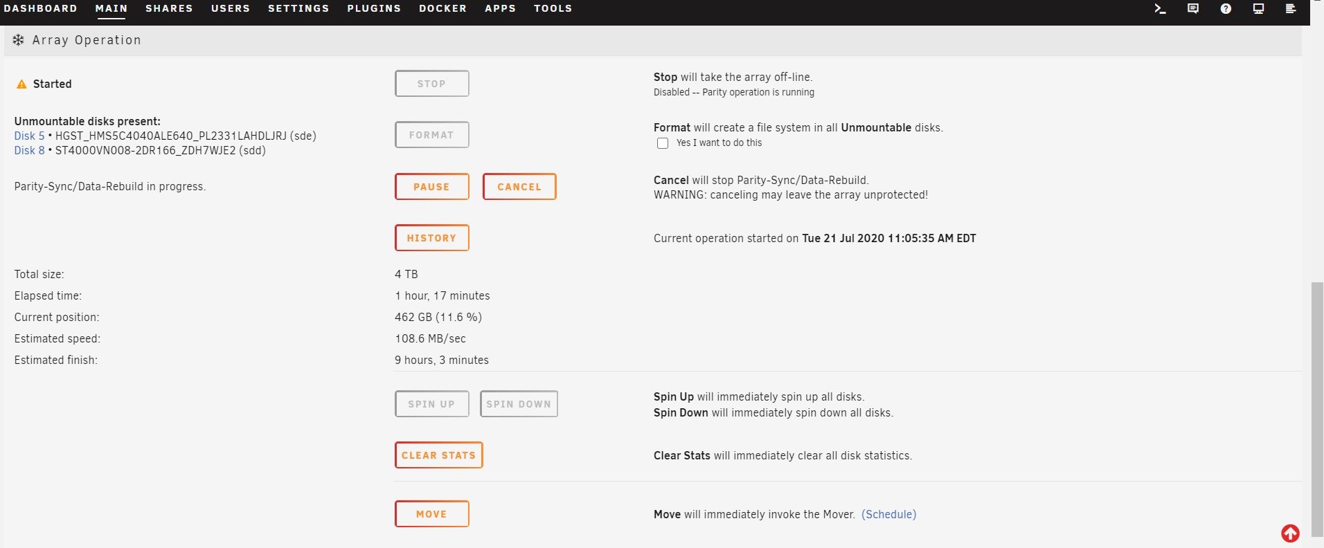

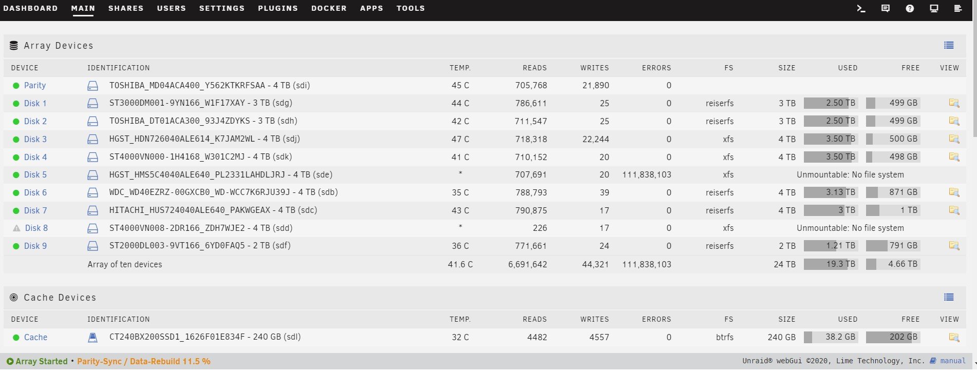

July 21, 20206 yr I just replaced a smaller hard drive with a larger hard drive (Disk 8). When I started the array, I must have missed an error with my server, as it shows two HD's as "unmountable: No file system", both Disk 8 and also Disk 5. I must have missed the error before I stared the array (and selecting the new Disk 8). Unfortunately, Parity-Sync/Data-Rebuild has already started (I believe on Disk 5). I am getting a ton of errors on DIsk 5 which wasn't like that before I shut down and switched out Disk 8. I'm a little confused on what to do next. Should I wait for the Parity-Sync/Data-Rebuild to finish? Or can I cancel the sync now, put the original Disk 8 back in, and then check the wiring on DIsk 5? I don't want to cause any additional problems or lose all my contents of the server. I've attached the syslog from my server and also a screenshot of the main page. Thanks in advance for any help and please let me know if I can clarify anything - I setup unraid years ago and barely touch it except to occasionally add extra storage. Dave syslog.txt
July 21, 20206 yr Community Expert Probably you disturbed connections. Stop,shutdown, check connections, restart, post Diagnostics, Tools - Diagnostics, attach complete ZIP file to your NEXT post.
July 21, 20206 yr Author Thanks - I shutdown the server, checked the connections and restarted. Looks like everything is working correctly now (I think). Parity-Sync/Data-Rebuild is currently in progress on Disk 8. Attached is the diagnostic zip file - thanks again for the help, tower-diagnostics-20200721-2249.zip
