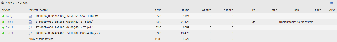

[SOLVED] XFS data disks is "Unmountable: No file system"
As stated in the title, one of my data drives cant be mounted: "Unmountable: No file system". image.thumb.png.b51efa2a71561153c115ffb02b7c7c79.png
The drive worked before. SMART tests (both long and short) complete without issue.

I had some other problems a few days back with my drive being marked as unavailable. Simply restarting the array helped back then. Maybe this is related?
Should i just run xfs_repair (without -n) and hope for the best? As stated here: https://wiki.unraid.net/Check_Disk_Filesystems#Drives_formatted_with_XFS. I just wanted to check before i accidentally destroy the data on that drive.
Any help is incredibly appreciated!
You need to run xfs_repair without -n or nothing will be done, if it asks for it use -L also.
Thank you for the quick reply! I'll run it and post an update here.

I don;t think it did anything special. I'll reboot the system once again (Third times a Charm), maybe that will magically solve my problems...
Never mind.. my impatience got the better of me. Restarting the array out of the maintenance mode showed it working again! thank you for your help!
