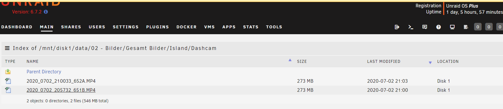

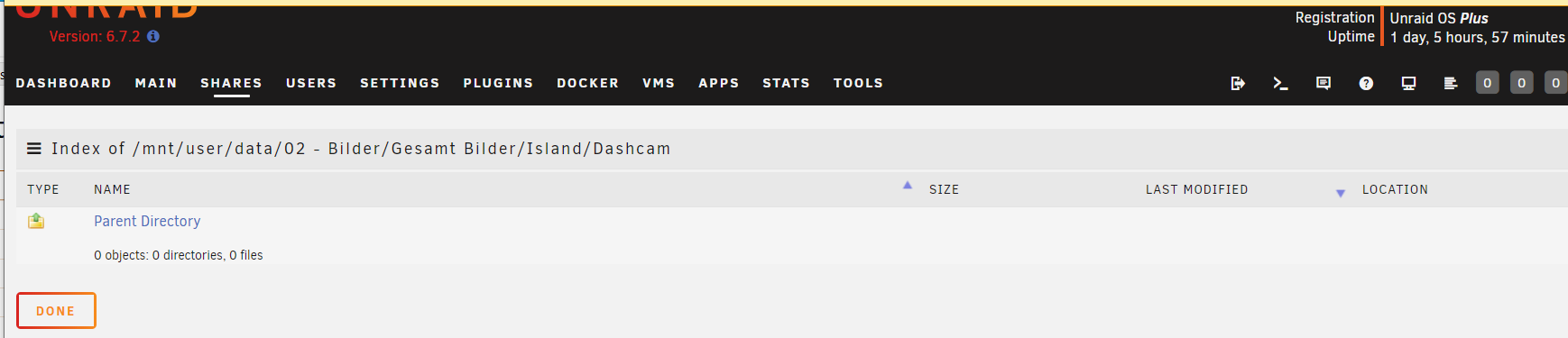

July 22, 20206 yr Author Here a screenshot of the WebUi file browser of the user share - 0 files in the share Here a screenshot of the WebUI file browser when looking at the disk - 2 files on that disk:
