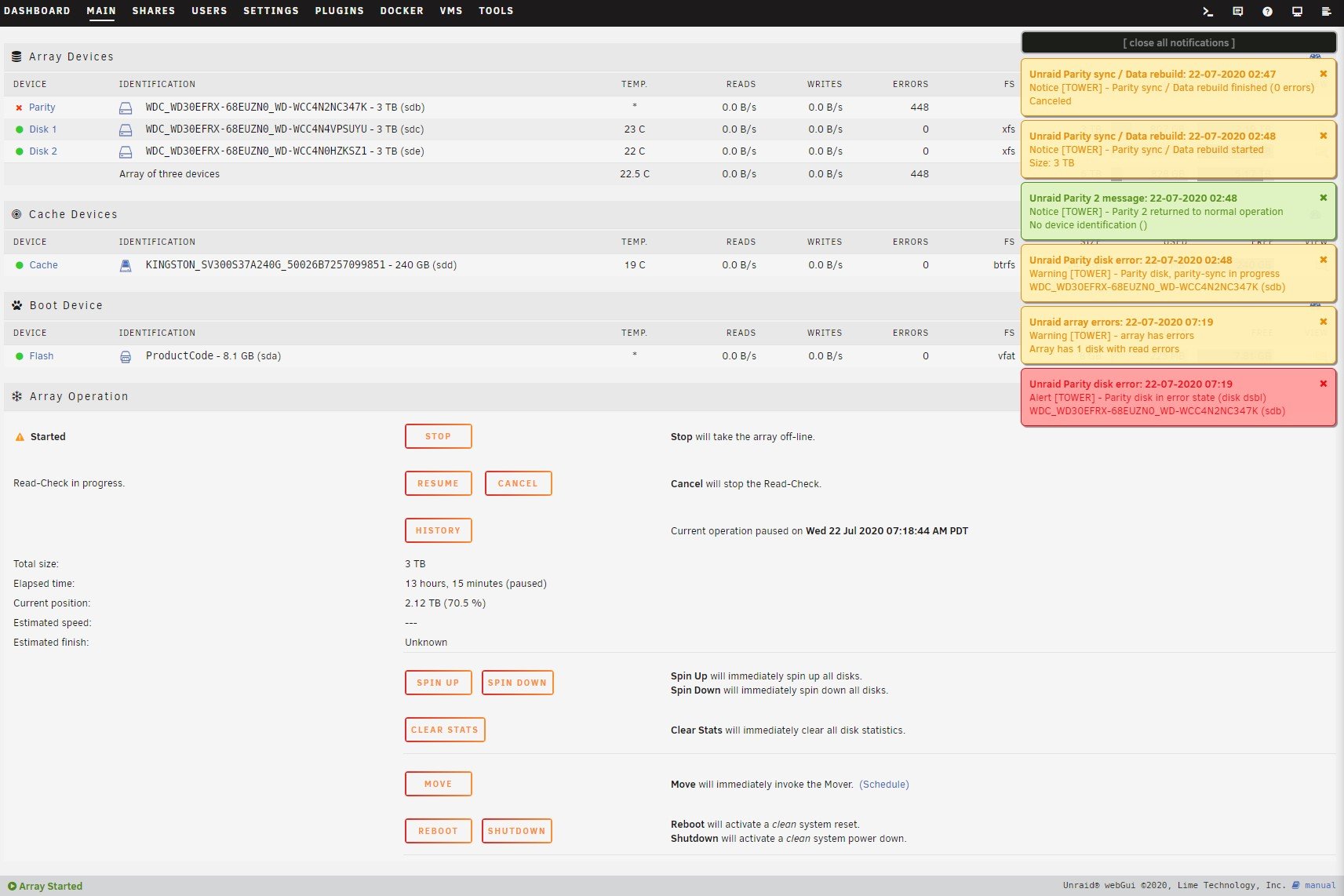

I have recently discovered that my parity disk is in error state
"Unraid Parity disk error: 22-07-2020 07:19
Alert [TOWER] - Parity disk in error state (disk dsbl)
WDC_WD30EFRX-68EUZN0_WD-WCC4N2NC347K (sdb)"

Looks like your parity disk isn't responding. Do you have another disk you can use?
I have bought another one to try. It is now rebuilding.
I will update of progress
8 hours ago, Brettkw said:
Run short self test (does not work)
I assume you mean the test fails?   If so you definitely need to replace the drive.  If a drive fails either the short or the extended SMART tests then the drive needs replacing.
This fixed it thank you.
