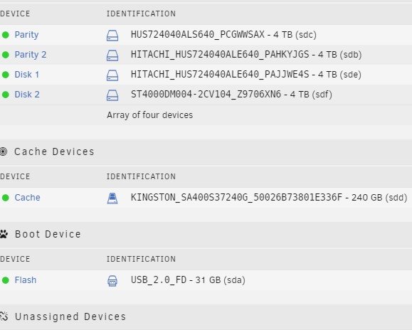

OK, all 4 disks are green 2 parity and 2 storage. Please help me correct my errors that you mentioned earlier.
Chas
