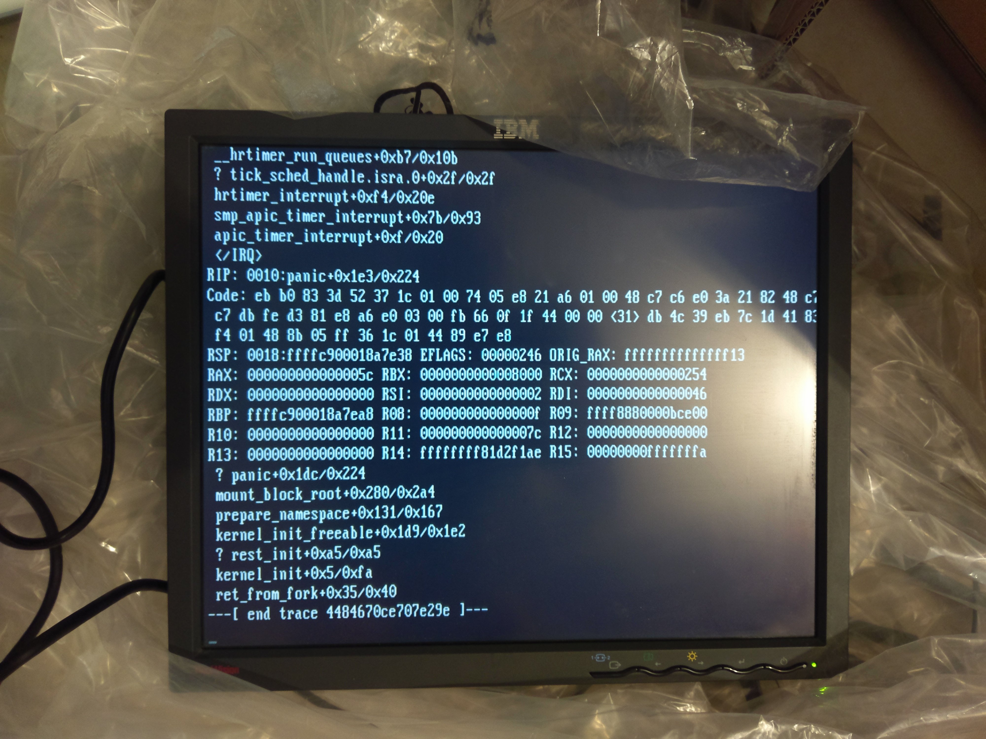

July 23, 20206 yr Hello all. Hoping for some quick help here as I need to gain access to my unifi controller which runs off my unraid server... Everything has been running fine, since yesterday I am no longer able to boot the server. I connected a monitor and took a picture of the output. No I don't get to a command prompt. I have done a chkdsk and windows states there are no issues. I have a backup from a few months ago when I did the update to Unraid v6.8.3. Thanks for the support.
July 23, 20206 yr Author 1 minute ago, johnnie.black said: Try recreating the flash drive. Thanks for the mega quick reply. I downloaded a fresh 6.8.3 release. Copied across the bzroot and bzimage files. Will this suffice? How can this issue crop up all of a sudden? Cheers!
July 23, 20206 yr Community Expert 16 minutes ago, johnieutah said: Will this suffice? It might, if it doesn't backup current flash, recreate it from scratch and restore the config folder from the backup.
July 23, 20206 yr Author The server is booting now. I wonder why that happened all of a sudden. I only use the server a few times a week but it's never left turned on. I rarely do updates unless critical. Strange
