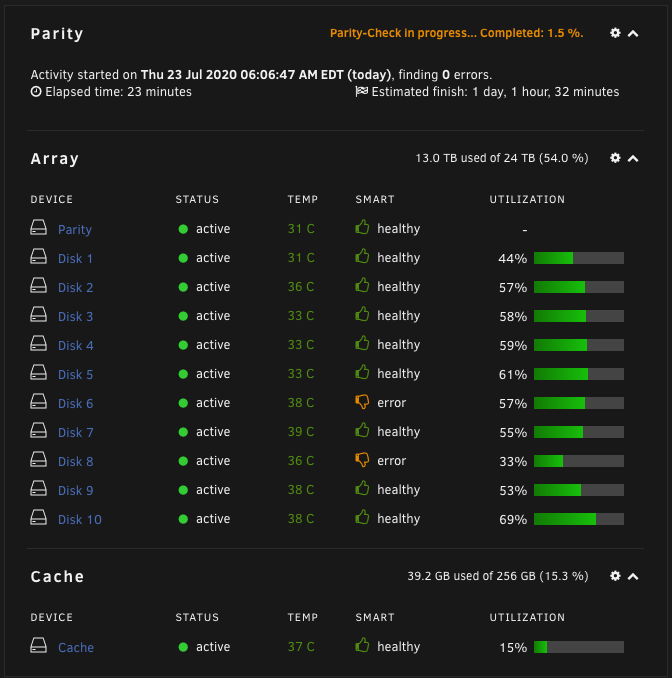

My system seams to be running perfectly.  I have 2 drives in my array that has thumbs down which I think is causing my parity check to keep running even thou it is set to 1 month.  I am not sure if it is the cause or contributes to the cause BUT the BIG question...   My system will seam to become un-accessible. System is still running BUT no access: WebUI, Plex goes down, I can not bing the IP.  When it's up everything is running like a swiss watch.  I've attached the logs, but I am a NEWBIE and don't even know what I am looking at when I review them.
