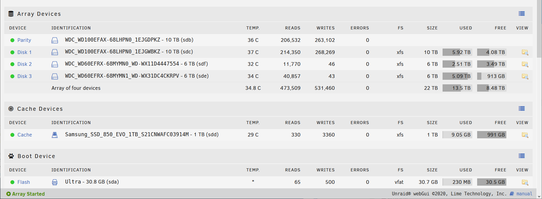

New RAID Card, New cables and the Drive mounts and then after a few minutes drops from the server with this error.

Now I do know that the drive had one remapped sector, but the rest of the drive is healthy, I have run extensive drive testing using Victoria hdd, and nothing else is popping up, on windows at least. The drive is 5yrs old but still has 70-80% of its write span left.
After formatting it again, i have not be able to get it to though the
Aug 8 18:50:24 HomeMedia kernel: XFS (sdd1): Metadata corruption detected at xfs_buf_ioend+0x4c/0x95 [xfs], xfs_inode block 0x80 xfs_inode_buf_verify Aug 8 18:50:24 HomeMedia kernel: XFS (sdd1): Unmount and run xfs_repair
Still this is highly sketchy and I should just replace the drive and be done with it.
