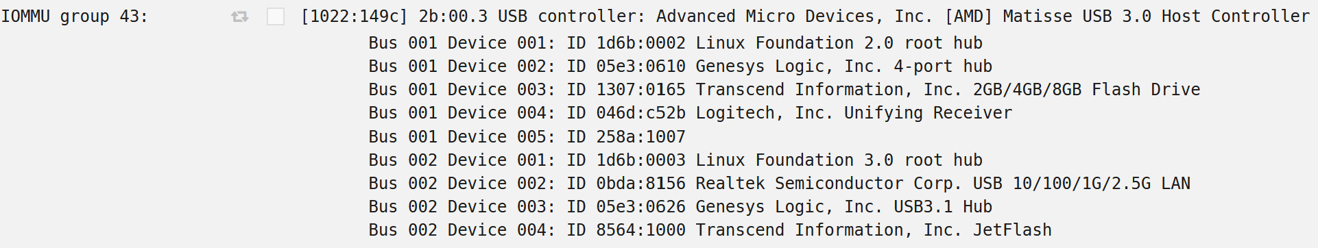

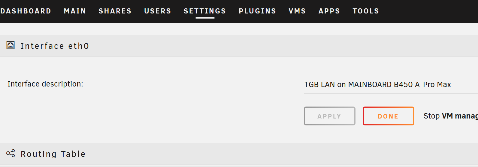

October 11, 20205 yr here are my diagostics. - USB-NIC is regognized in TOOLS - SYSTEM DEVICES - USB-NIC is not available in SETTINGS - NETWORK SETTINGS (the only NIC listed is the Onboard-NIC) ryzen3700x-diagnostics-20201011-1748.zip
October 12, 20205 yr Driver is crashing while initializing the device: Oct 11 17:45:47 Ryzen3700X kernel: r8152 2-1:1.0 (unnamed net_device) (uninitialized): netif_napi_add() called with weight 256 Oct 11 17:45:47 Ryzen3700X kernel: ------------[ cut here ]------------ ... Oct 11 17:45:47 Ryzen3700X kernel: r8152 2-1:1.0: couldn't register the device Oct 11 17:45:47 Ryzen3700X kernel: r8152: probe of 2-1:1.0 failed with error -22 Likely a driver issue, assuming the NIC works correctly for example in a Windows machine.
